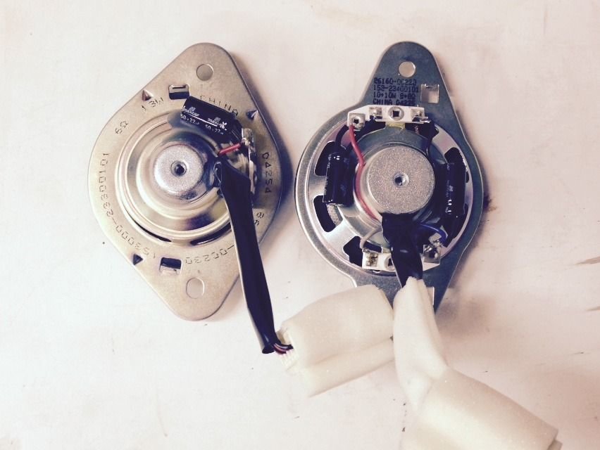

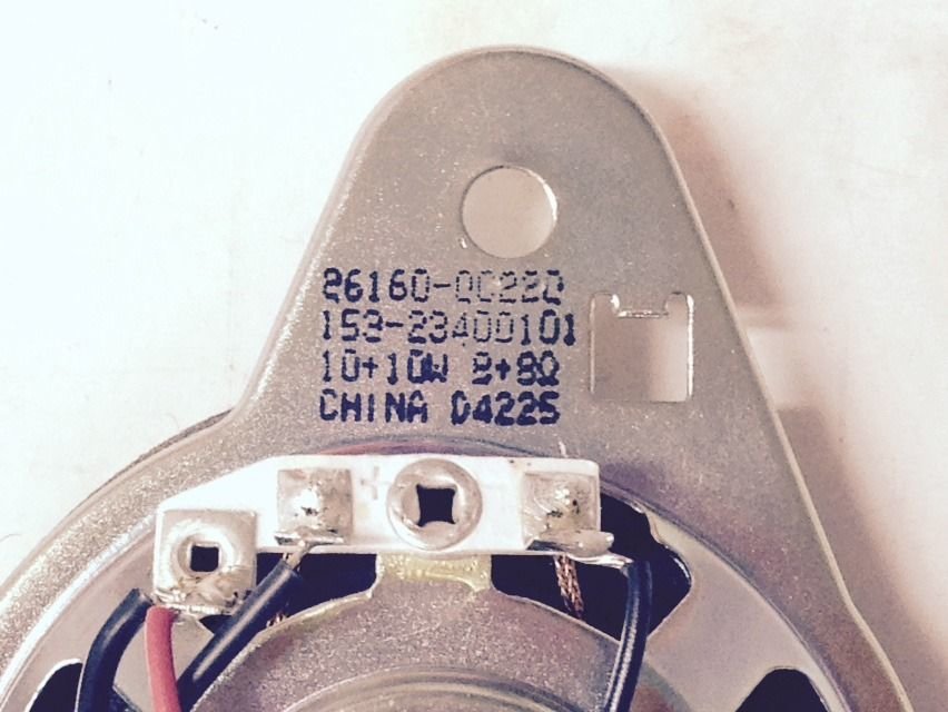

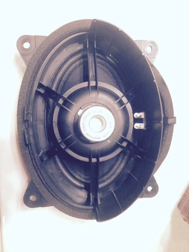

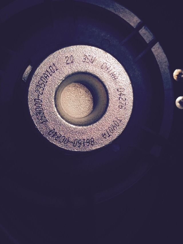

    Keep in mind the OEM door speakers are 2 ohms to pair up the crappy OEM amp.
    Also the dash speakers are powered by the HU to run as tweeters and the front doors only get a low and mid signal from the factory amp.
    You won't get any high-end in the doors just by replacing the speakers.
    Dash speaker a 6 ohm sides and an 8 ohm DVC center.

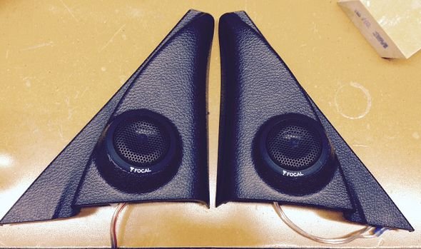

    You could always purchase JBL door sails, run the tweeter wire, and use these..

    Does anybody have a pic of the back of the head unit or the head unit specs ?
    Thanks for posting the speaker specs. This is going to be nearly impossible to just replace the speakers.

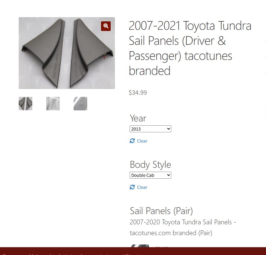

    Optional Sail Panels $50: JBL Sail panels, about $25 per side.

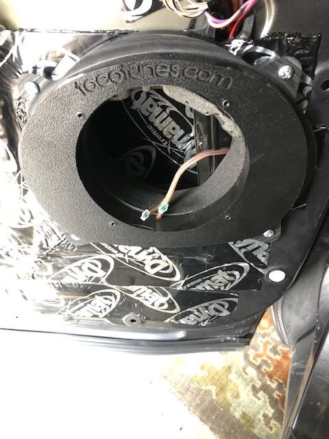

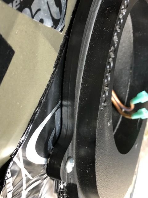

    Great post

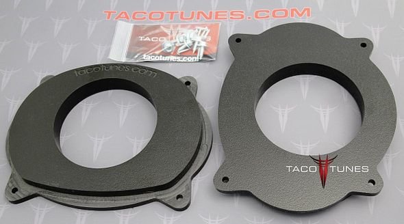

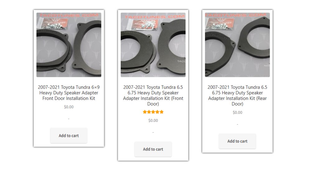

    Due to several past customer service issues from TTunes, links to their website can't be posted here.
    You'll see your links for their stuff go nowhere..
    I will say they do make great speaker adapters/spacers though.. :thumbsup:

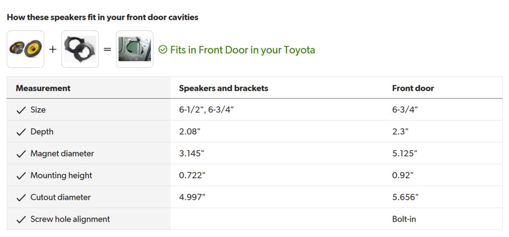

    The JL C1's should be a great option. Not crazy to want to have all your speakers match. I believe both the front and rear doors should have no problem fitting the C1-650X's, not sure why Crutchfield says they won't fit. The front doors are an oval opening, whereas the rear doors are round. For the front doors, Crutchfield lists these specs:

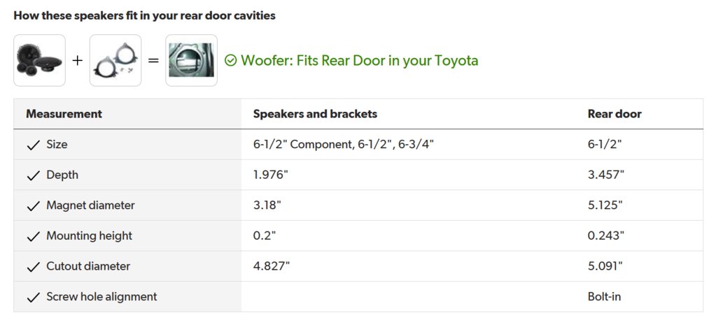

    And for the rear doors these specs:
    Ignore the speakers I picked for the rear doors, just looking at the depth, magnet diameter etc. The only thing I see that doesn't work is the mounting height which I'm guessing is due to the tweeter in the middle of the speaker. How close are your rear speakers right now to the speaker grill on the door in the rear? That's the only thing that seems to be the hold up and I honestly doubt it's actually an issue.
    As far as speaker rings go, in my personal opinion the "heavy duty" ABS ones are worth it, but if you're looking to save ~$150 the ones Crutchfield includes would work just fine. Whether doing the heavy duty speaker rings or not, 2 other things I'd highly recommend are foam speaker rings, and some budget sound dampening.
    https://www.crutchfield.com/p_239SSKRING/SoundSkins-Rings-v3.html ~$52 These are closed cell foam and attach to the front of your new speakers creating a gasket that channels the speakers sound/output into your trucks cabin. They have little pads that attach inside the door as well to help with back waves.
    https://www.sonicelectronix.com/item-133807-NVX-SDBDK12-Premium-Stealth-Black.html ~$35 This is budget sound deadener that's scored fairly decent in testing. 4 12"x36" sheets would be plenty to install around your speaker openings to reduce resonant frequency and make your speakers perform better.
    If you were to skip the heavy duty speaker adapters, you can use some of the sound deadener to beef up the speaker adapters crutchfield includes. Money no object I would do all three things, but on a budget I'd probably say the foam speaker rings would make the biggest difference, followed by the sound deadener. You'll notice that on the factory speakers there's some foam around the speakers to seal them to the door/channel the sound into the cabin better, hence my suggestion of recreating that with the foam speaker rings.

    The issue is that the factory amps in most our trucks do roughly 35 watts at 20 ohms, using ohms law, that means about 20 watts at 4 ohms, and 90% of aftermarket speakers are 4 ohms and start at about 40 watts rms, meaning if you keep the factory amp, your speakers will be underpowered by half, making them quiet and also risking damaging them since under powering speakers can be harmful just like majorly overpowering. Likewise, if you replace the factory amp and keep the factory speakers, an aftermarket amp is going to overpower the factory speakers and risk blowing them. Most aftermarket 4 channel amps start at about 50 watts at 4 ohms, which means they usually do a little more than that at 2 ohms, say ~70 watts, double the 35w power handling of the factory speakers. That said, factory speakers are also shaped/optimized to fit/seal in the door openings well. Often times people will replace their factory speakers with better speakers, but lose mid-bass due to the new speakers not being optimized etc., hence the recommendations of minor sound deadening, foam speaker rings etc. Most amps nowadays accept high level or speaker level inputs so a line output converter isn’t necessary unless you’re buying it solely for the accubass feature, but with an aftermarket head unit its entirely unnecessary. I don’t think the factory systems are complete garbage, but if someone’s going to go through the effort of removing their door panels and installing new speakers, it’s good to know the factors at play and extra install bits to maximize your results.

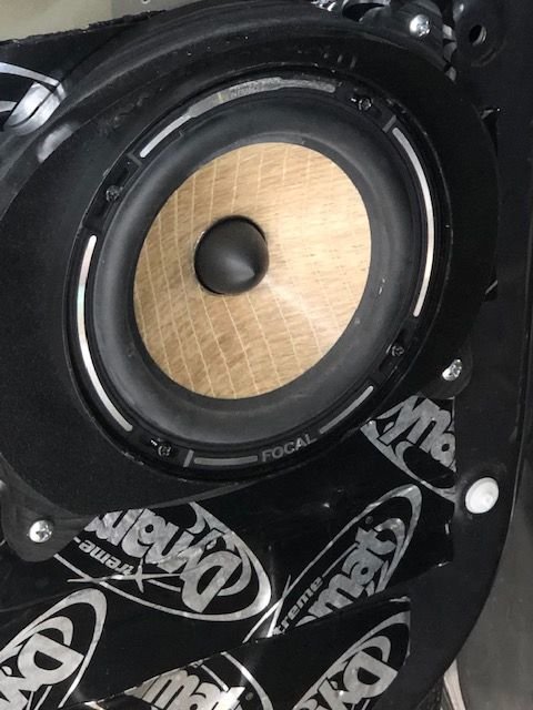

    TT makes some great speaker adapters..
    6bac75b4-c2ad-44d1-b77e-f2e11f83c91e_cd43a9a4f11af147f5e55952141276e7768e6882.jpgc8f3f776-1853-4d63-b8d8-bd3fcbfe61e7_9a889c907da3667b91d0f53ff142d40afecc7aba.jpg

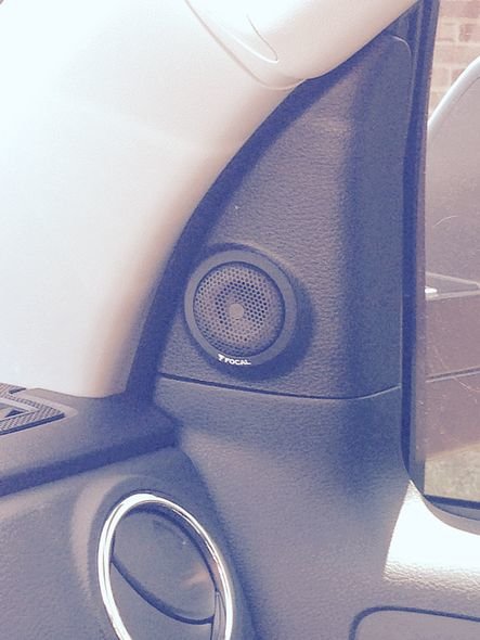

    @OldGuy03 I agree with @Snert on using a component set on the front doors.
    I used OEM and cut them to fit my Focal tweeters.
    In the end I disconnected all 3 dash speakers in my 2014.
    A decent set of 2-way components will give you a nice front sound stage..
    TT also makes some door sails that are much cheaper than OEM.
    I can't post a link because of past issues members had with TT.
    $35 a pair beats OEM @ $50 each.

    I doubt you want to spend what I did, but the Focals I have are phenomenal.
    I had no plans to spend $550 (price back then) on them when I bought mine but they sounded so good at Cartoys.
    Focal PS 165 FXE Performance Series 6-1/2" bi-amplified component speaker system at Crutchfield
    Focal makes a plug and play front door component speaker for your Tundra.
    No speaker adapters needed.
    Focal Inside IS TOY 690 6"x9" component speaker system designed for select Toyota, Lexus, and Subaru vehicles at Crutchfield
    OldGuy03[QUOTED] likes this.
