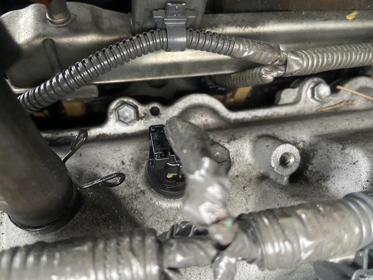

    Don’t know about the ECU yet. I’m pretty positive it had a SC at one point. Keith @dirtydeeds thinks so as wel.
    here’s the codes and a picture of the injector colors. IDK what the stock injector colors should be.
    there is a TRD intake box on the vehicle,and a supercharger belt diagram with smog sticker underneath the hood
    no supercharger though
    P0300 random multiple misfires
    P0301- cylinder 1 misfire
    P0302- cylinder 2 misfire
    P0304-cylinder 4 misfire
    P0306- cylinder 6 misfire
    P0308- cylinder 8 misfire
    P0171-system too lean Bank 1
    P0174-system too lean bank 2
  9. Feb 9, 2023 at 5:42 PM
    Silver17
    Oct 3, 2021
    #68847
    3,670
    Eastern PA
    2017 TRD 4x4 Harrop SC
    Do you have a pic of the intake box, does it have the little popper indicator coming off the top or is it the regular black and red TRD box? I’d also see what plugs are installed and how they look. I’ve seen stock, as well as aftermarket injectors including 650 and 750cc be that brown color so that color doesn't mean too much unless they were the green TRD ones.
