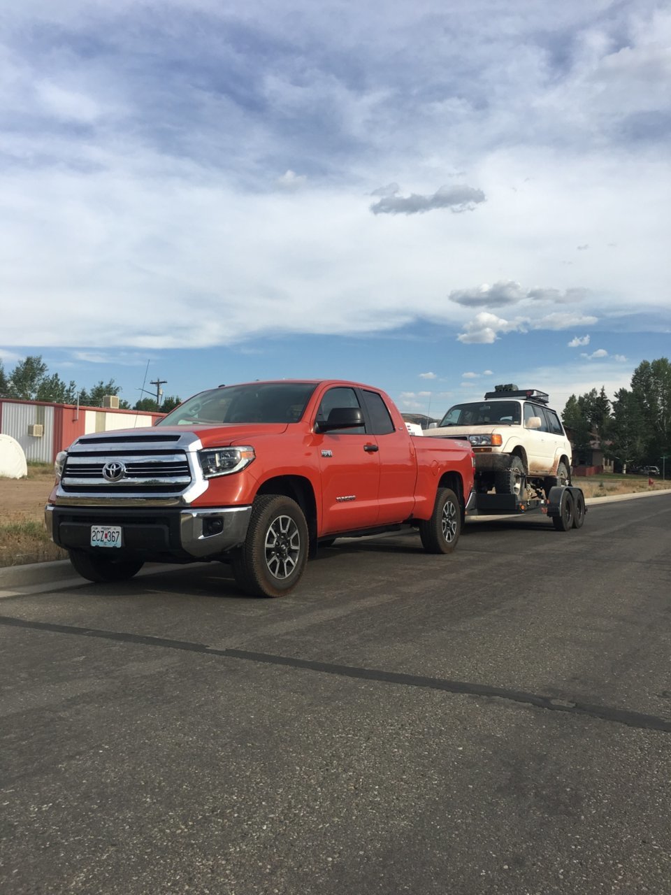

    Wanting just a bit less squat when towing my auto trailer around. Decided on the -47 1500-lb rated SumoSprings after much research. Felt the 2,800's would be too stiff (TWSS). They'll be here tomorrow. I will post some after pics this weekend hopefully. Planning some long trips out west from Missouri this summer with the old Land Cruiser. This is my first Tundra but my brother is on his 3rd so I'm very familiar with them. Looking forward to towing with it. Still need to fine tune the positioning on the trailer a bit for the tongue weight I'm looking for. It doesn't squat quite as bad with the lighter '72 GMC on it.
    https://www.supersprings.com/shop/ssr-610-47/
    BEFORE PICS

    Very easy installation. Most should be able to do in 30-60 minutes working at a relaxed pace. I did not not realize the SumoSprings screwed into the base. Makes sense, however, so you can easily swap them out for a lighter or stiffer pair or if you damage one.

    Well gang, I have to be honest. I took these off and went with the tried and true Firestone Ride-Rite airbags. Free returns to Amazon so no big deal there. I just wasn't completely happy with the squat. I suppose I could have gone with the 2800# SumoSprings. In all fairness, I pull my Land Cruiser pretty far up on my car trailer since it's only a 14' trailer. Installing the airbags over the holiday and will report back.

    Got the bags in. Installation was fairly straight forward if you are mechanically-inclined. Would certainly be easier on a lift. I opted to keep the wheels on and did not jack the truck up. One thing to watch for is to make sure the bracket sits correctly on the axle before you tighten everything up. I've read about a few folks with that issue. I pumped them up to 50psi to check for leaks and they held steady for several hours. Aired them down to single digits and the ride is fine. I can't tell any difference. With 50 psi driving around, the rear was jacked up probably 4". It looked hilarious.

    0-to-40 psi with cheap 12v compressor running from the cab.

    All level at 40 psi.

    The Firestone Ride-Rite bags ended up being the superior choice for my needs on our 2,500-trip we just got back from. Ultimately, 30-psi was the sweet spot towing my car trailer. 7000-lb trailer and I had a 900-lb hitch weight. I ran by the local truck stop and used their scales empty and loaded and then did the math. $11.50 isn't bad if you want to get your balance correct.
