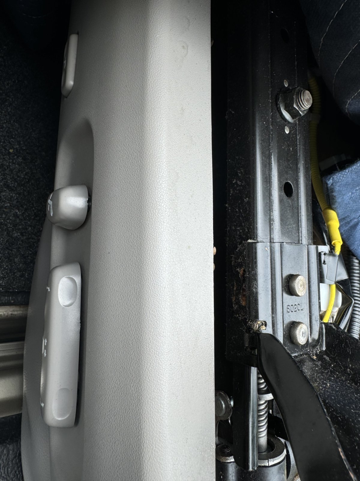

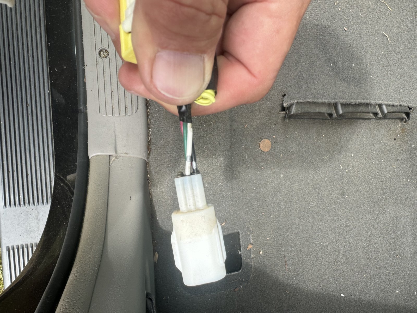

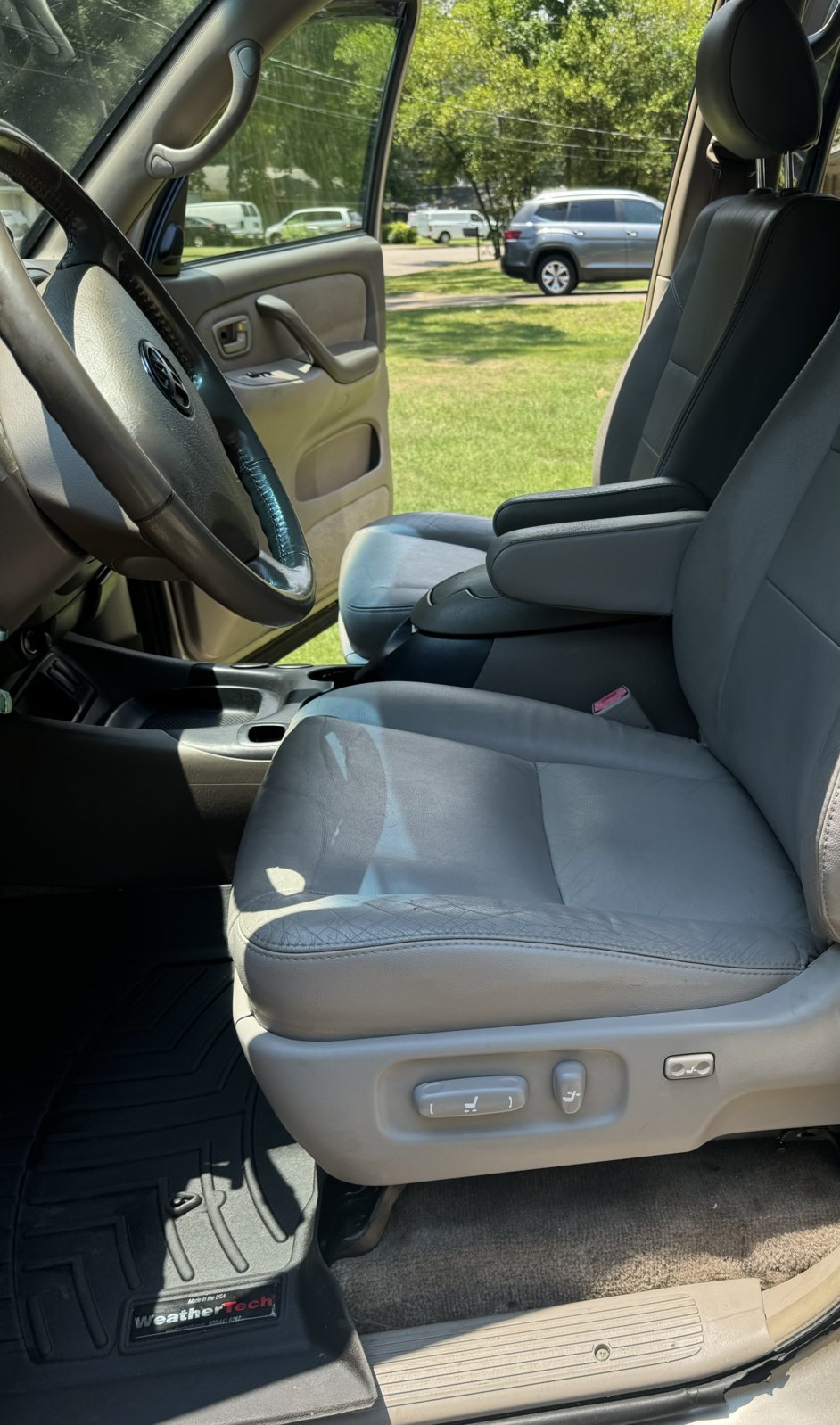

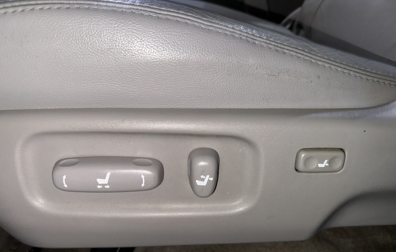

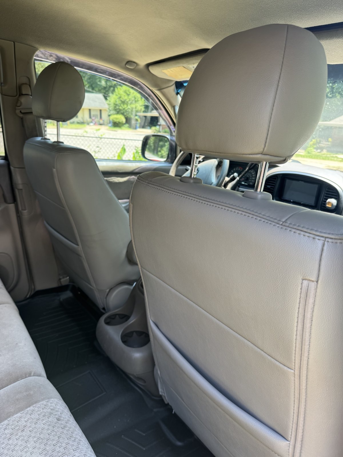

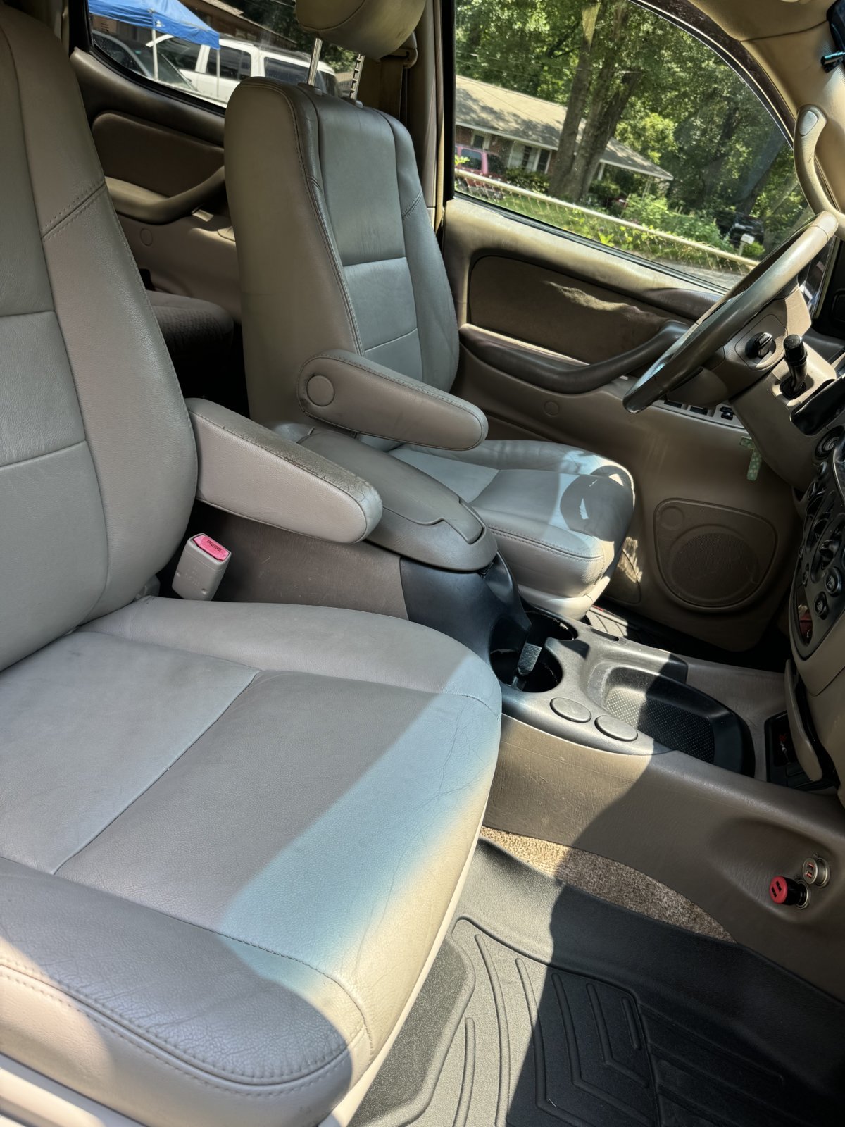

    Picked up some leather seats in decent condition from a junkyard today. Just recently found out there is a junkyard about an hour away that only deals in Toyota trucks and SUVs. How did I not know?
    We tested the power seats before they were removed from the Sequoia. They are not heated and I don't believe they had the seat memory buttons, but I totally forgot to look

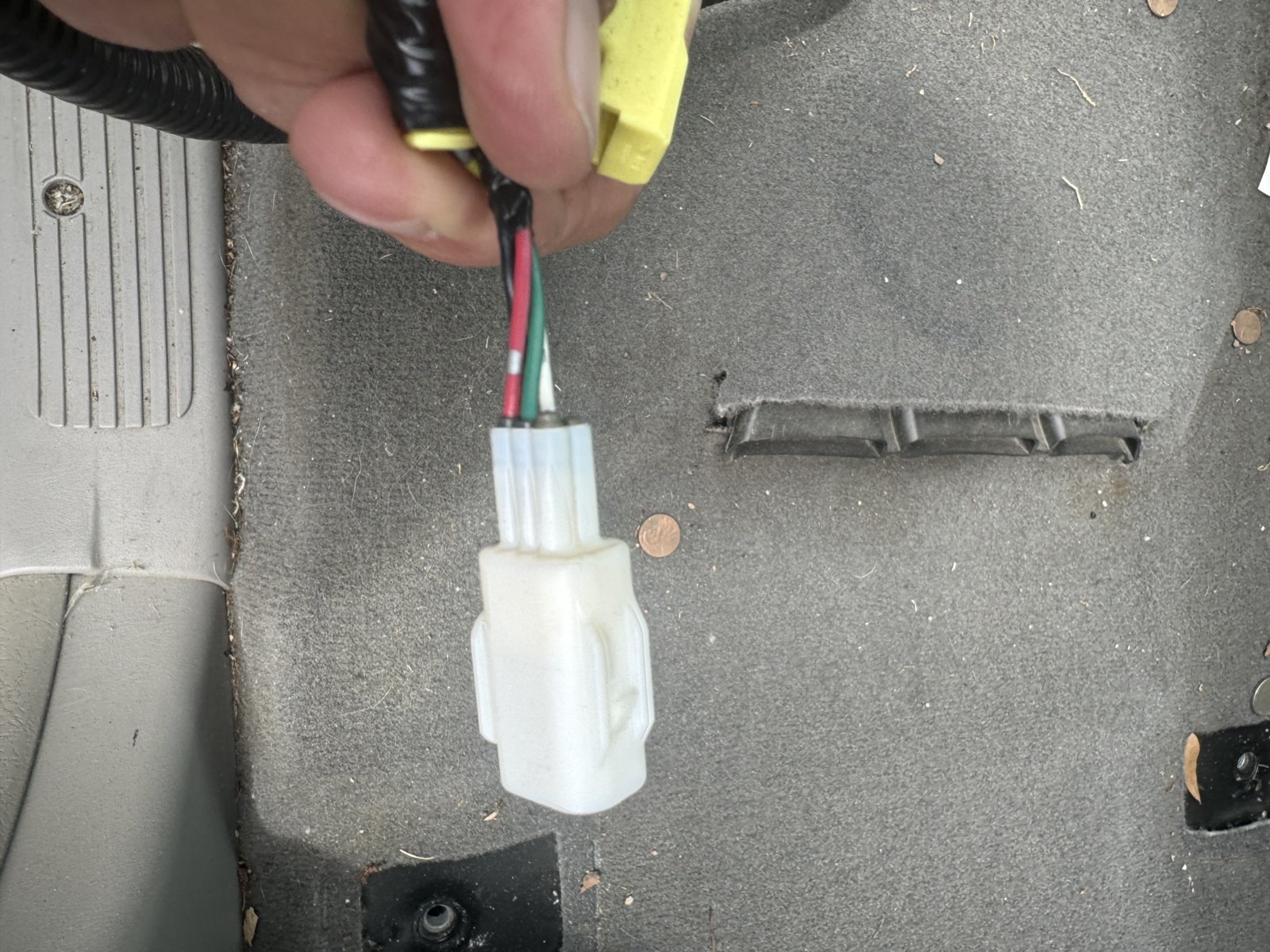

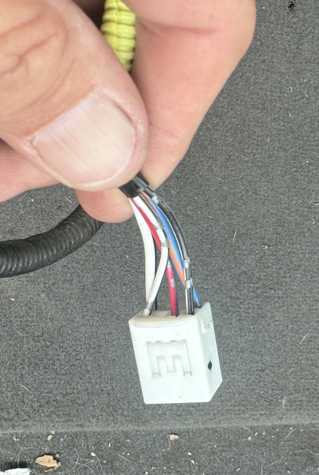

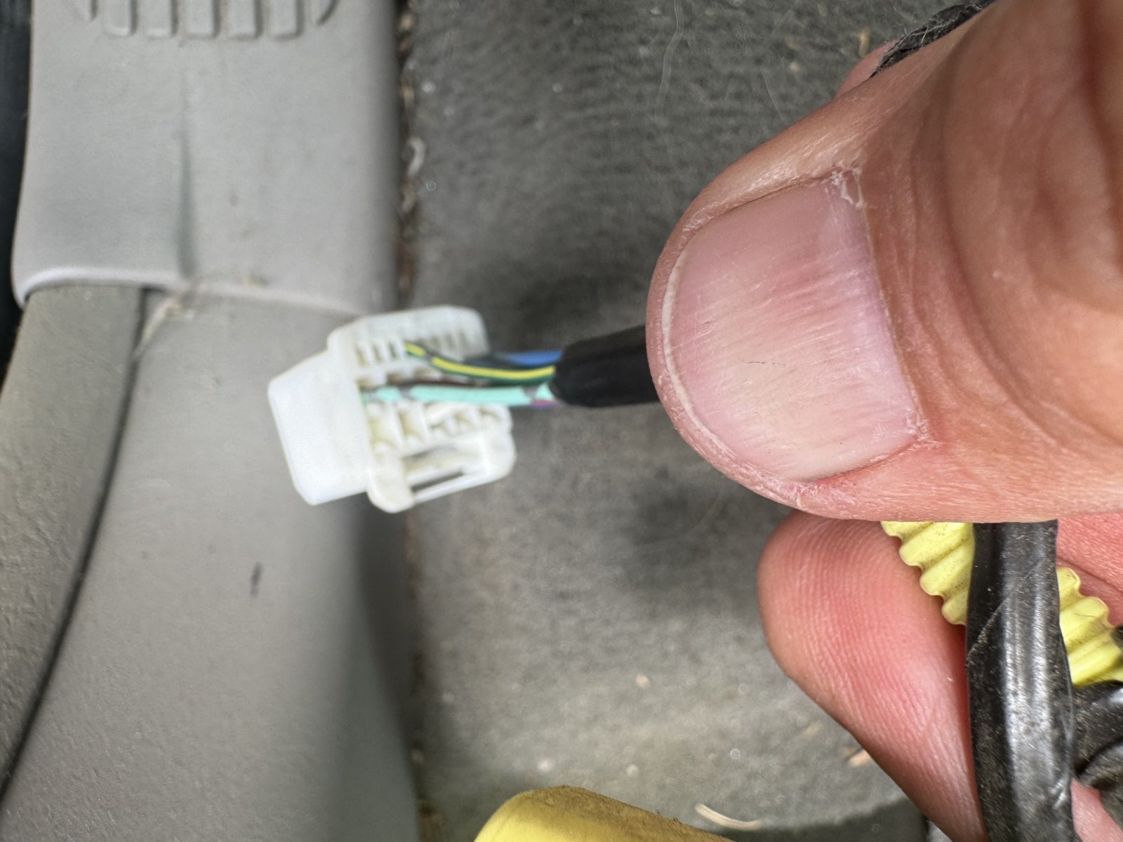

    Once home, I plugged up the new seat to the two connectors, but no power. The seatbelt and airbag sensors worked and the Tundra seatbelt connected to the receiver on the Sequoia seat perfectly.
    Before I dig too deep into wiring diagrams that are totally Greek to me I took a look at the wiring under the manual and power seats
    there are only two connectors for my truck - I hope it's safe to assume one is for the seatbelt and one is the pressure sensor for the airbag. The sequoia seat has an additional yellow connector that is for the side airbag which is not used in my truck
    One of the connectors is a larger white one that has two wires. Same on both seats.

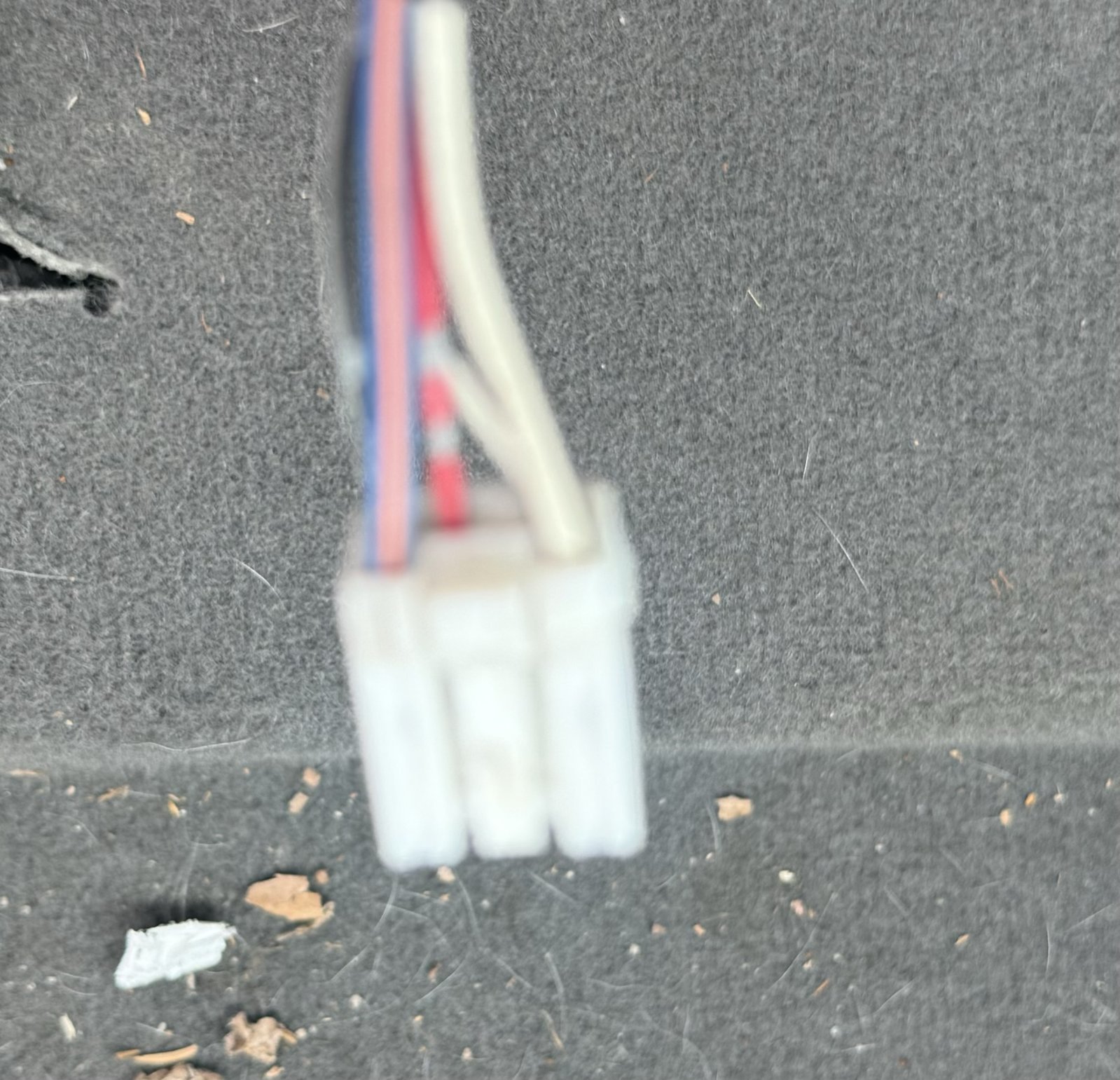

    The other connector can have up to six pins/wires. On my manual tundra in the old seat it has four wires on that connector. Not quite sure why it needs four wires. The power seat on the Sequoia has all six in use
    Is it possible that the only thing missing is a power and a ground, which is the two extra wires in the sequoia seat connector?
    it appears those wires are all fed to a controller in the middle of the seat which then goes to each of the power seat control switches, motors, etc. So I could certainly see how all the motors could possibly share the same power wire from the fusebox, power, and ground wires
    TL;DR? The seatbelt sensor and airbag pressure sensor work fine. But no reaction from any of the motors. There are only two additional wires on the Sequoia power seat.
    Could those 2 extra wires be the power and ground for all of the motors?

    IIRC, that's bullshit. I'm pretty sure the seat harness tees off under the center dash, or at the center console.
    You need to get the EWD for the year of truck the seats came out of to look up the pinout, you're looking for a 6-pin connector with V (for Violet? or L for Lilac? I forget), Orange w/red stripe, green w/white stripe, and red?
    Then get the EWD for your '06 Tundra and look at the pinout for its power seat. Then cross-reference the two for wires/positions.
    You may also just be able to figure out what the inputs are for the '06 Sequoia EWD, and replicate the needs.

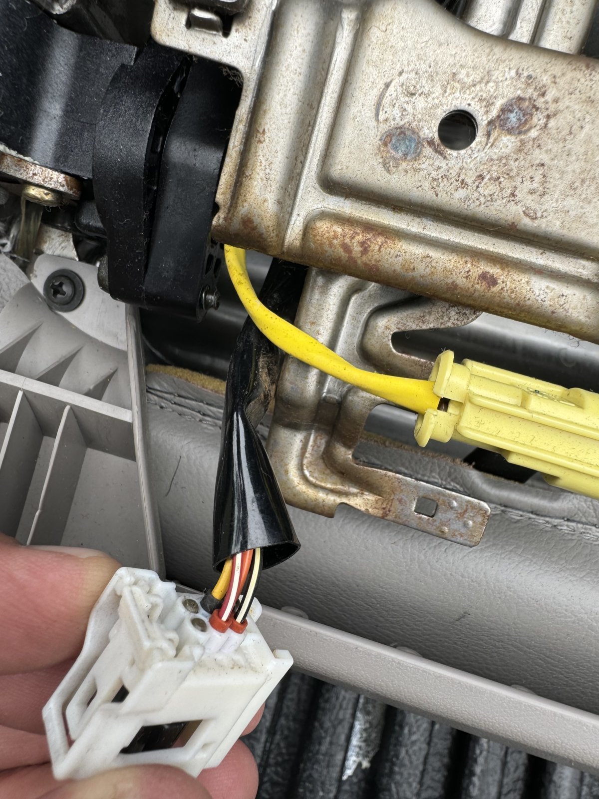

    However, I was wrong last night. Last night, I was looking at the passenger seat since it was easier and the connectors from the drivers side. when I looked back at the driver seat, it was different from the passenger seat. So the same wires/connectors are used on the Sequoia power driver seat as are used in the wiring harness coming from my Tundra. That's good and bad since I have no idea if you could add wires to an existing connector, however seems odd that the wires would have different purposes on these siblings. Maybe the Tundra hot wires are not connected at the fuse box?
    so the same number of wires and pin placements from the truck as are in the connectors, etc to the new seat
    I'm gonna have to go back up the junkyard and get the serial number for the donor Sequoia in case I ever need parts for the seat because Toyota could not even help me for parts without knowing the S/N in order to know which of the handful of versions it is
    that'll give me a chance to look and take pics of the wiring harness on that Sequoia

    If you can get the other end of the harness that plugs into that seat, it may be advantageous. Maybe you can re-pin your OEM.
    I'm also curious if the Seqoia uses a separate harness for the SRS stuff? Airbag harnesses are usually yellow ?!
    I thought adding fogs and adding power seats required adding a relay up under the hood, but maybe that's only the fogs. Memory is fuzzy. I know one member used an eBay relay for heater stuff, and their seats were staying hot all the time. Bad relay, cheap crap. But really, I would only expect the power seat to have a shared ground, a wire for forward/backward, and a wire for up/down, and maybe one for tilt?

    Yes, the airbag in the Sequoia has a separate yellow wiring harness. So I dont have to touch that

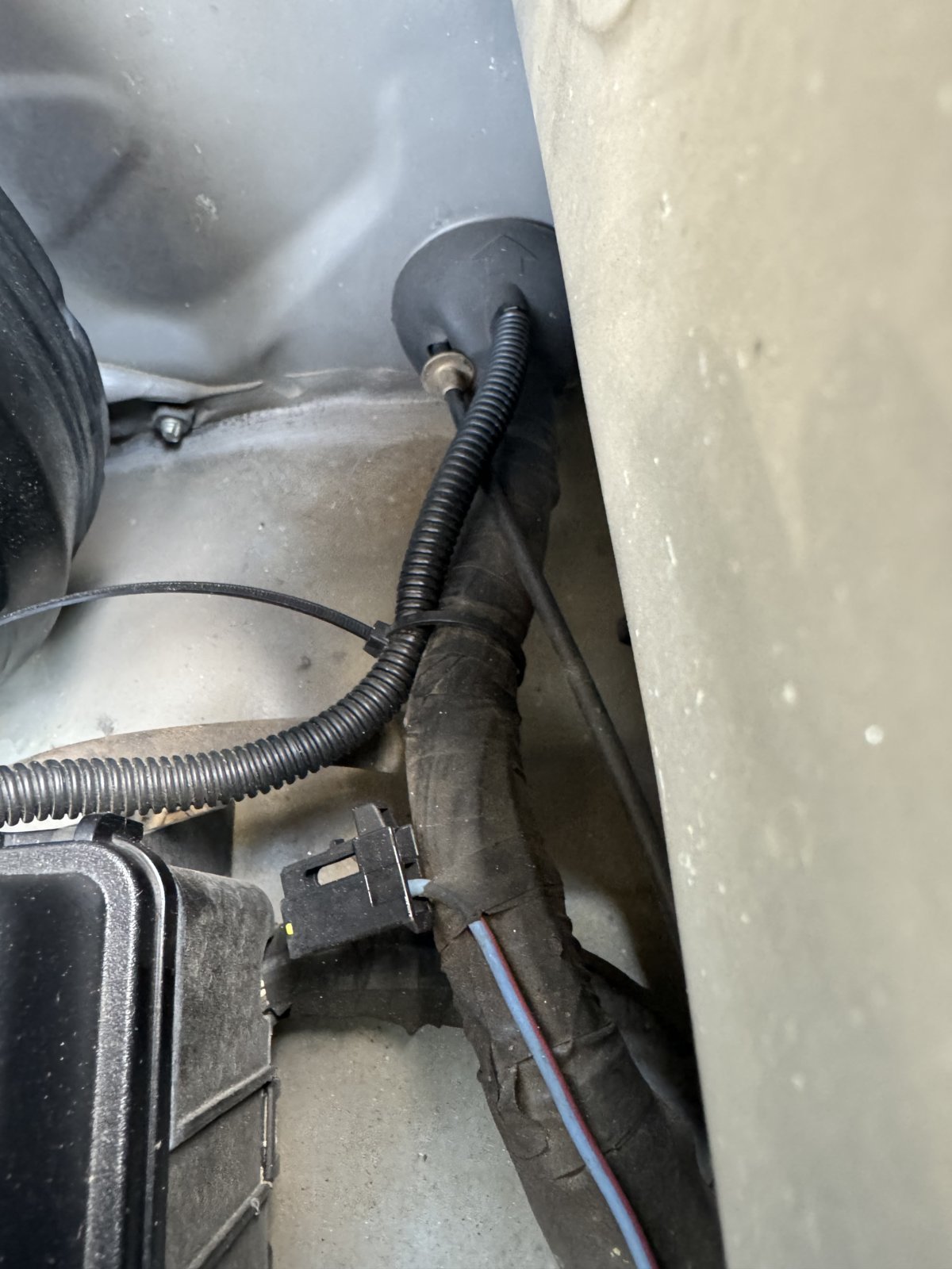

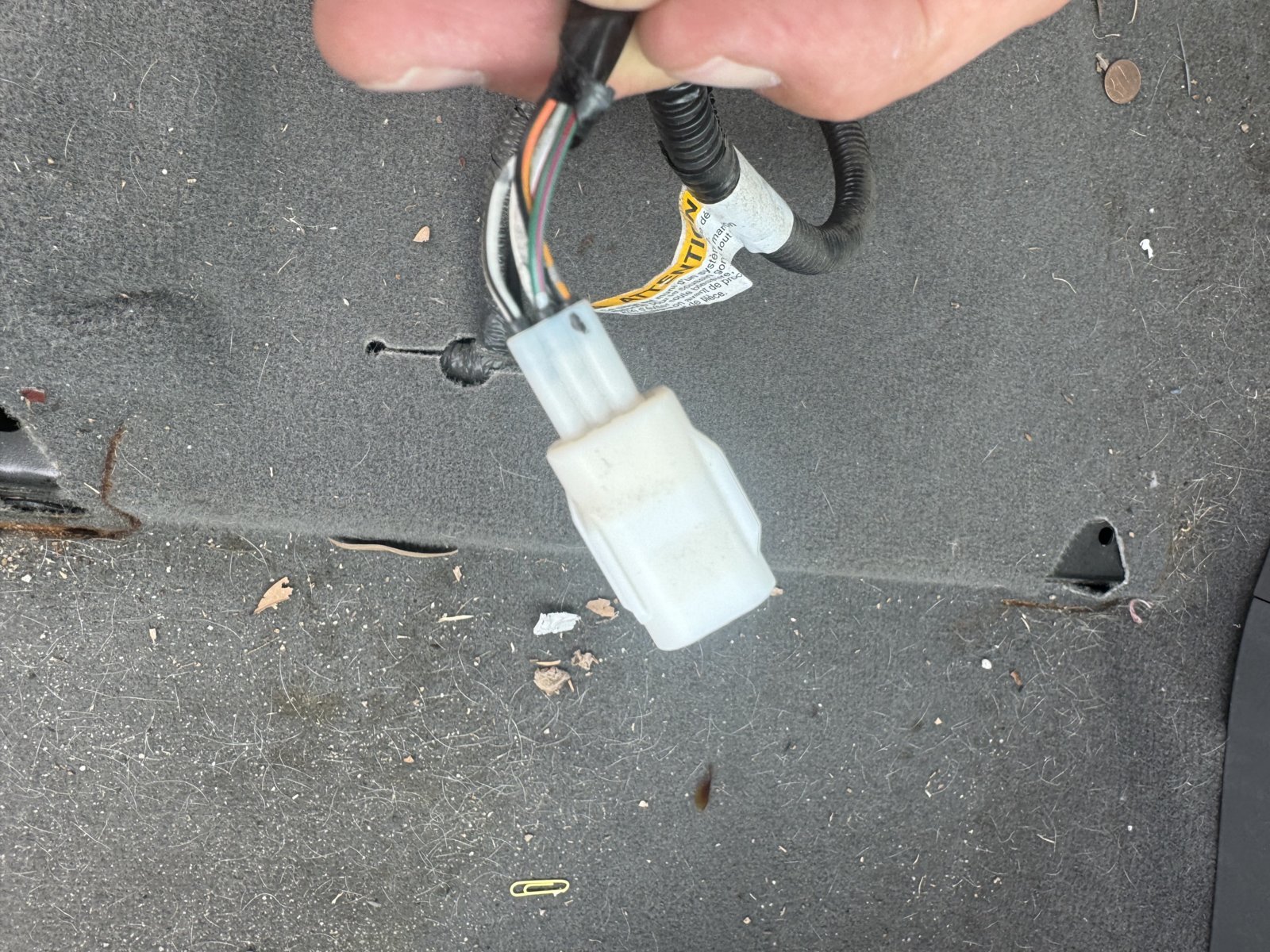

    The junkyard owner doubled down that there is not a separate wiring harness and would not let it go

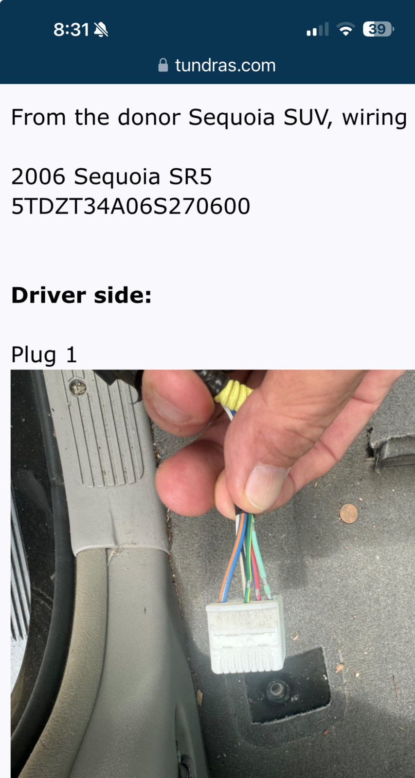

    that did give me a chance to check and these seats do not appear to have the memory function and they don't have heat. It has a side airbag but my truck does not so the yellow plug is irrelevant. Both the airbag and the seatbelt sensor worked just fine when moved to my truck as currently wired

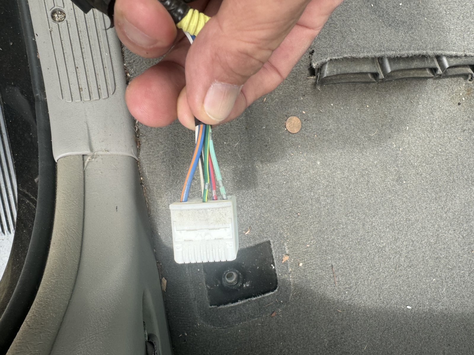

    From the donor Sequoia SUV, wiring to the seat
    2006 Sequoia SR5
    5TDZT34A06S270600
    Driver side:
    Plug 1
    Plug 2
    Passenger side:
    Plug 1
    Plug 2

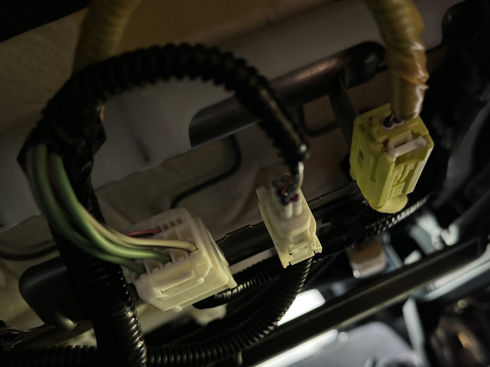

    Donor Sequoia seats

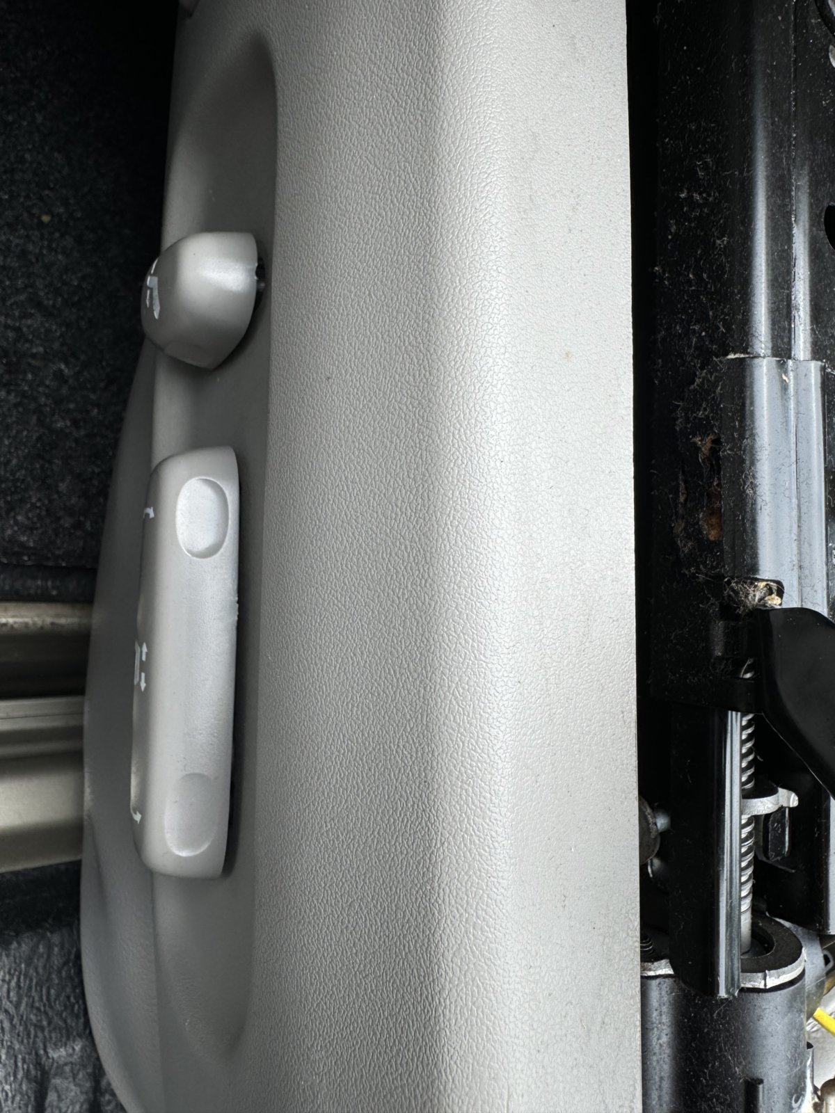

    Driver seat - 3 controls:
    7 total wires (excluding yellow airbag harness)
    Plug 1
    Plug 2
    Passenger seat - 2 controls (no lumbar)
    8 total wires (excluding yellow side airbag harness)
    Plug 1
    Plug 2

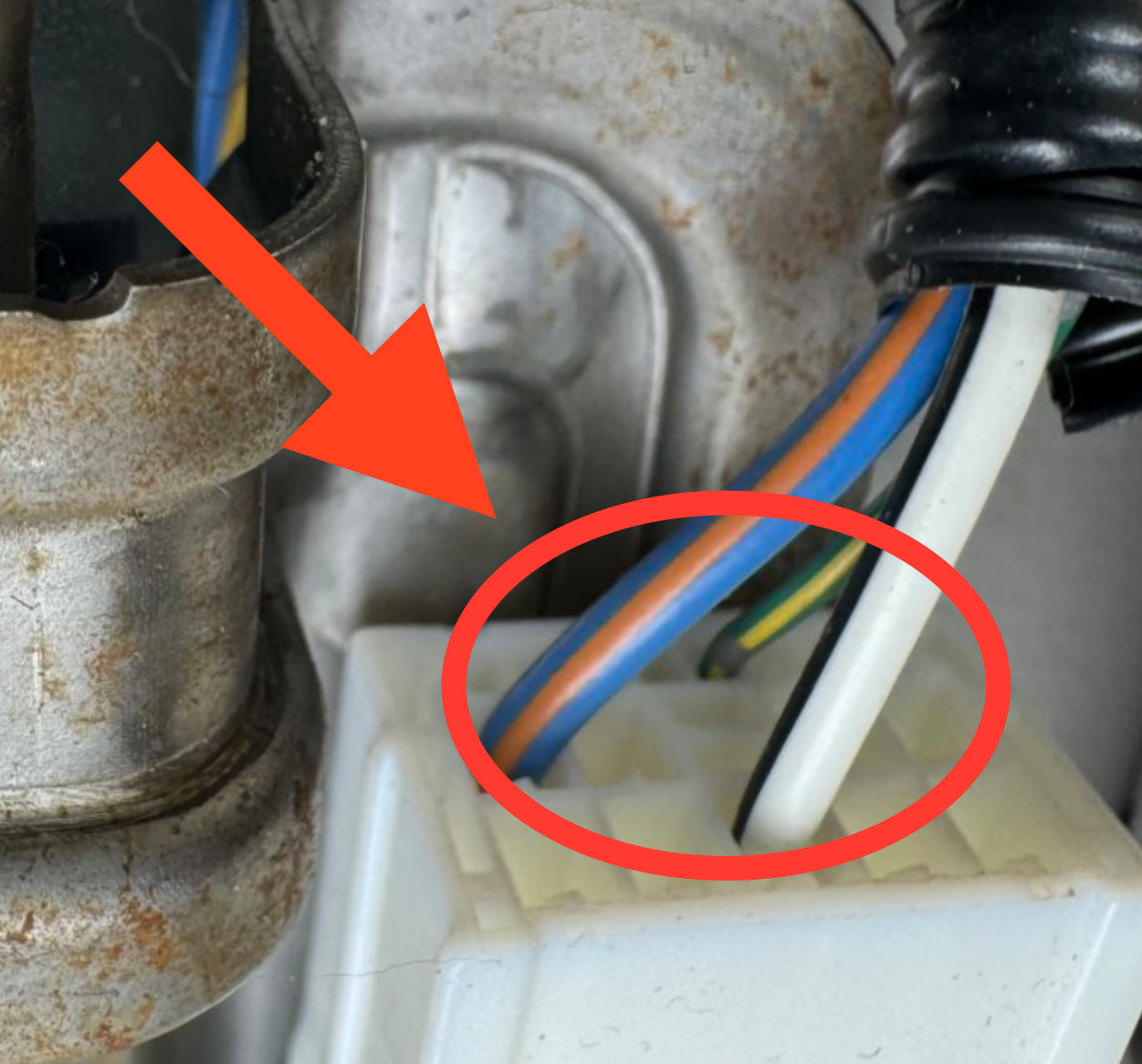

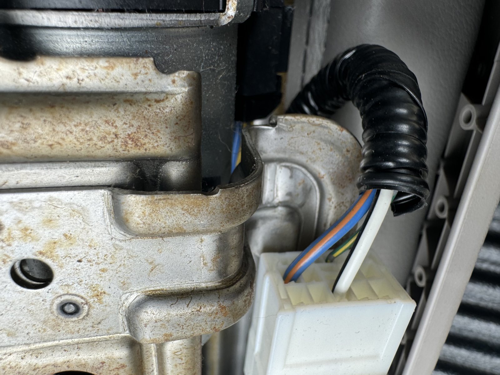

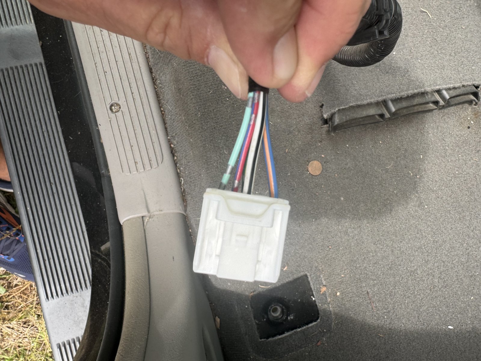

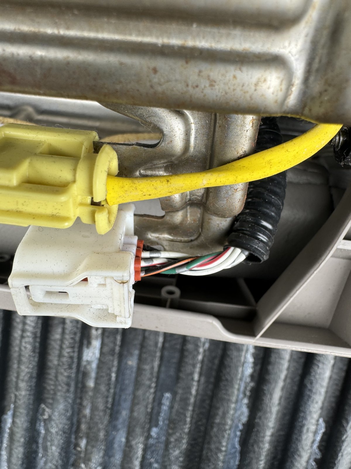

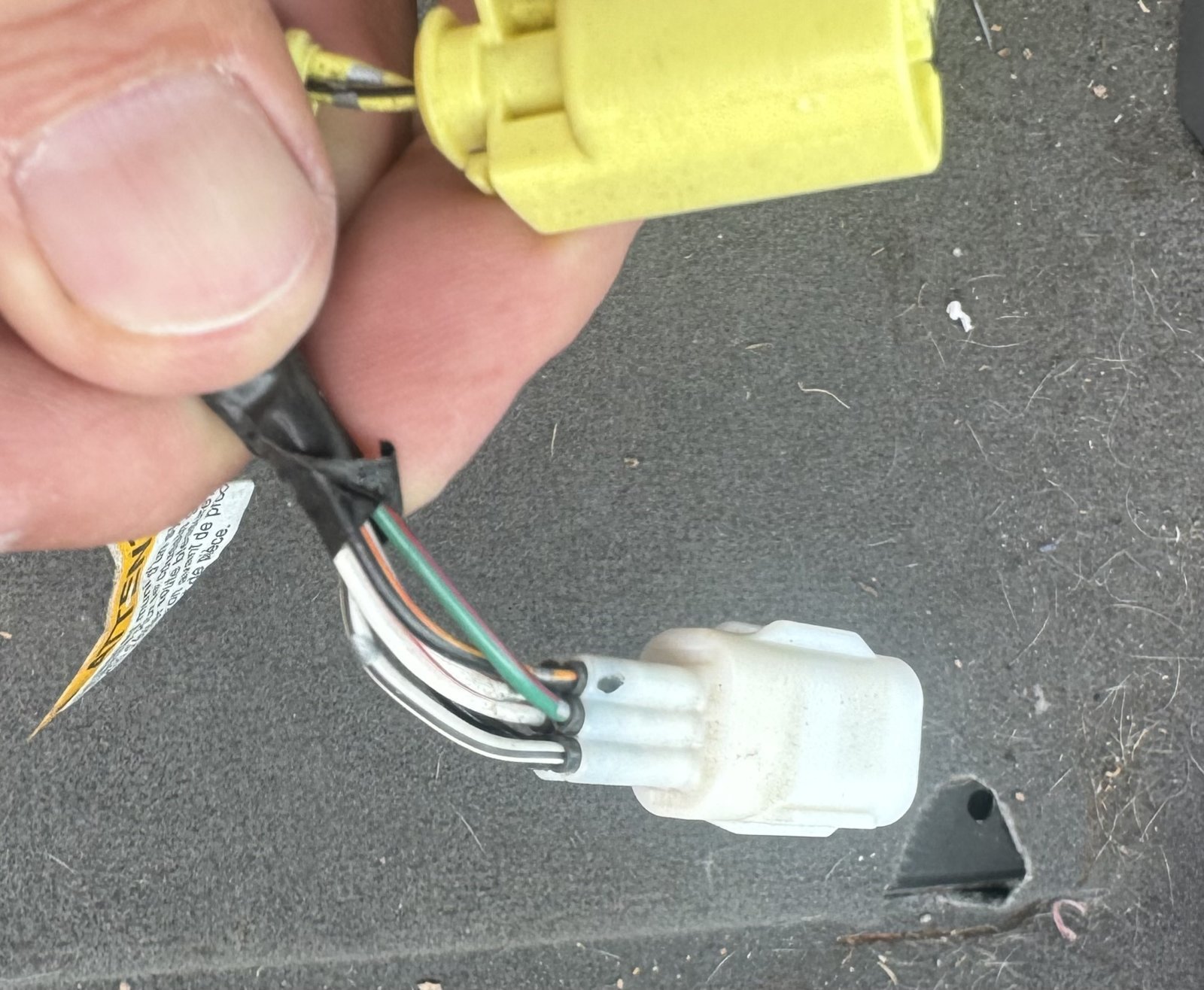

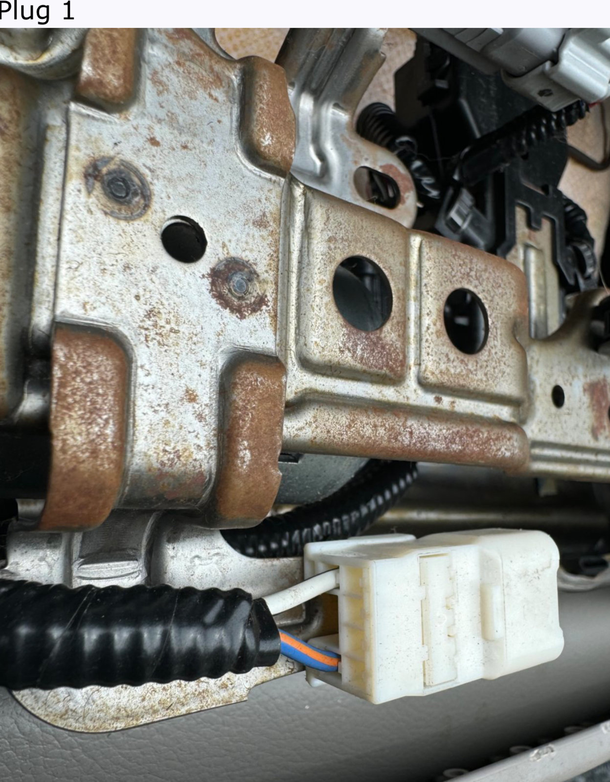

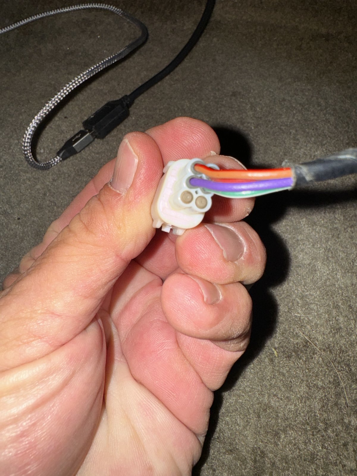

    This is from the driver seat plug one. These two wires appear to be much heavier gauge so I'm pretty sure they are power wires.
    Since I believe everything on the driver side works except power to the motor then I believe that's all I have to find
    and this is the same 2 heavier gauge wires being fed to the seat

    Not sure I necessarily need the wiring diagram
    All that is missing is a power and the ground to the motors in the seat
    So I guess the question becomes do I just do a bypass with a 30 amp fuse to the battery and test those two wires?
    Then, if that is the solution, do I just cut those two wires from the harness and get a separate harness connector just for the power and ground?
    That would be a last resort for me
    I don't see how you could add those two wires to the existing connector from my truck

    Since the motor AND the control Switches are within the seat, I'm thinking there is one ground and one 30a power wire per seat
    I don't believe there is a different wire for up/down, backward/forward etc. They just change the polarity within the switch/ECU to make the motor go backwards or forwards
  13. Jun 12, 2024 at 6:43 PM
    Weagle
    Weagle [OP] New Member
    Sep 24, 2023
    #104402
    1,084
    Prattville, AL
    2006 Tundra SR5 DC 4.7 2WD LSD towing pkg
    Bilstein 5100's with 2883's - close to 2" Replacing the 2883's and going back to the bottom perch ASAP -mobile/apple play stereo with sub and backup cam -Power stop HD front calipers and rotors for towing -20" wheels with 32" tires (305/50's) Toyo AT 3's with no rubbing -Westin nerf bars -Detroit axle new (not rebuilt) steering rack with poly bushings, inner and outer TRE's -Suspension Maxx extended front sway bar links -Overland tuning - medium level -Power front leather seats and steering wheel from 06 Sequoia -fully de-chromed/blacked out trim -all light housings incl 3rd brake light and tag lights replaced with smoked lenses, LED where appropriate -mini projector headlights -fully rebuilt trans and new torque converter -new complete drive shaft with spicer u-joints and carrier bearing -all LED interior lights including backlighting -new lower window seals for all 4 doors -all new hardware and clips for tailgate Next: Dirty Deeds racing exhaust with LT headers, yellow box, 12 hole DD fuel injectors, redo or replace door panels

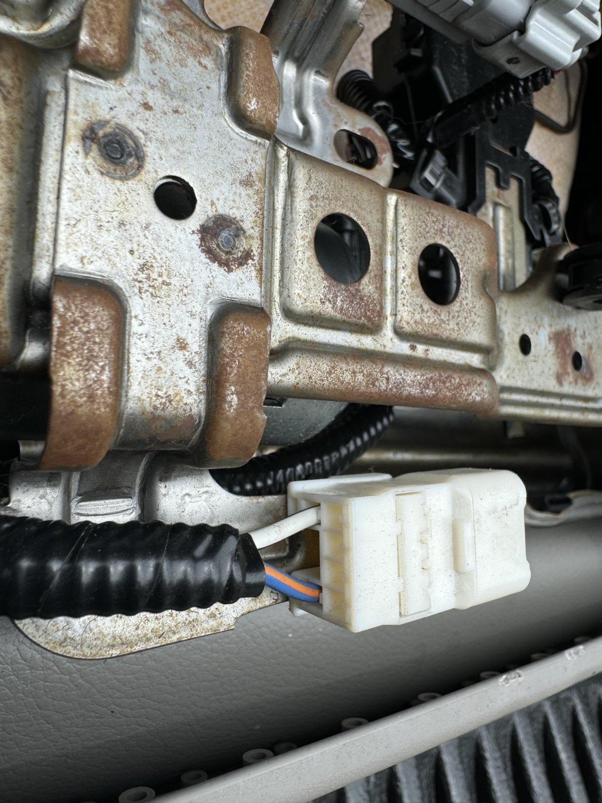

    Same thing on the passenger seat. The white w/black wire and the light blue/orange wire are the heavier gauge wires
    so that means for both driver and passenger seats:
    Power: light blue/orange
    Ground: white w/black

    Testing confirms! The two heavier gauge wires in the donor seats are for the power and ground.
    Light blue with orange is Power
    White with black is ground
    I just ran a power bypass wire with a 30 amp in-line fuse to the battery and clipped it to the suspected power wire in the seats
    And ran a ground to the suspected ground wire in the seats
    All motors on the seats worked
    So I know a relatively easy solution would just be to run the same 2 bypass wires and hide them and cut those two wires from the harness. Then use a couple of connectors to connect the seat to the truck side
    I would much prefer to use something like a fuse tap so it could be connected to the fuse designated for the power seats in the dash fuse box. I'm guessing there is no such thing as a 30 amp fuse tap.
    and I know I could just find a screw and ground it, but wouldn't it be better to run it back to the dash to one of the designated grounds?
    I've never done anything like this, so suggestions are much much appreciated

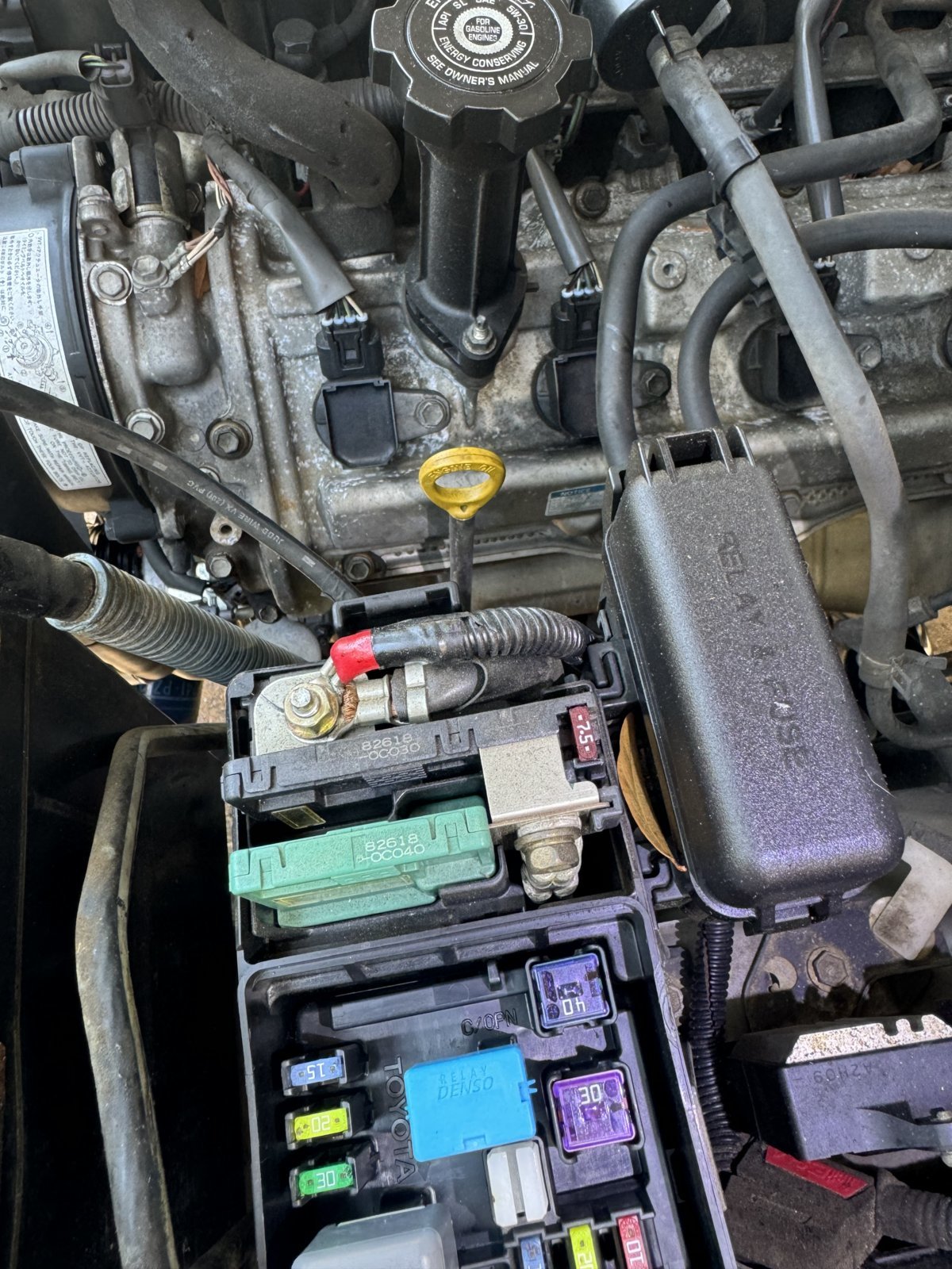

    Are there any empty slots that may be wired on the in-dash fuseblock? I need to read back over this and see where you are when I have more time to wrap my head around it. Summer, kids out of school, been spending a shedload of time with them.

    Yes - a 30 amp fuse that is marked as power seats in the fuse box under the dash

    You can actually buy pinned wire pigtails from a Toyota dealer. You can solder and heat shrink the pigtail into your wire and put the new pin into your connector. YouTube shows how to open the connector and insert the pins.
    Weagle[OP] likes this.
  19. Jun 12, 2024 at 9:06 PM
    Weagle
    Sep 24, 2023
    #104402
    1,084
    Prattville, AL
    So you're saying take the new one apart and
    steal the pins then open the existing and add the pin? And of course solder the wires
    Wouldn't it have to be from the same type of connector though? Or do they sell the connectors that match my existing connectors?
    This would be ideal

    They’re individual wires about 6 inches long with the pin attached to the end. They also sell empty connectors if you need one of those.

    The other way to get what you need is to grab a piece of harness with connectors from any Toyota in a junkyard. You then harvest the pinned wires to finish out your project.

    Aren't there different types of pins and sizes in many of the connectors?
    i'll be one of these two suggestions or both if needed tomorrow
    This will come in handy in future projects

    There are a couple, but they go with wire size. Power and ground should be the same, and they’re pretty standard sizes. If you get a pigtail harness at a junkyard, get one with wires your size and the pins and sockets should be your size also. You’ll trial fit them to be sure, of course. Or the pigtails from the dealer will definitely fit.

    Preferred locations to tap power?
    found a ground that is under the carpet under the driver seat.
    I've taken the console out and I can see that the wiring conduit for the seats goes under there, but I can't tell where it comes out
    i'm just gonna run it near the door jam along with other conduit for a lot of other wires. Connect the ground under the seat
    i've got a 30a fuse tap arriving today that I'm hoping will work to use the existing power seat block in the fuse box but I'm not extremely hopeful
    so I'm looking for an alternative power source. One that is not switched. If I had heated seats, obviously you want that switched with ignition. But power seats you won't be able to control whether ignition is on or not
    If the fuse tab doesn't work I can run the power through the firewall where the hood latch and other wires go. To one of the fuse/relay boxes in the battery
    This was the power source I'm looking at. Since it has the horn and door fuses it should be a constant power source. I can disconnect the battery Remove the nut and add an extra power wire.
    any better sources?
    Got the appropriate connectors, conduit, shrink tubing and my solder gun to try to do it right

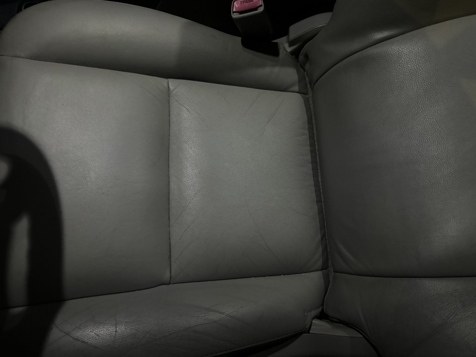

    Success
    All wiring and harnesses/plugs worked just fine. Only thing missing was a non-switched power and ground to the seats. Didn't need switched power since it did not have heated seats.
    Pretty dang good shape The most worn part is the armrest of both seats. Also has leather steering wheel from another Sequoia.
    Excuse the nasty carpet. Has anyone ever dyed their carpet? The exposed parts are in good shape, but badly discolored. You can't tell it from these pictures but the original color of the carpet is almost identical to the seats
    I think I will give this a try:
    Toyotoholic and shifty` like this.

    Looks good. Looks like they sit high to me, but maybe it's just because I never look at my seats from that angle much.
    Leather dyes (interior paints in general) can be a PITA to work with. IIRC, for our "leather" seats, only the center panel and bolster is leather, the sides and back are vinyl.

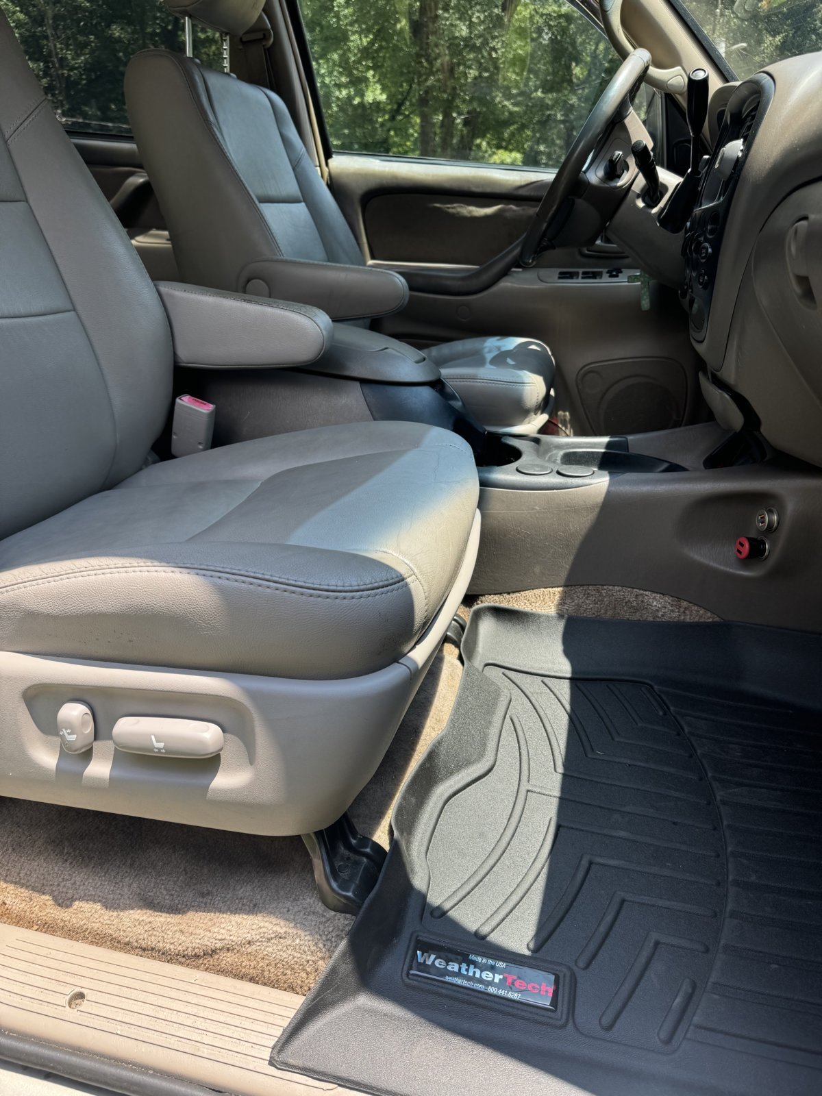

    Thanks! I'm very very pleased
    Passenger seat does not move higher or lower
    I can't tell if it's higher or if the seat base doesn't go as low to the Floorboard
    Driver's seat will adjust lower than my manual seeds and higher as well. And obviously will tilt forward or backwards
