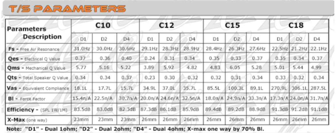

    No, Its a matter of looking over the speakers specifications, its Thiele Small Parameters and matching them up with a volume that will achieve the desired frequency tuning.

    There are too many variables to just say .5, 1.0, 1.5 cu ft will work and achieve the desired result. If your just listening to music and have no concern over how accurate the music reproduction is, then just stick the subs in any box and I'm sure you will be happy with the results. If you are concerned with achieving the best musical accuracy possible and are tuning the system with an RTA and looking to achieve a perfect SQ curve, then you will need to do a lot of research and volume calculations along with cabin gain and sound deadening to achieve a competition level result.

    What parameters do you need ?Can you do it with this info? A single C10 D2 @ 4 ohms RMS 1800W
