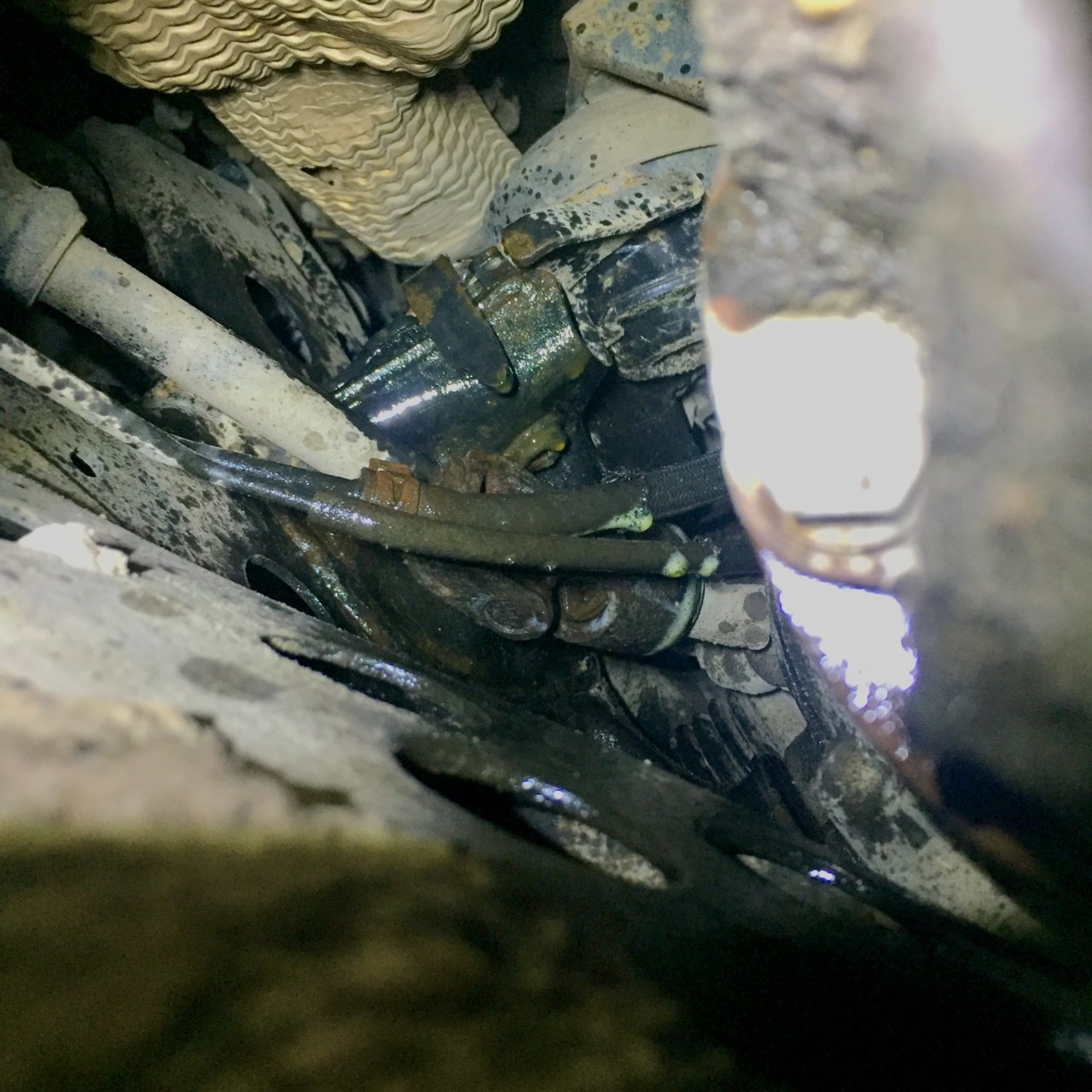

    Not that anyone is even watching this thread but I figured I’d update if anyone finds it helpful in the future haha. Turns out the steering column u joints were rusted up and semi seizing. Sprayed some fluid film on them to check if it was the issue. Yep smooth as new! I’ll be ordering a replacement shaft. Woohoo!
    Could be worse. New power steering pump, new steering fluid. Should be good for another 500000km!
