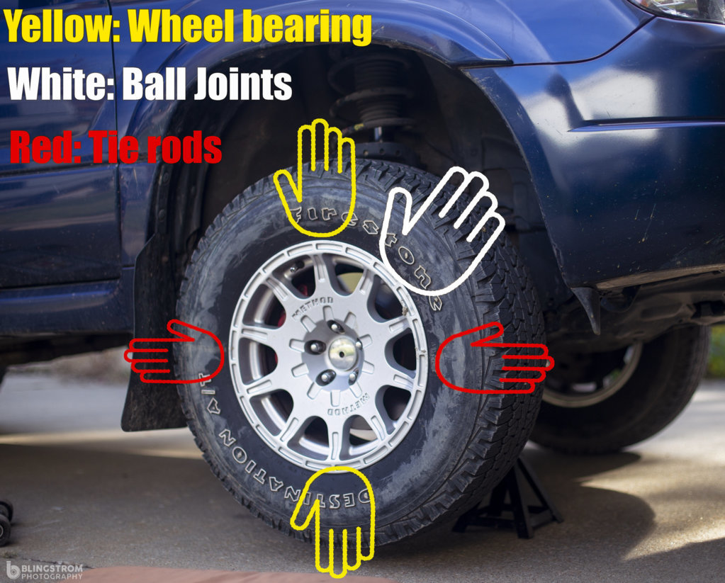

    How old are the shocks. Does it still vibrate on long fast corners? Left & right? What about braking? Do you feel any vibration in the brake pedal?

    Give it the wiggle test?
