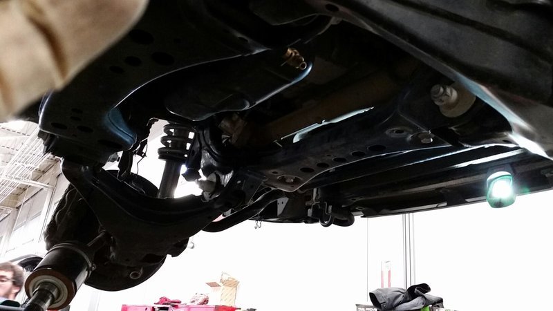

    Here is the pic from @LOTSOFTOYS when he was working on mine:

    Like @csuviper said, it is a Shitty job. the book says to remove the engine. flat rate techs know that's b.s. you do have to remove the front diff. lower the tcase and trans to gain room under the engine. sucks but I can do it in about 8 hours or so. that's cruising pretty good imo

    So I disagree. I changed the rack on my ‘11 4X4 crew cab in 2017. I cheated and did it at a makerspace with a lift.
    I didn’t remove the transfer case or diff. I followed a write up. Pushed up on the engine a bit with a board and jack under the oil pan. With the inner tie rods removed there was barely enough room, but I got it. It did suck.
