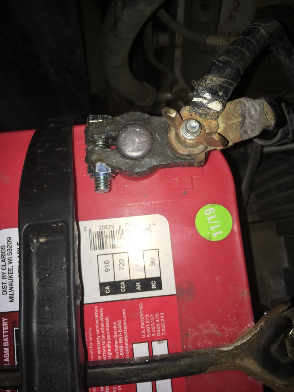

  17. May 5, 2020 at 6:34 PM
    CoMo78
    CoMo78 [OP] New Member
    Apr 9, 2020
    #44842
    12
    The leads aren't corroded - that's the thing. The wires, however, have seen better days.
    I thought bad connection initially (or bad leads). They definitely need to be replaced, but you would think securing the connection would fix the problem - not completely disconnecting, waiting, and reconnecting.

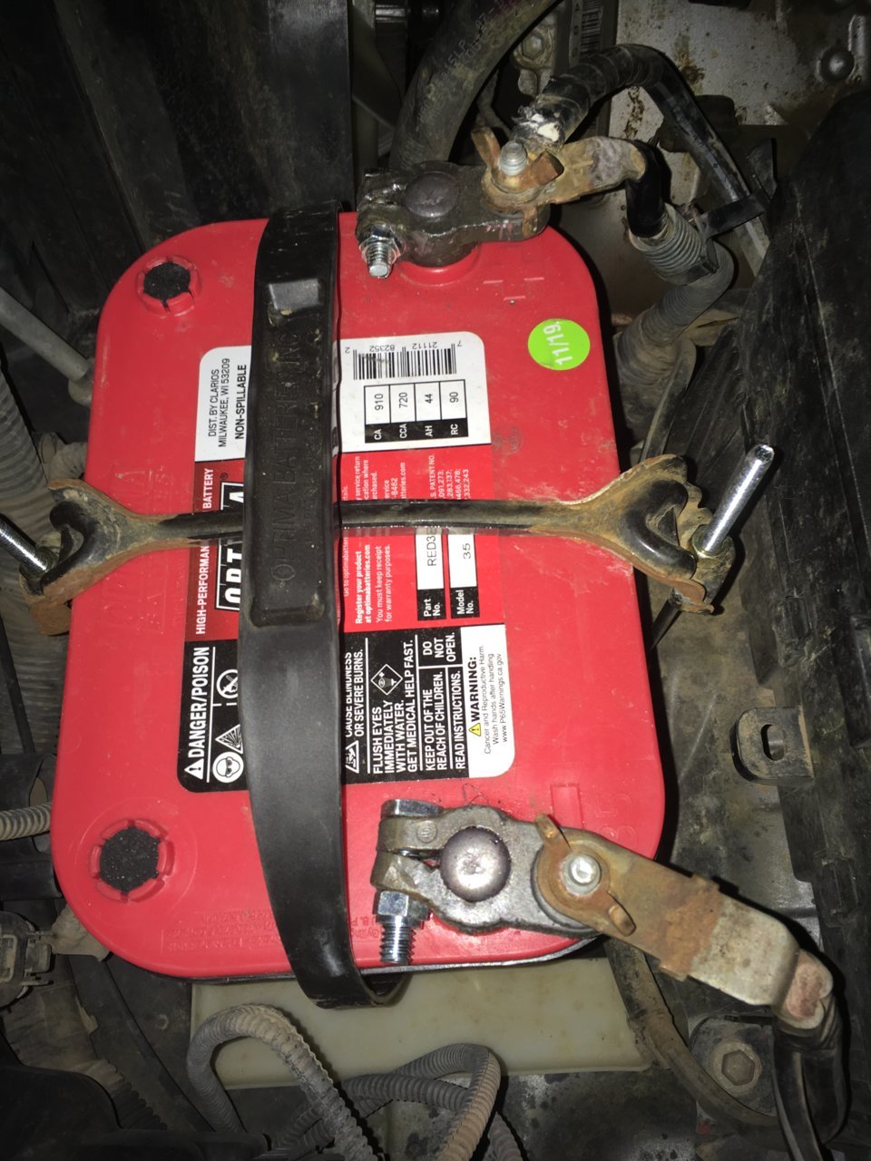

  18. May 5, 2020 at 6:38 PM
    CoMo78
    Apr 9, 2020
    #44842
    12
    Battery & leads...
  19. May 5, 2020 at 6:39 PM
    146,761
    Dafuq

    I vote for new “proper” terminals and hardware ,and to wire brush the wires.

  22. May 5, 2020 at 6:52 PM
    40,565
    Nothing wrong with your Red Top, but those battery leads make me cringe....

    It might just be that when you pull the negative terminal it moves and makes contact in the cable, then when the engine starts it shakes it loose again.

    I've seen worse..........so no problems with old battey? Put it back in and see what happens. You could of got a bad battery, or was it supposed to be charged overnight before install. IDK thinkin out the box.

    ^^^^^ This right here.. I have the same issue, it is your connections. I have an Optima Yellow top that doesn't fit within the battery tie down, so it slides around. Every now and then I'll go to start and it clicks and nothing, everything is dead, so I pop the hood and slightly wiggle the ground while pressing the unlock button on the key fob, because the alarm tends to go off when I do this. First start up after a battery/cpu reset always dies quickly, but on second starts its fine. If your battery is dying, cuz mine tends to, you may need to idle it for about 20min and hit the gas every now and then because it will drop the idle and stall out, may need a throttle body clean like stated above.

    I bet there is bad wiring in your negative and when you move it to disconnect you are able to make a circuit then over time as it sits in its original position connected to the battery you loose connection.

    Would agree with this, but there is probably a reason why the ground cable is forced damn near to the base of the post. I remember the service department would jam it all the way to the bottom of the post to the point where I needed to remove it for some work (ie. MAF cleaning) it would almost be impossible to remove the terminal without using some leverage wrapped in a rag.
