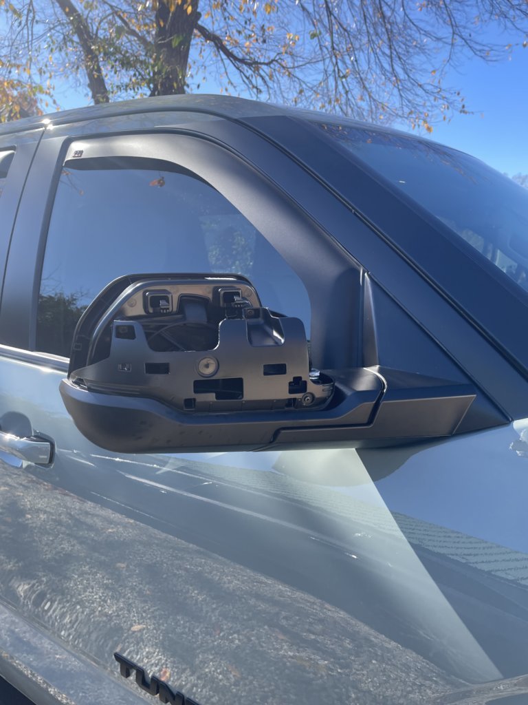

    Anyone else with the basic rear view mirrors having their mirror caps pop off? Neither of mine were tight when I got the truck and the carwash just broke one of mine off. They only have a few weak mounting points from the factory, I think when I replace them i'm going to have to glue them on.

    Turns out the mirror covers are backordered several weeks so this may be a wide spread issue. I went ahead and purchased my own cover but I think i'm going to have to document this with my dealership in case it happens again. What sucks is now I need to put a bag over the mirror (on a brand new truck) when it rains because I don't want water going down into the door panel via the hole that the powered mirror cable passes through. Alot of people complain about cheap bits on their tundras and this part is no exception.

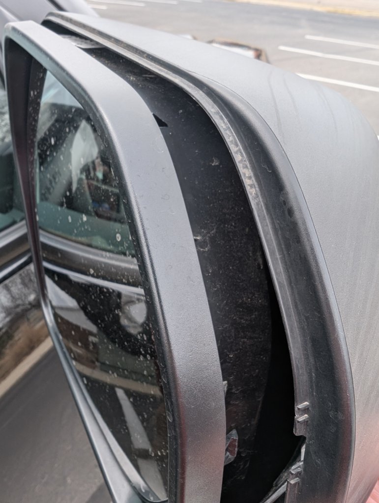

    I have this exact problem with both the driver side and, more recently, the passenger side mirror when I go through a car wash. I always fold the mirrors in before entering. If the mirror remains folded in throughout the wash, I haven't had a problem. However, the action of the car wash will often return the mirror to the normal (unfolded) position. if this happens, it is likely that the cover will come loose. The problem is that the mirrors will not remain folded in. In my opinion there is too little tension (friction) on the pivot mechanism to hold the mirror in the folded position. I have brought this to the attention of my dealer, but have not been provided a solution. The service department seemed unaware that this might be a problem. The service manager did mention that he would research the problem by looking into an internal database that Toyota maintains.
    My daughter has a similar truck and her mirrors are equally loose. However, she has not had the covers come off like I have.

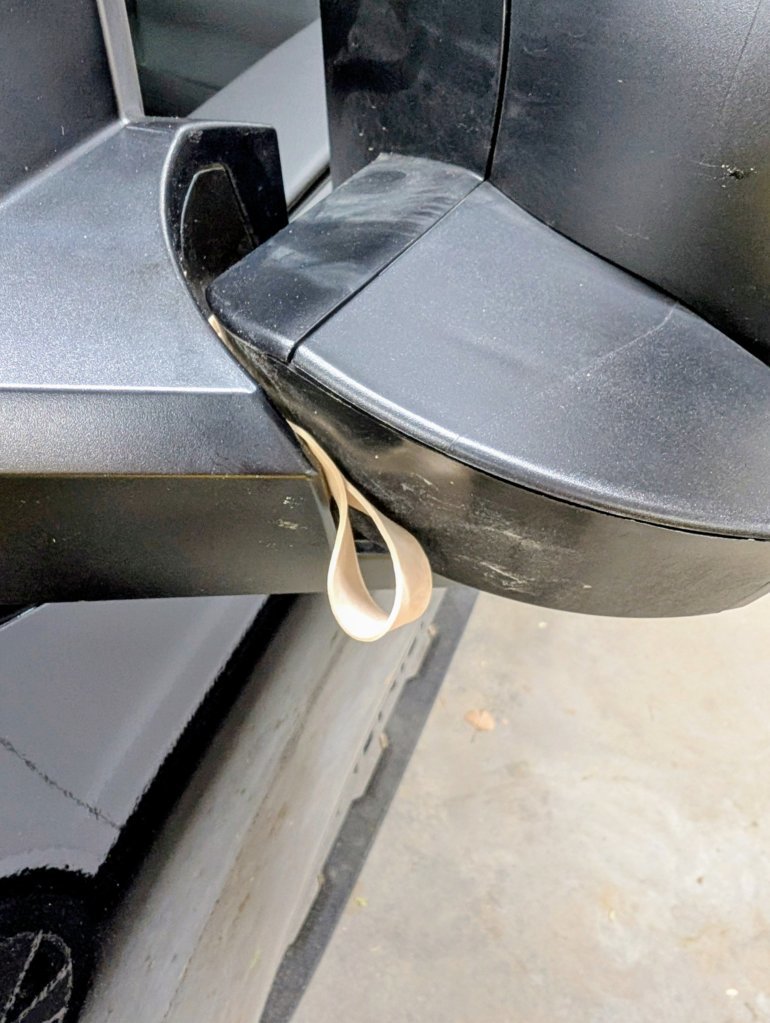

    I found a solution that at least allows me to go through a car wash without the mirrors opening up. As previously noted, I don't have a problem if the mirrors stay folded while in the car wash. I fold the mirror in and stretch a super heavy duty rubber band into the crack (see photo) between the stationary part and the moveable part. This seems to add just enough friction that I've not experienced the previous problem of the mirrors opening up while in the car wash.
    YMMV
