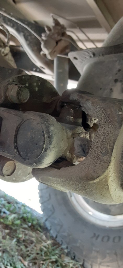

    I've been hearing a cluncking sound when I put my truck in reverse. Woke up to this.
  19. Oct 20, 2024 at 1:25 PM
    Drrkshox
    Drrkshox [OP] New Member
    Aug 8, 2024
    #121071
    34
    2000 toyota tundra sr5 4.7l 4wd
    I have zero rust under my truck I'm guessing this is factory. I have 278000+ miles on this truck and I'm wondering what is the best oem website for front suspension. Well for basically everything I need when something goes wrong.

    It's fine. Just grease it up and send it. Hhahaha
