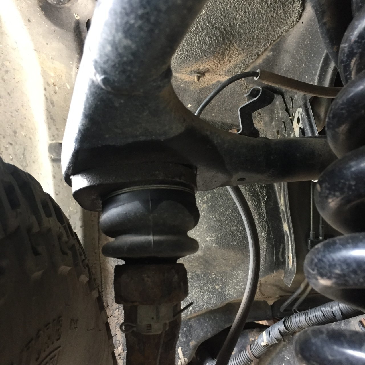

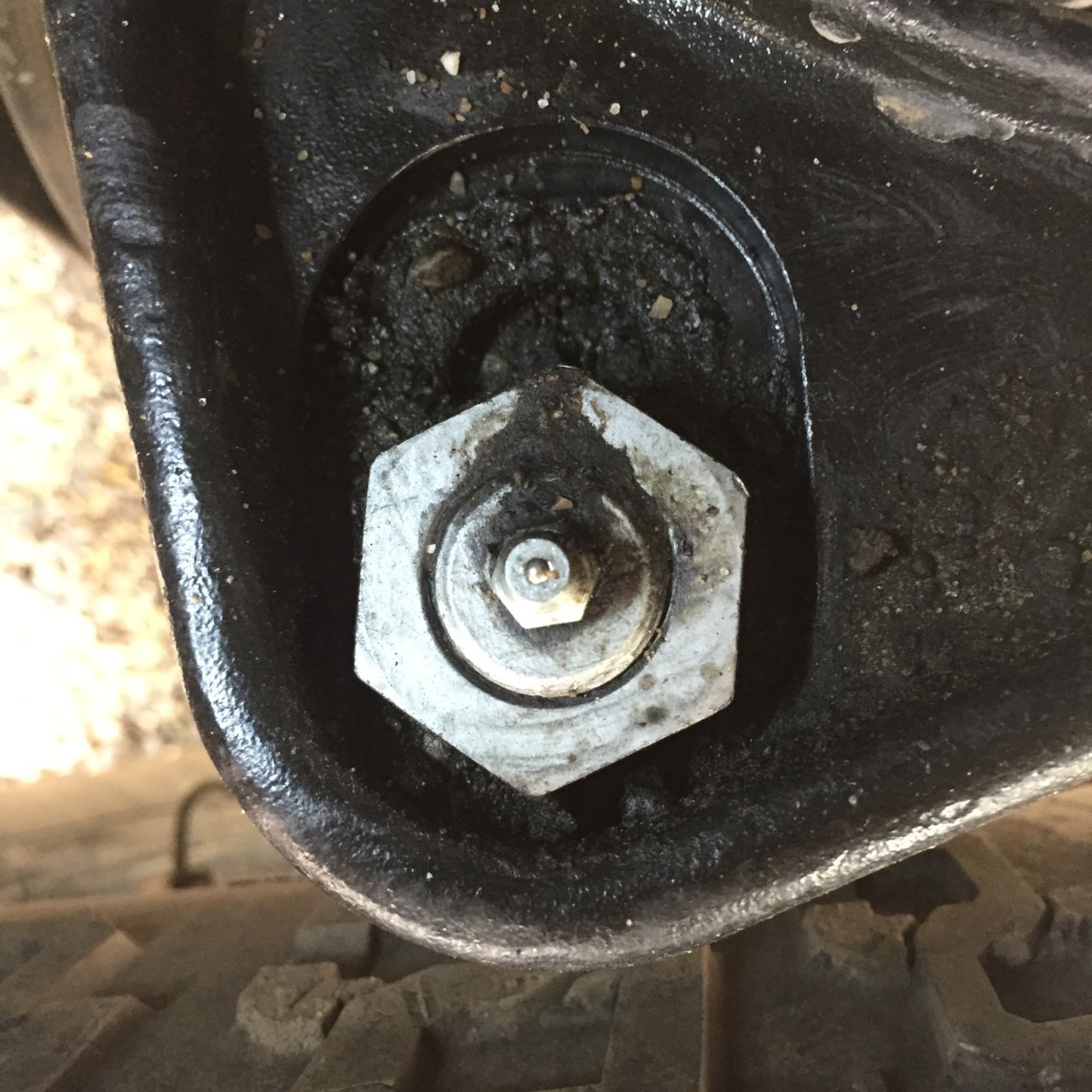

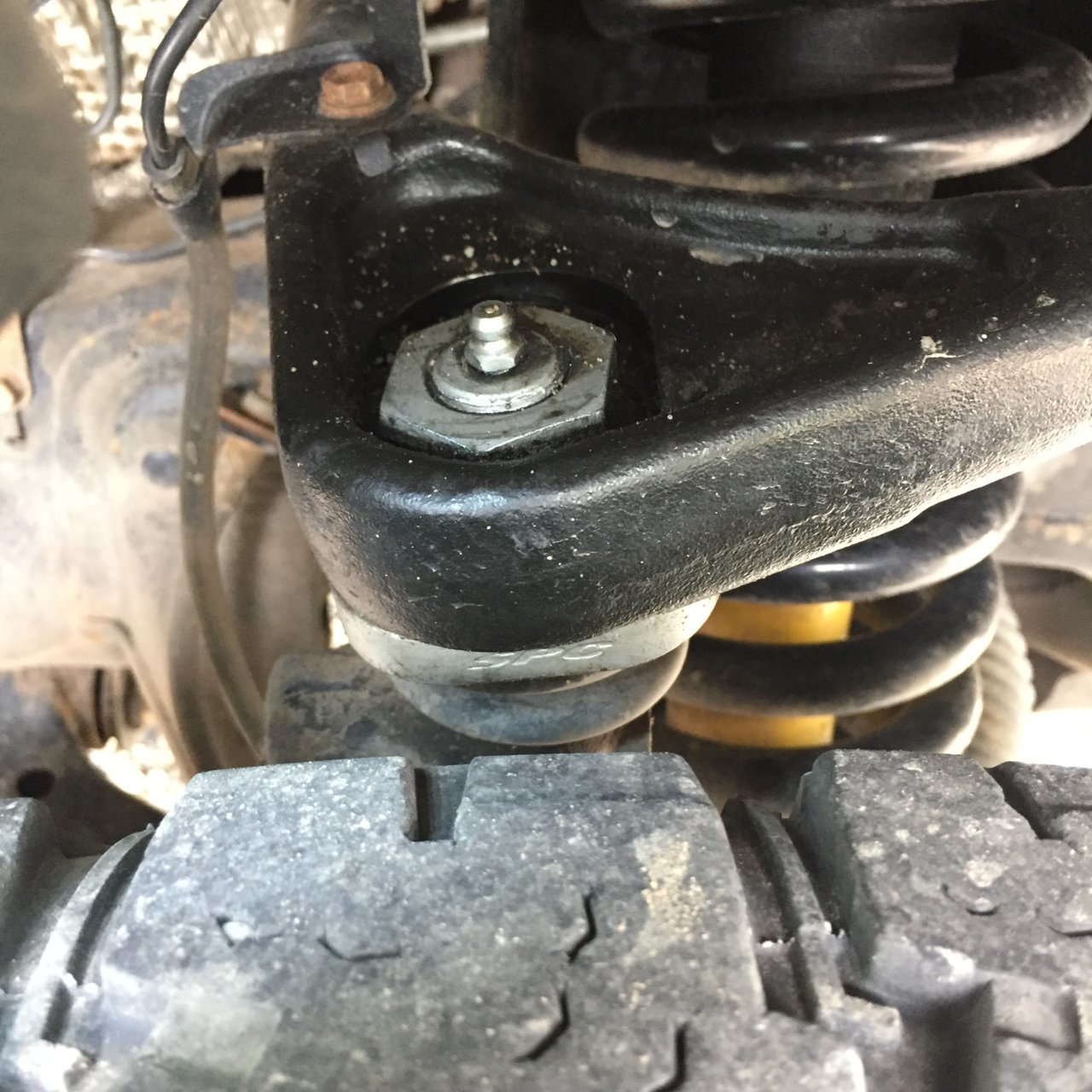

    Here’s mine with a 3” old man emu lift. The height of your lift will make the ballpoint setpoint different on yours.
  3. Sep 9, 2018 at 10:07 AM
    146,767
    The SPC logo needs to be placed facing outward

    You’ll see in my pic I have the upper hose clamp for the brake hose unhooked. I found it seemed too tight at full droop on my truck. Anyone else find this?

    Yes. Mine was the same.
