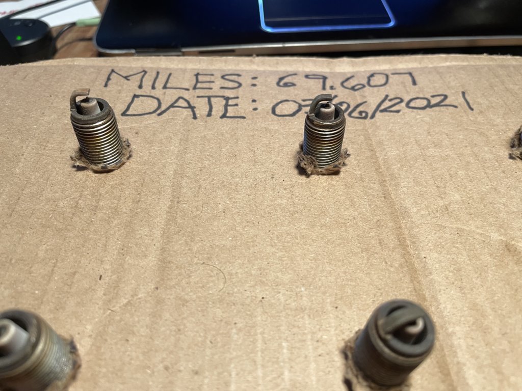

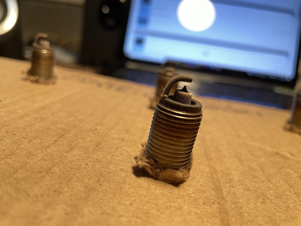

    Here are my OEM plugs at about 69,000 miles. I was curious what they looked like. They lookedPlugs3.jpg Plugs2.jpg great. I'll probably go 20k more miles this time. I bought my NGK's from an authorized NGK reseller.

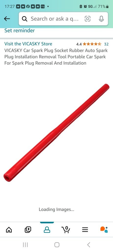

    this came in handy also

    IS it rubber coated so you don't damage anything? Also was it long enough?

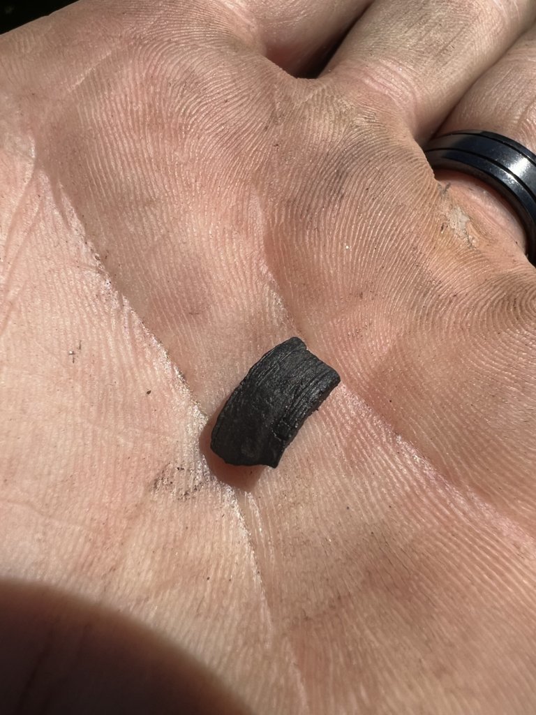

    My 07 had some nice carbon build up in cylinder 6. More than pictured. Modified my shop vac to clean it out. IMO it’s not a one hour job given the SAIPs but it's not a $600 to $800 job either
    Changed at 214k last changed 120k

    the whole thing is like rubber to install the plugs gently. yes long enough that i cut to the size i liked
