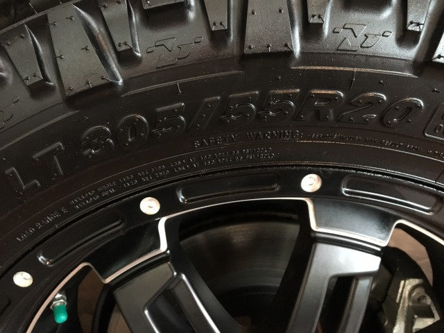

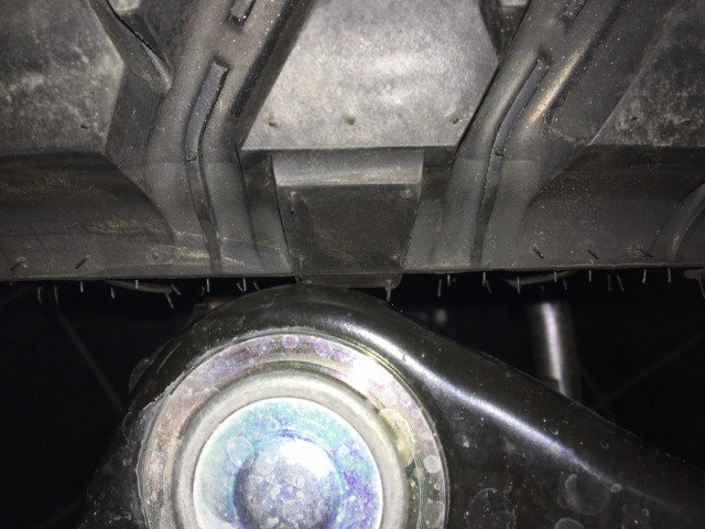

    Years ago local dealer put 305/55/20s on TSS (55+ offset) wheels on new SR5 trucks with a cheapo spacer lift.
    It had much less than 3/4" clearance.

    Wow! That is tight. Thanks for the input.

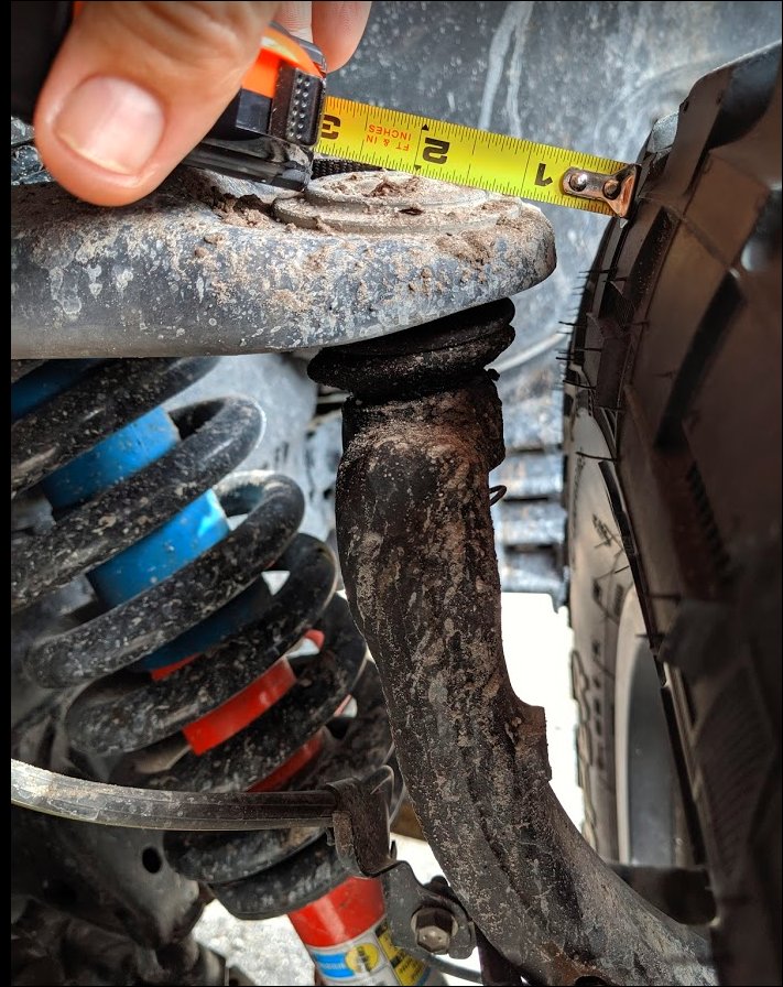

    I have about 1/2" and have never experienced any issues.
