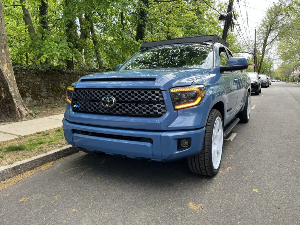

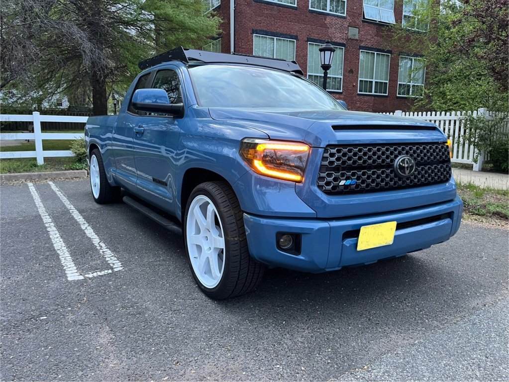

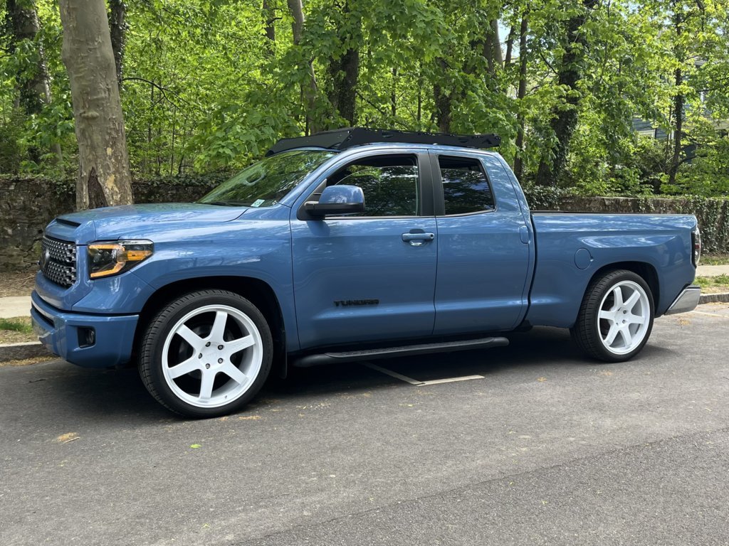

  22. Apr 28, 2025 at 5:42 PM
    Hawk373
    Hawk373 New Member
    Dec 24, 2016
    #5662
    20
    2020 Tundra SR5 Cavalry Blue
    SOS 2.5/4.5” lowered (pending 3UR-FZE)
    Thanks for all the clues that got me to this point guys.
