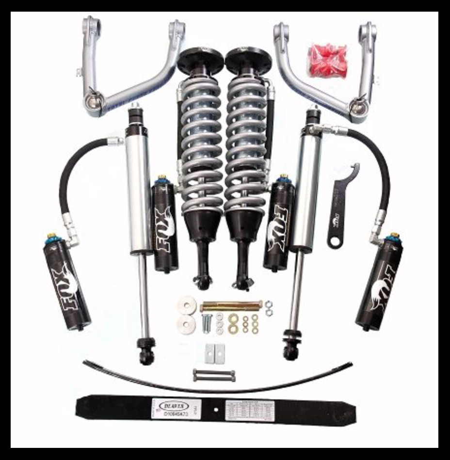

    Considering the ultimate fox 0-3” lift available at Bilstein lifts.
    I believe this will offer what I want, but is it overkill. I like the SCS Wheels, but I think I would have a fucking heart attack if one got scratched or something. They are spendy.

    Thanks, the 2.5 shocks are included in the kit.

    Fox 100%, the kit looks perfect for what you described.

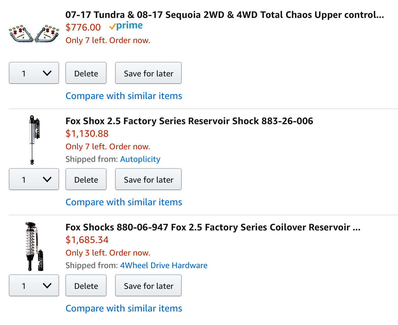

    Found all except add a leafs and diff/carrier bearing spacers on Amazon, free shipping and a 500+ savings. If it looks good I will order. Then start a build thread. Thanks for your help. I knew someone local would chime in. I’ve built plenty of stuff, but man information overload on all this.
