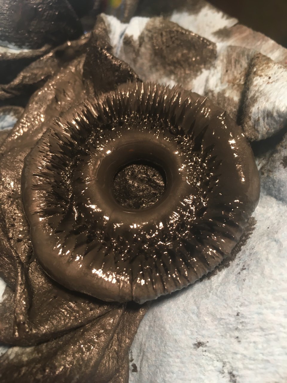

    Why worry ?? This is the magnet out of my transmission with 95,000 miles on it.C0F4DD33-FECB-41D6-9DD6-ABC9D7475B40.jpg

    Editing my post, just woke up for nightshift so my brain isn't fully functioning yet.
    That magnet isn't from a 07-21 tundra. Our trucks have 4 square magnets in the pans. Mine had virtually nothing on them after 170xxx miles.
