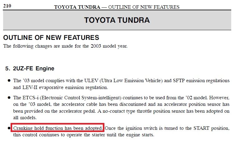

    Our 2005-2006 trucks have the auto-start or instant-start or bump-start or whatever people call it. Where you only need to tap the key forward and it begins its starting sequence, and attempts to start for 3sec, I think? I forget the particulars, but it's quite different than the earlier years in nature.

    This was also on the 2003 and 2004 models.

    I have this...2004

    Can confirm, my 03 has this.

    Correct, a New feature starting with the 03 2UZ, Toyota added a "Cranking Hold" function.
