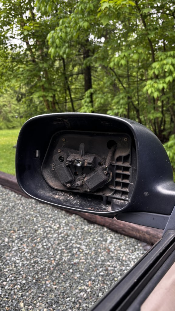

    Some jabroni knocked mine off, couldn’t find the mirror on the ground. Are all the plastic doohickys in place to stick a new mirror on or do I need a whole new assembly?

    Watch this a few times and see if you can tell if everything you need is still there.
    https://youtu.be/MJFMcmR5iGA?si=x-1HHNlVW78SgnvI

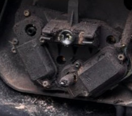

    Looks a little like your left-to-right adjusting pin is broken and gone.
    You can see you still have the up and down pin.
    What the mirror panel looks like.
    The mirror 'snaps' in place in the middle, and the adjustment pins go into the little 'sockets'.

    Based upon the condition of the internals of your side mirror and that you are in NH, my recommendation would be to just replace and get new ones. Make certain you select the defrost version and this is an opportunity to dechrome if that is your thing

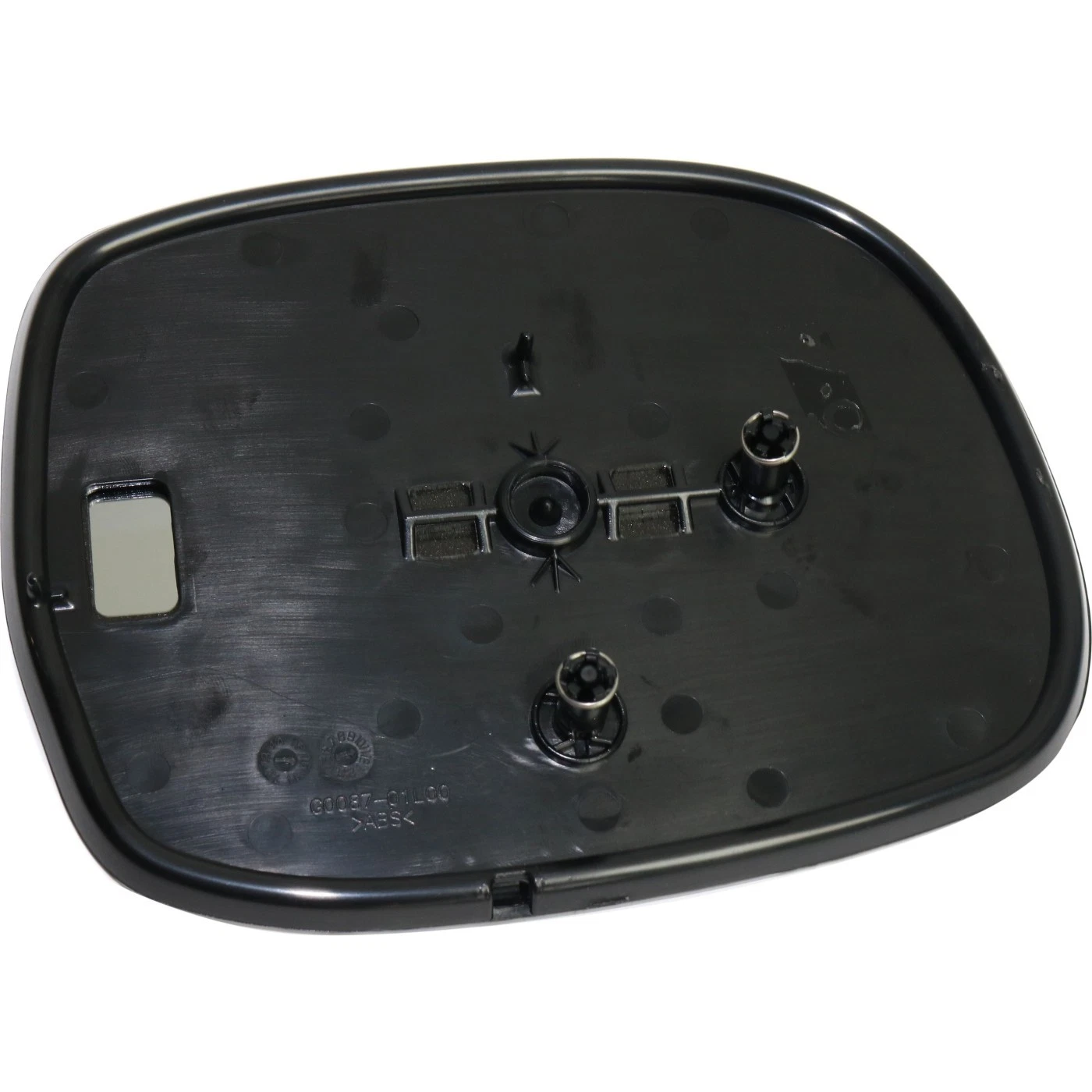

    The OEM glass comes with new standoffs, if I recall right? I replaced my glass after a drive by incident. Posted pics of the OEM instructions and helpful install instructions on here, two or three times. It’s a bit tedious, but fairly doable. Make sure you get the specific part number for your truck. My AC had heated mirrors, so I had to buy heated glass.

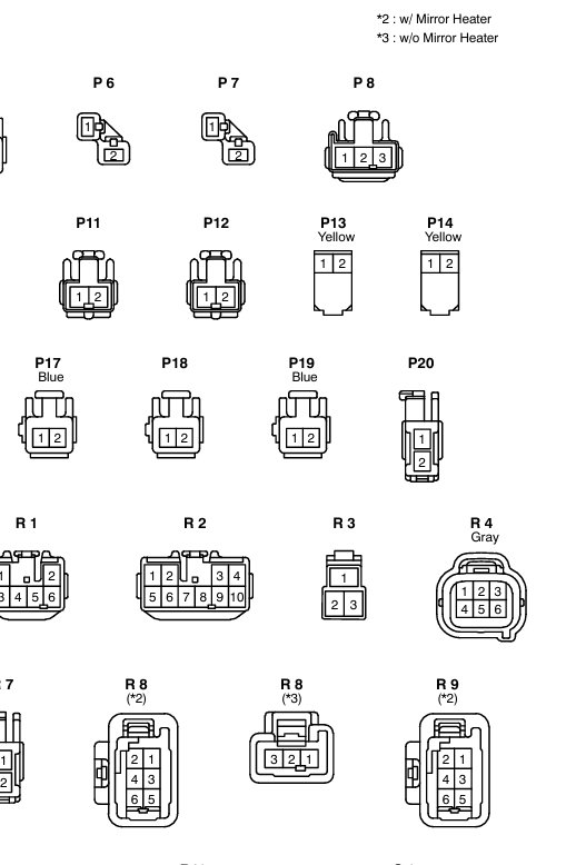

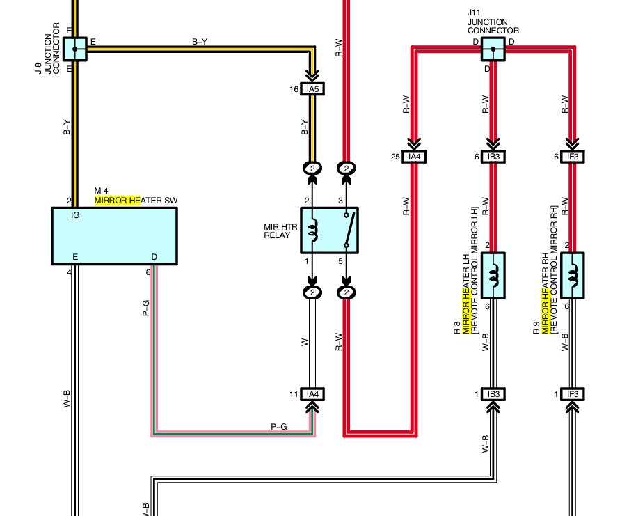

    I don't see the wiring for heated mirrors.
    If you pull the door panel and check the mirror plug and you'll see what's up.
    R8 and R9 connectors, pin 2 power and pin 6 ground..
    Surely if you have the switch, you'd have heated mirrors..:confused:

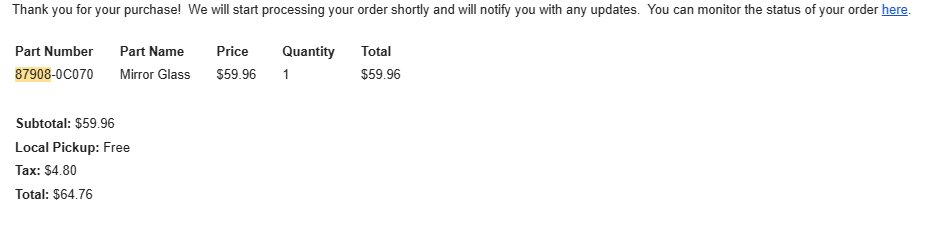

    I replaced this but learned that when you order a mirror, you literally just get the mirror. No backing plate or anything, literally the reflective part and that’s it.
    Ended up replacing the whole assembly as it was just easier.

    Mine came with the full backing plate. It was OEM. I got it from the dealer. Others have done the same on here, and got the full glass, backing plate, etc. but maybe it’s because mine was heated? Edit: Nope. The one shown above also came with backing plate and standoffs, and it’s clearly the full mirror. Where the hell dis you buy yours?!
    I want to say it was @des2mtn or maybe @RUSTYNUTS (pretty sure it was des) who showed how to heat the mirror glass to remove just the broken glass and slap new glass in. You can also buy more-convex (aftermarket) glass to swap in.
