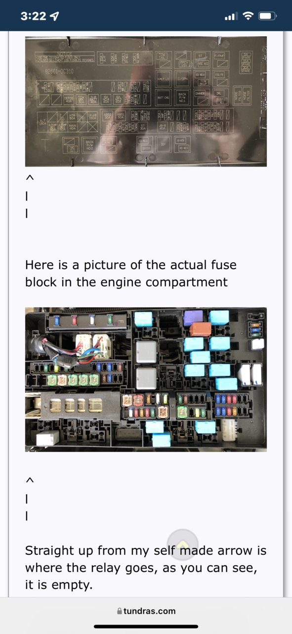

    I am trying to find out what the relay is for the Security Horn on a 2018 Tundra. I got a Security Horn, but looking in the fuse block the relay of course is not there and so far, no one seems to know the part number for that relay.
    In the picture below, bottom row, 3rd one over you will see it labeled for Security Horn. But no part number
    l
    l
    Here is a picture of the actual fuse block in the engine compartment
    l
    l
    Straight up from my self made arrow is where the relay goes, as you can see, it is empty.
    Anyone with a 2018, if you are able to look and get a picture of the relay showing the numbers, it would be very helpful.
    Thank you for your help.
    Rob

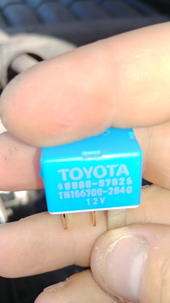

    Secuity Horn relay
    Trebor57[OP] likes this.

    Thank you for the picture and information.
