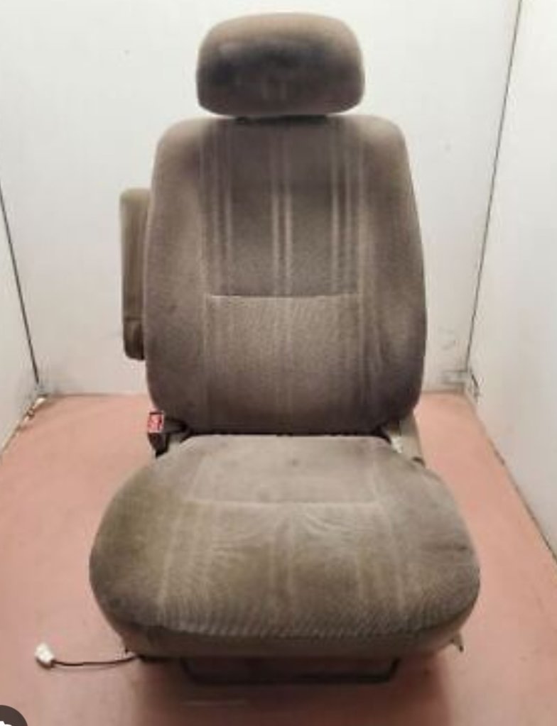

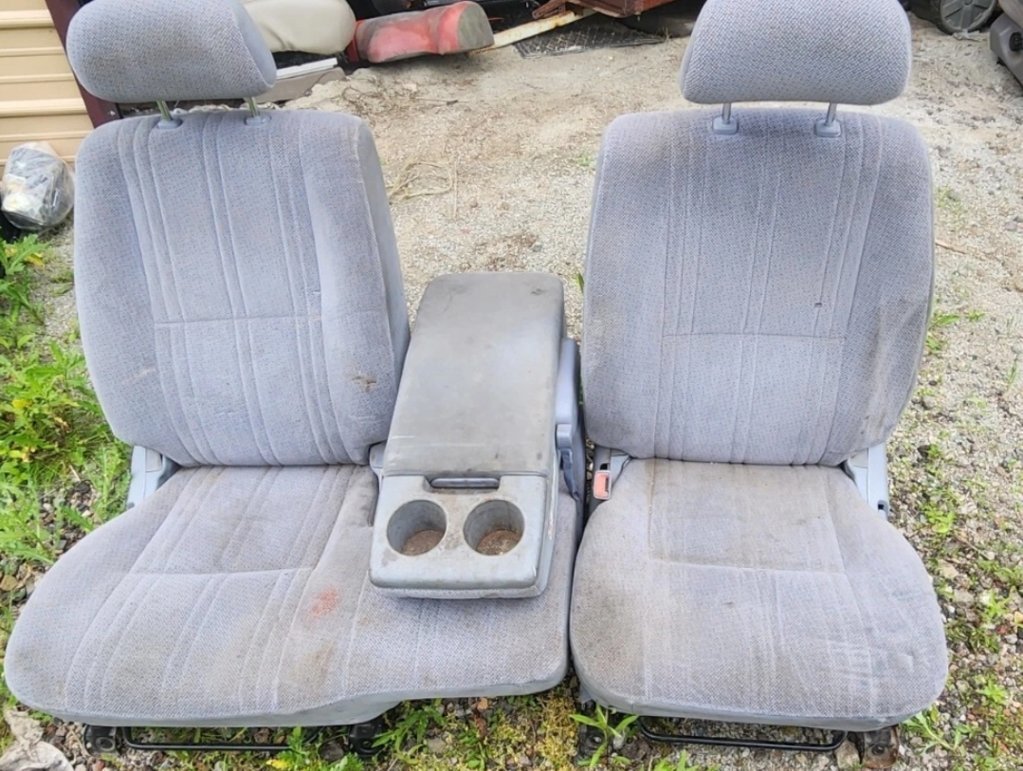

    I'd like to make room for one more person on occasion when I take the family camping.
    If it's the exact same size drivers seat on the bench and the bucket doesn't really seem like a hybrid.
    For example look at these photos. There is one of each and they appear the sameScreenshot_20250606_211931_Google.jpg Screenshot_20250606_211108_eBay.jpg Screenshot_20250606_211931_Google.jpg

    You may have to search around a bit on here, but I swear someone said the bucket seats and the Driver portion of the 60/40 are not the same; the bucket seat is larger.

    I have done a lot of searching, but I bought a 60/40 bench yesterday. When I get mine out I will take a closer look and report back here

    I have a captains driver bottom on my bench. From another AC, not DC
    https://www.tundras.com/threads/wha...-gen-tundra-today.2558/page-1860#post-3483803
    Do take detailed pics and let us know. The question has been asked many times before, but I'm not sure it's been answered.

    I can confirm that it is totally doable in your AC. I cannot confirm for the DC.

    I have done the opposite and took out my bench seat in my 2006 DC and installed buckets. The arm rest is in the way on your existing bucket seat. Otherwise, the holes matched up for me (seat exchange from same year truck though). I'm still trying to figure out the wiring because the occupant sensor and the seat location sensors aren't the same as what was in the bench seat. So similar to you the plugs don't match.
    I haven't been able to really look into it to see what I need to do but I saved the wire harness and sensors from my old seats. I would suggest doing the same and trying to grab the harness and sensors from the bench seat that you're getting.
