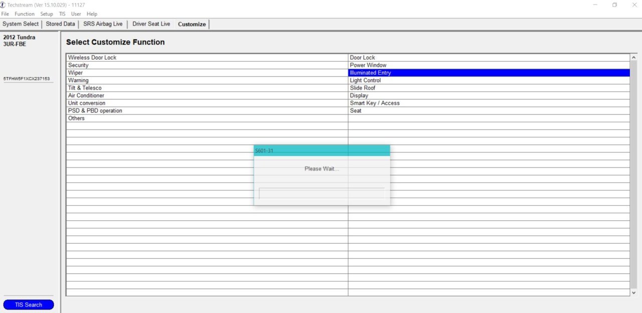

    Anybody have an issue where their techstream won’t actually open the Customize features?

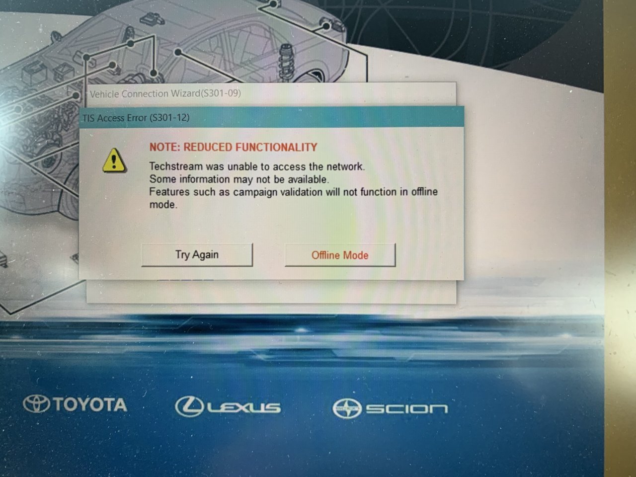

    It’ll connect to the truck and identify it just fine but i do get an error at the beginning. From there i can run a health systems check, check the logs on the truck, program a key (though still stumbling through the remote programming part of it). Everything minus the fun stuff so far as I can tell

    Well thars yer problem! Ha! Sorry, I've never had to deal with that scenario and am not able to offer suggestions outside of googling "techstream reduced functionality".

    All good. I can't get past this screen though which is a tease. S601:31 won't load.

    A shot in the dark. If you close TS, disconnect from the internet (aka Airplane Mode) and open TS again and give it a go, does that work? Also, when you first opened and ran TS, did you select "Corporate" in one of the dropdown menus? Maybe changing that to one of the other selections will get you somewhere. Only make one change at a time though, that way if something begins working, we'll have an idea what the glitch was.

    SOLVED- when installing the drivers for the j2534 cable, you have the option to install multiple drivers. Use the higher number/later versions and you'll be able to customize.
    Still trying to program new all in one FOB that i jimmy rigged together from 3 different keys. Truck recognizes it when I run a remote diagnostic but won't program it. Different issue though .. this is fixed and my seat belt chime is off and a few other features are on.
    Thanks to all for input and help
