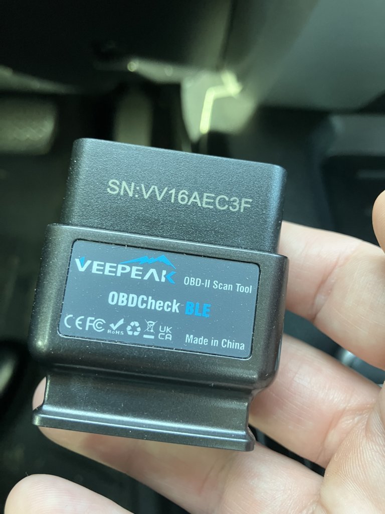

  7. May 13, 2025 at 4:50 PM

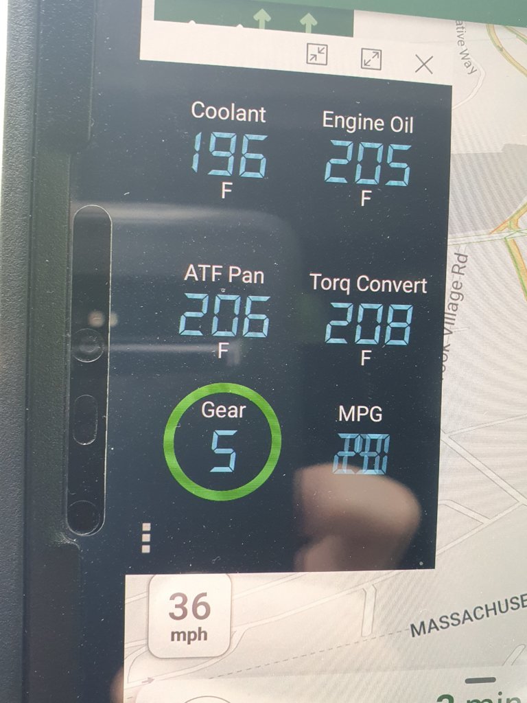

    You can use it to monitor stuff while you drive as well, this is my set up but it's completely customizable.
