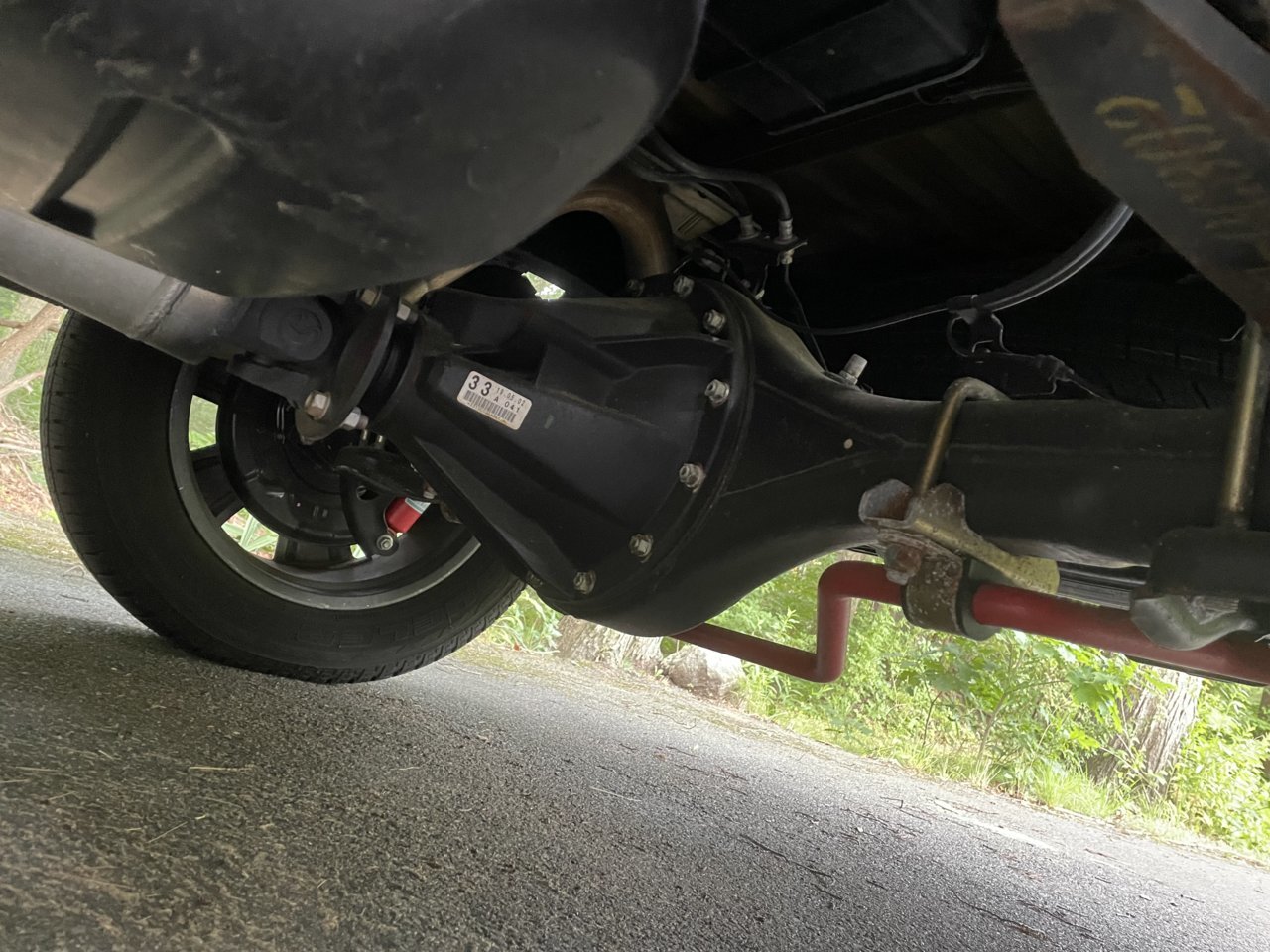

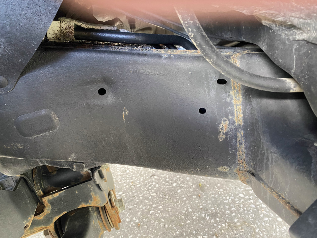

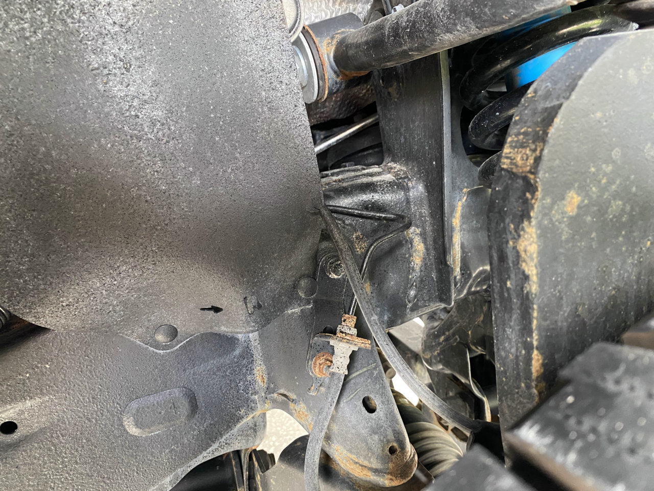

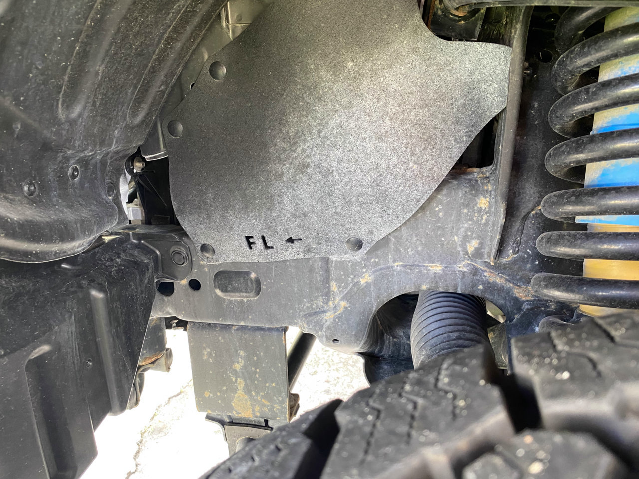

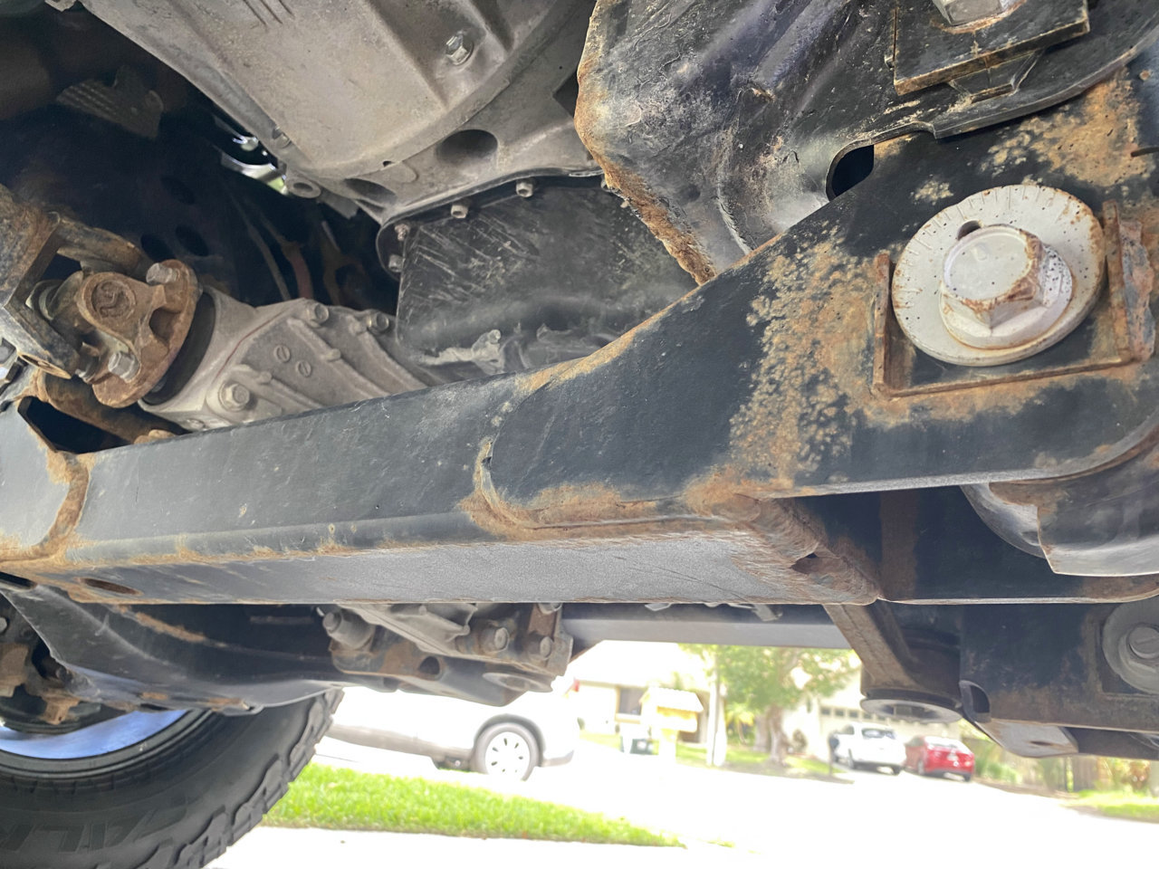

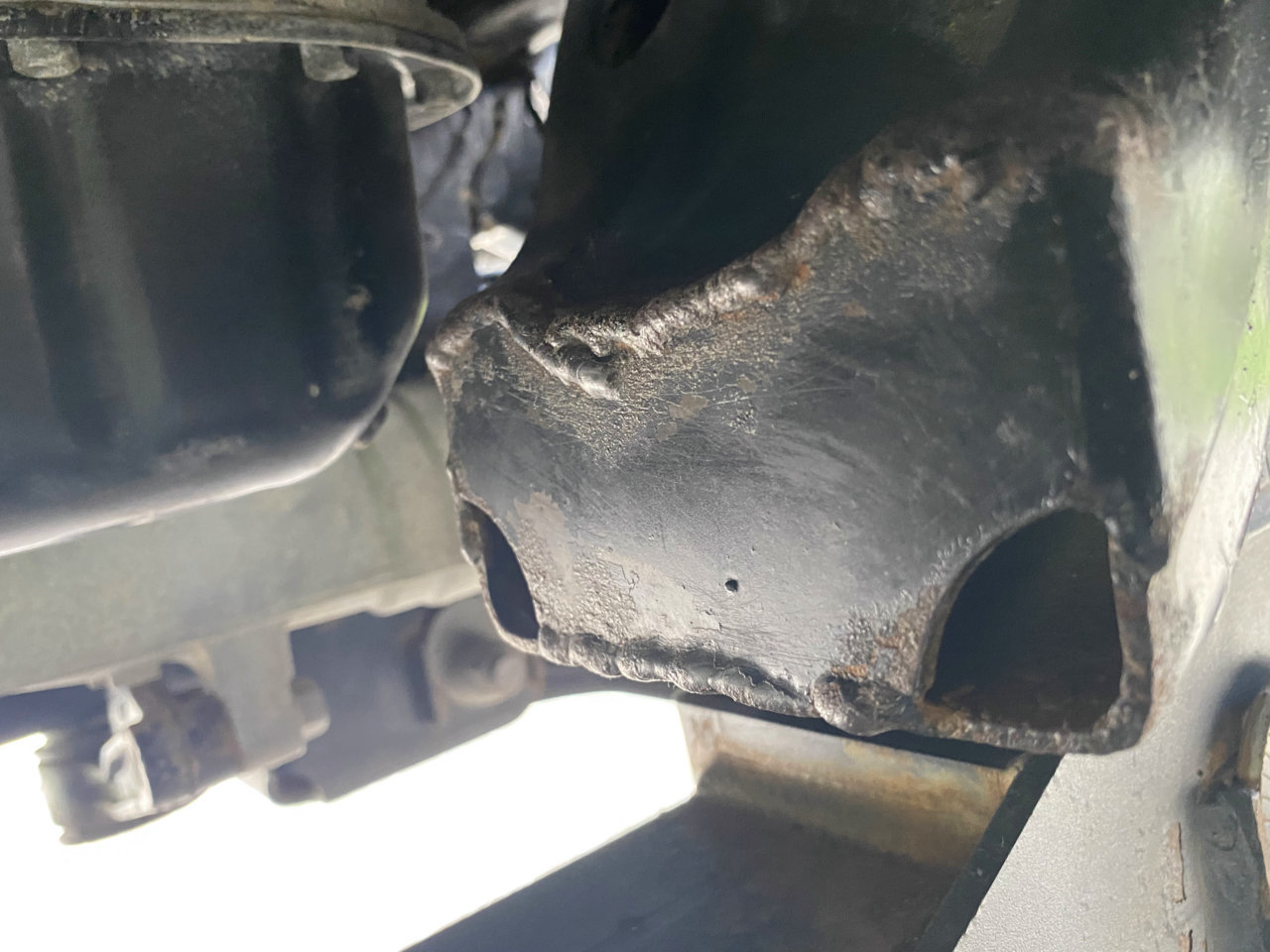

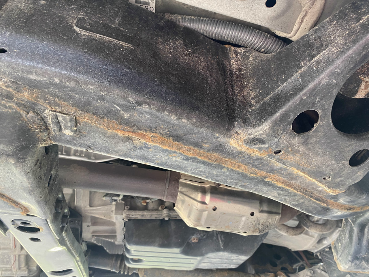

    Is this enough to be worried about?
    How should I get rid of it?
    Are there companies I can pay to get rid of the rust (completely), then paint or LinX over these areas? If so, what do these services usually cost?
    Would a potential buyer back away after seeing this?
    Am I worrying too much?
    Thanks in advance.

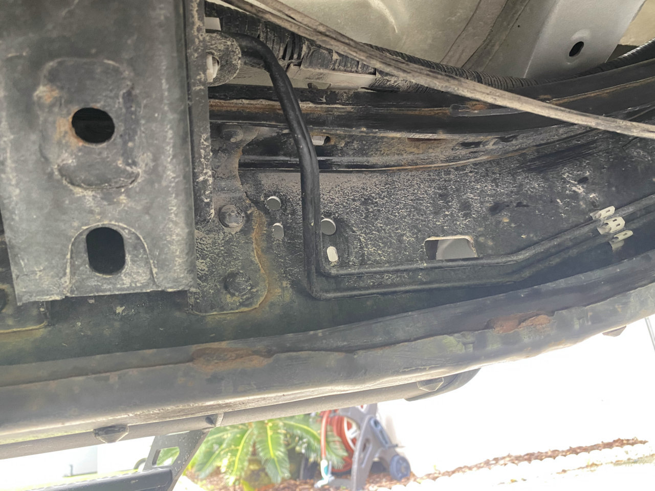

    tiogajoe

    I have my truck sprayed with Krown yearly. About $150

    I live in WI and coated the underside with black woolwax when new. This is the rust belt and so far for 2 years now there is no rust on my underside. It's was a bit of work coating it the first time, but touch up coating yearly is not too much trouble. There was a place in Illinois that quoted about 5-600 to do it for me but I opted to do it myself. You don't say where you live, but if it's in the rust belt, I'd be using something to protect the underside. If it were me I'd wire brush and paint all that rust that has started. These trucks are worth too much to let rot away. If you let the body go the reliable drivetrain and other components won't do you much good.
    Thats my 2 cents.

    If it was my truck I would definitely try to get a handle on that rust now before it gets out of control. I would wire brush the heavy stuff, then hit it with a rust converter like Corroseal. After that, top it off with your favorite non-rubberized rust inhibitor and you should be good to go. I used Amsoil Heavy-Duty metal protector twice, and after 3 New England winters, it still looks great. Good luck :thumbsup:

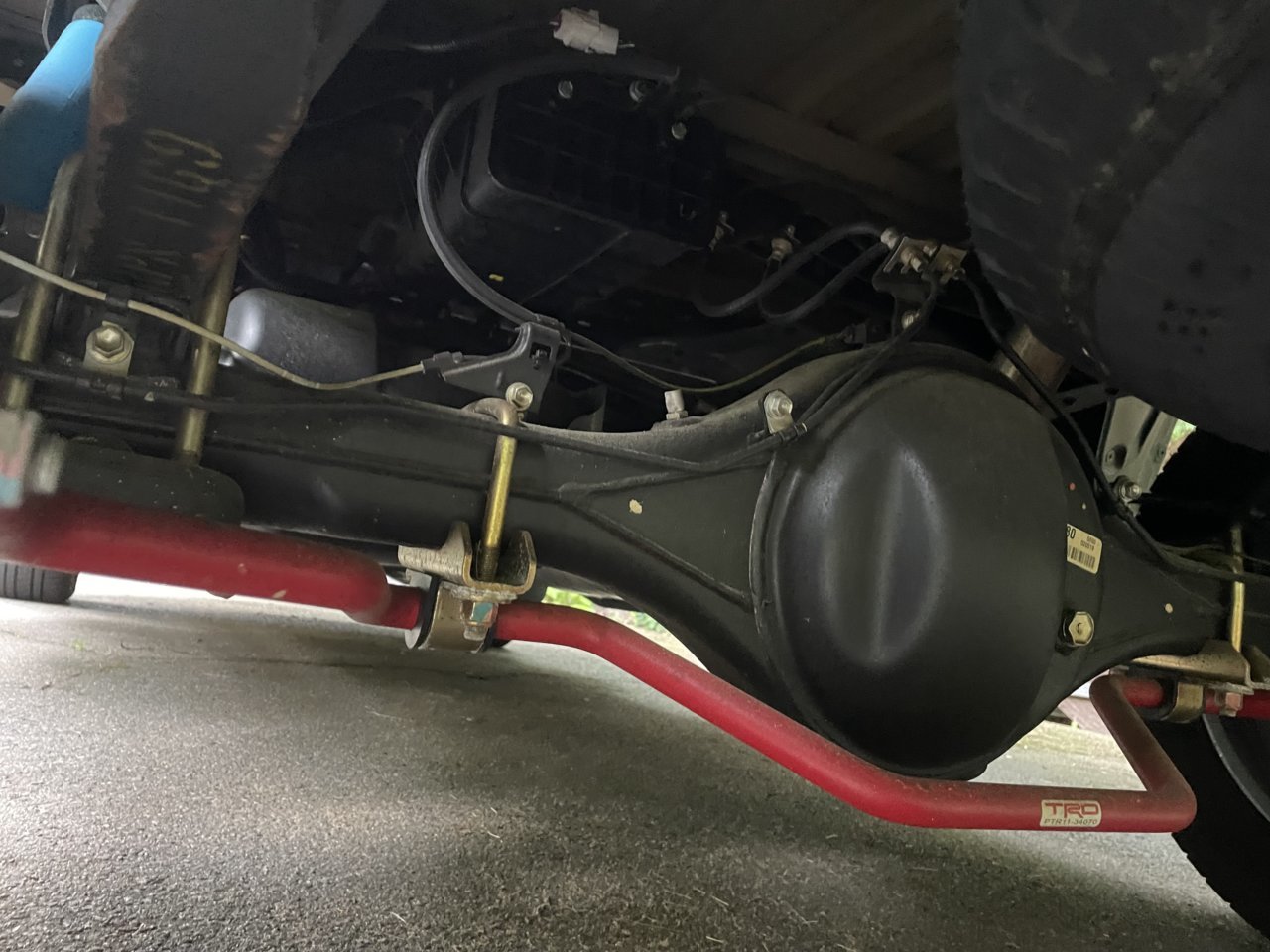

    Thank you for the replies!
    I live in Tampa, but my Tundra was in PA for 2 years.
    If I were to follow the suggestions given here, how do I get rid of the rust I cannot reach with the wire brush? After I get what I can with a wire brush, is there a liquid I can spray that will get the rust areas I cannot reach? This is one of the reasons I thought about paying a shop to do it. Would Corroseal accomplish that?
    Also, I'm looking on Amazon for the products you mentioned. I'm assuming I would need a full gallon of Corroseal, right?
    How many cans of Amsoil Heavy-Duty metal protector would I need? I see 15oz and 8.75oz cans but I dont see them on Amazon, only on the Amsoil website.

    Since you live in Tampa, that's a big plus for you. There are lots of spray rust convertors other than Corroseal that come in regular rattle cans that you can use also which would probably be better to hit those hard to reach areas. I used like 6 or 7 of the big cans of the Amsoil, that was enough to do the complete frame, drivetrain, and undercarriage. Its a slightly smelly job, but once done, you won't have to worry about it for awhile.

    I did my truck right after I bought it new, so I really didn't have to address any rust issues before applying. Amsoil dries to a waxy film and does not wash off like some of the other protectants. There's lots of different opinions here on which one is best, but I had really great results with this.

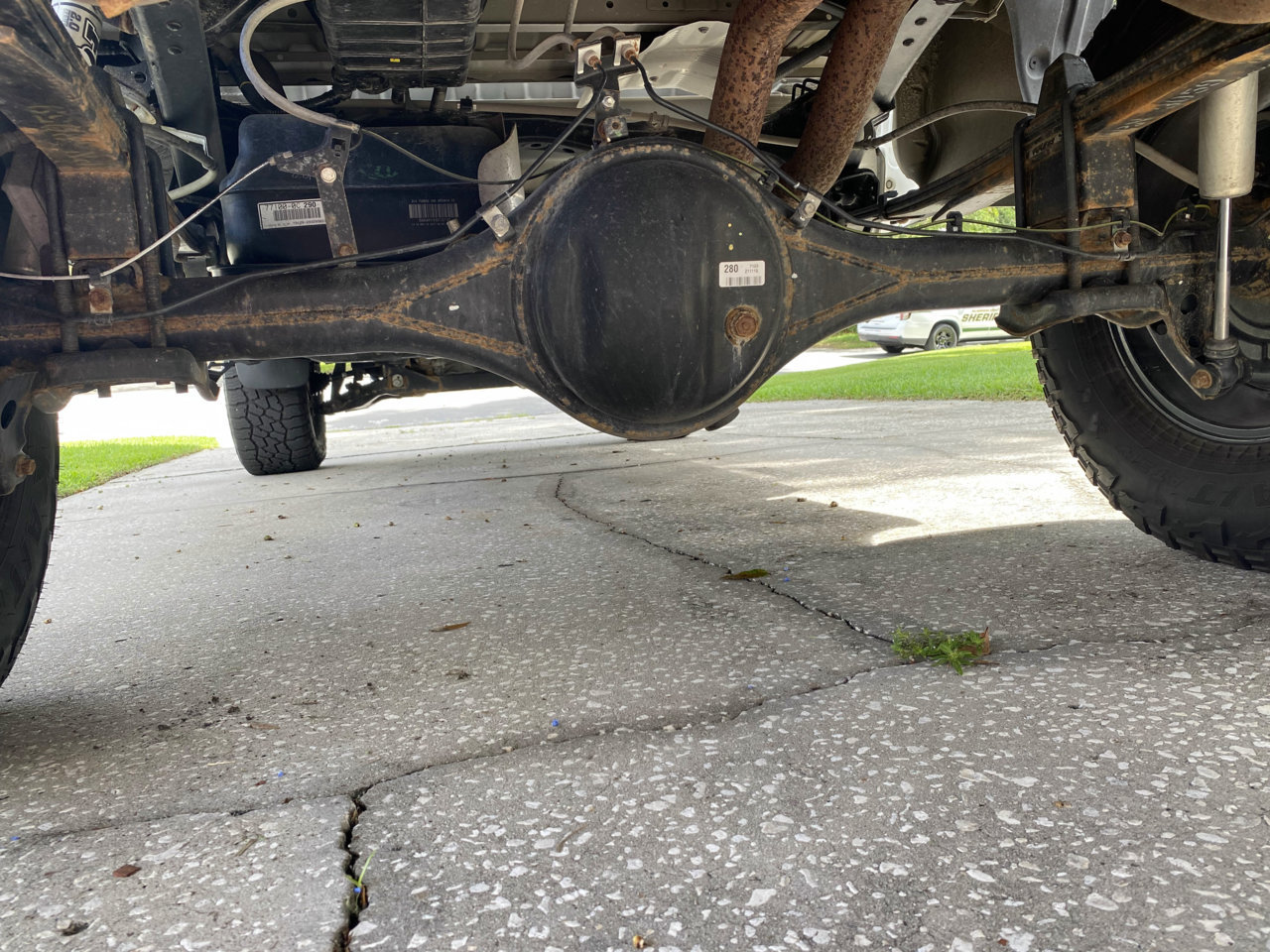

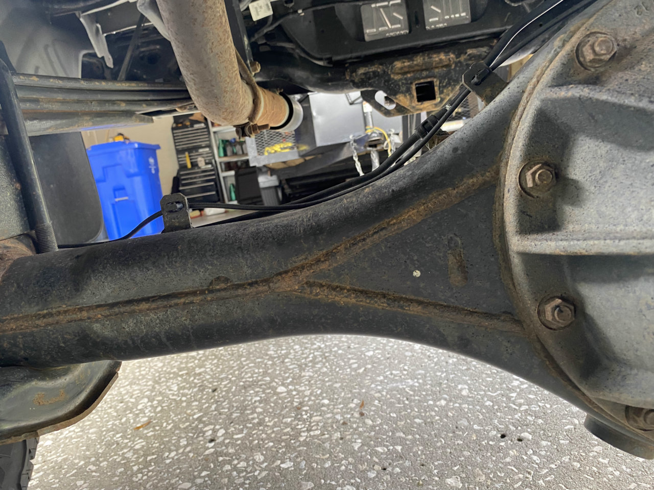

    Seems like alot of rust for a new truck..

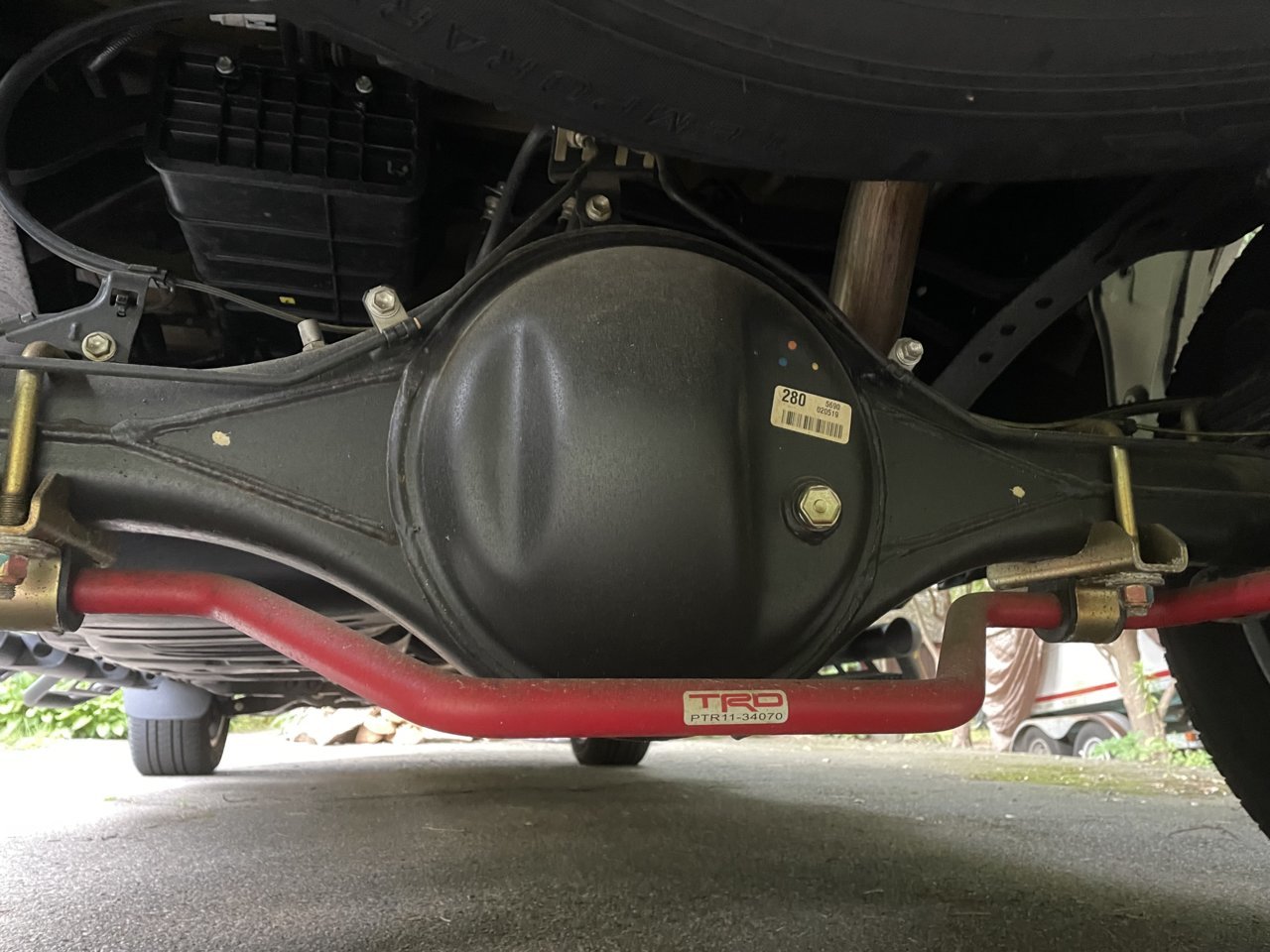

    Here’s my 18 with 90k

    As mentioned - wire brush and a quality protectant. Clean it off (it’s just surface oxidation based on photos) protect and monitor after 3 months and again at 6 months.
    It’s not bad and should be protectable - but yes - even for Midwest salt covered winter roads - that’s unusual. Truck may have been exposed to to deeper water for an extended time at some point - off-road by prior owner potentially. I don’t think flood vehicle or anything like that - but definitely looks like it might have been wet a while.

    I say your fine with a little preventative maintenance - unlikely to see any recurrence. If you clean it up and it comes back / time to let a local pro opine on the issue as there’s something else going on.

    I've ordered the items I need to begin tackling this project. The items will be here in a few days. In the mean time I took a wire brush and started cleaning. Granted I don't have the wheel wire cup brush set for my drill yet. I'm sure that will be much more effective than wire brushing it by hand. After wire brushing, then wiping down with a CLR soaked rag, here is what some of the sections look like.
    If you zoom in, you can see some tiny rust area near the silver dollar washer(?) and up real close near the heads of the bolts. Also there are some nicks in the paint which have slightly rusted. But most of this area was covered in what appeared to be rust "dust" for lack of a better word.
    There are some areas, mainly corners of metal, that are going to need the drill bit attachment wire brush to be used.
    There are other areas that have slight rust or "rust dust" that I am just not going to be able to get to by hand. They are in tight corners where I my hand, a wire brush drill bit, or a hand held wire brush will not fit.
    How do I tackle these areas? Am I able to spray Corroseal on it? I saw a youtube video showing how to spray liquid Ospho from a bottle, into tight corners.
    But I'm hearing Corroseal does a much better job that Ospho. Does Corroseal have to be painted on, or can it be sprayed on also?

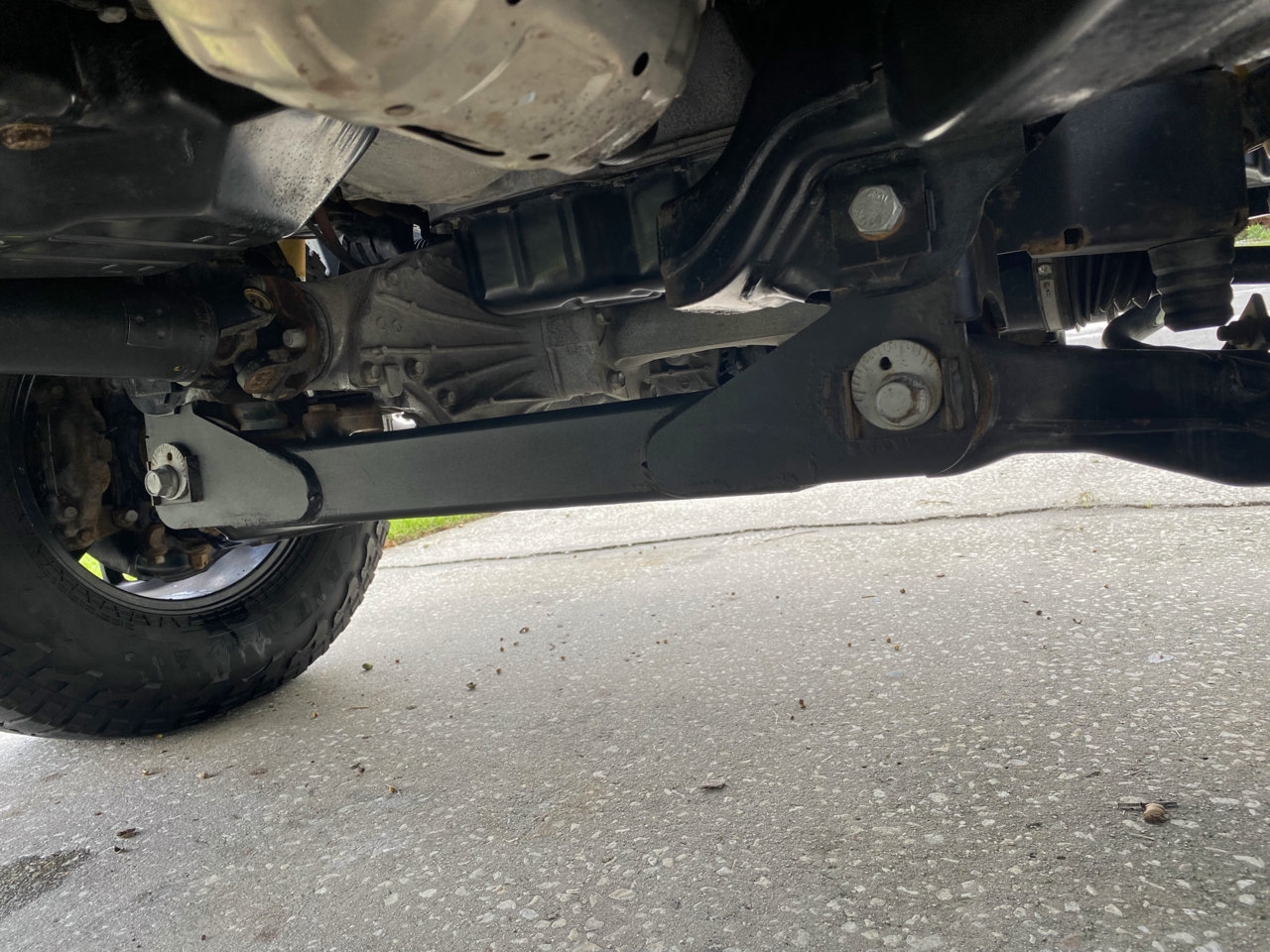

    I had light surface rust on my 21 purchased november 2020.
    Last fall, I lightly brushed the rust, applied The Must for Rust and let it dry. I hit it with rust oleum rust reformer and then with the CRC Marine inhibitor.
    There are a ton of reviews and videos out there for the DIY undercarriage rust prevention (from cooking oil to thick muck, and everything in between).
    The CRC marine did well through the mid Atlantic snow belt and over salted roads. It dries solid and holds up to power washing. It doesn’t feel sticky to the touch but it’s not trapping any moisture like the thick stuff that rusts away from the inside.
    I only needed 1-2 cans of both the rust oleum rust reformer and the Crc marine 10 oz.
    I’ll definitely be touching up and reapplying as necessary this far. 2AA9631E-3F65-4315-8191-591E889C838D.jpgBFA65E7D-6AA2-4EFA-A774-8463D2D55137.jpg

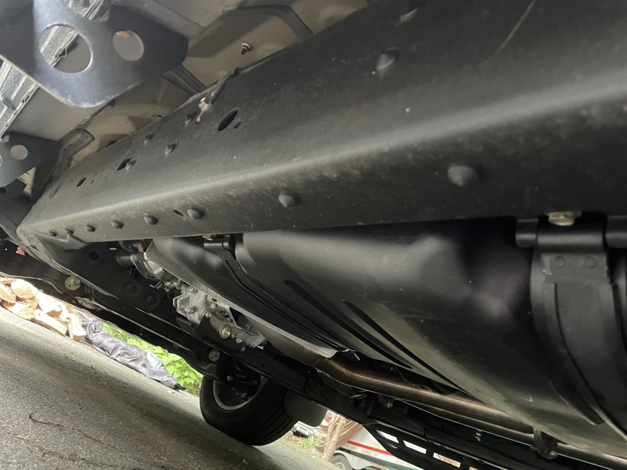

    I can say my ‘16 which was a nj truck then to me here in pa.. looks nothing like this. I haven’t done any preventative maintenance either. I will be starting to do that this year though. As others said I would get ontop of it with the products previously listed and enjoy the truck
