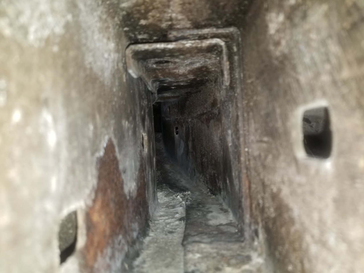

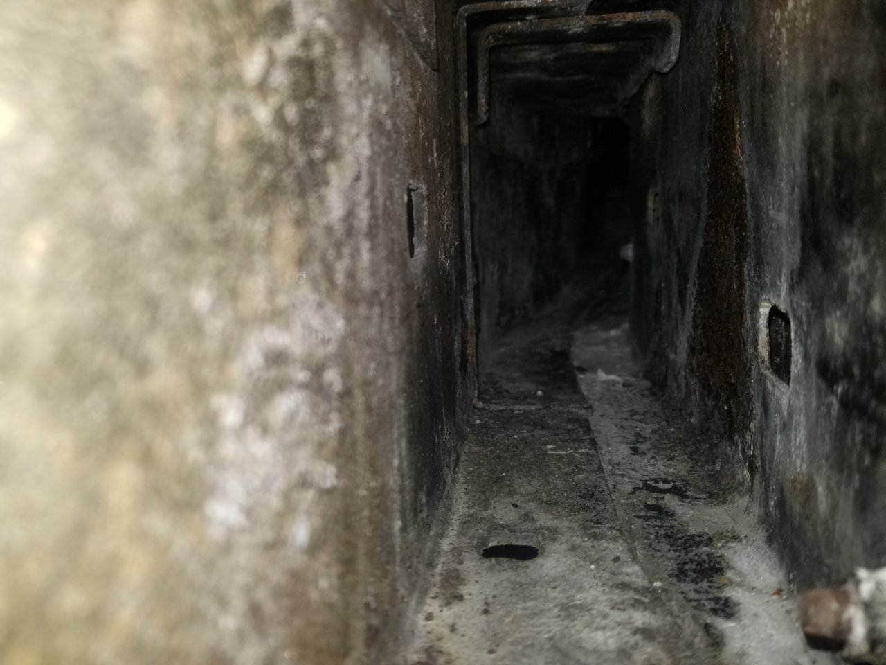

    Ok so after looking inside i feel a bit better about the rust hole. The rest of the frame looks good from what i can tell.
    These pictures are from the inside on the frames rails by the transmission mount.

  8. Dec 6, 2019 at 3:40 PM
    Professional Hand Model
    #14878
    14,987
    Fred
    Hand Protectors
    Squirt some PB Blast up in there and all in those holes and then plunge as much grease as you can after the PB soaks in for a few days.

    2002 AC TRD 4x4 V8
    Why is the frame that color? Never seen anything like that.

    That's the color it turned after I sprayed a bunch of ospho in the frame rails.
  12. Dec 7, 2019 at 6:43 AM
    #14878
    14,987
    Fred
    Hand Protectors
    What technique did you use to get it in there?
  13. Dec 7, 2019 at 6:47 AM
    ogreman72
    ogreman72 [OP] New Member
    Dec 4, 2019
    #39518
    9
    Erik
    TX
    2000 Tundra SR5 4x4
    I poured it into a spray bottle and sprayed it into the frame rails start behind the transmission mounts. I also hit all the opening in the frame.
  14. Dec 7, 2019 at 12:37 PM
    FirstGenVol
    Dec 13, 2018
    #22934
    14,640
    East TN
    2002 AC TRD 4x4 V8
    Smart move. To Hand Models point, I would put something on it to protect it. It really doesn't look that bad though. I've seen way worse frames.
