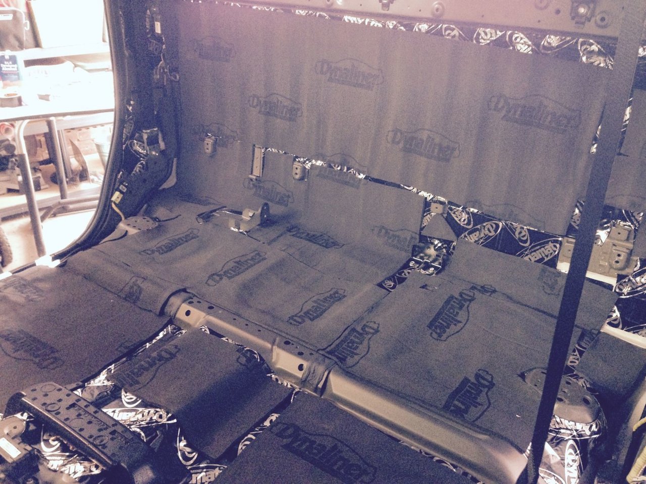

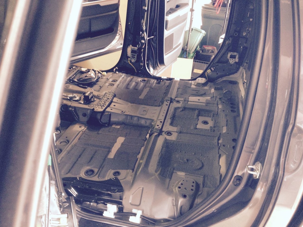

    If you want to go all out, sound deaden the rear wall and floor..:eek2:
    Took an entire weekend but it was worth it..
