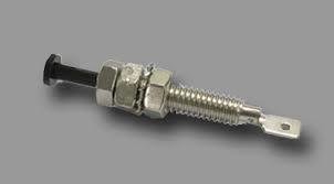

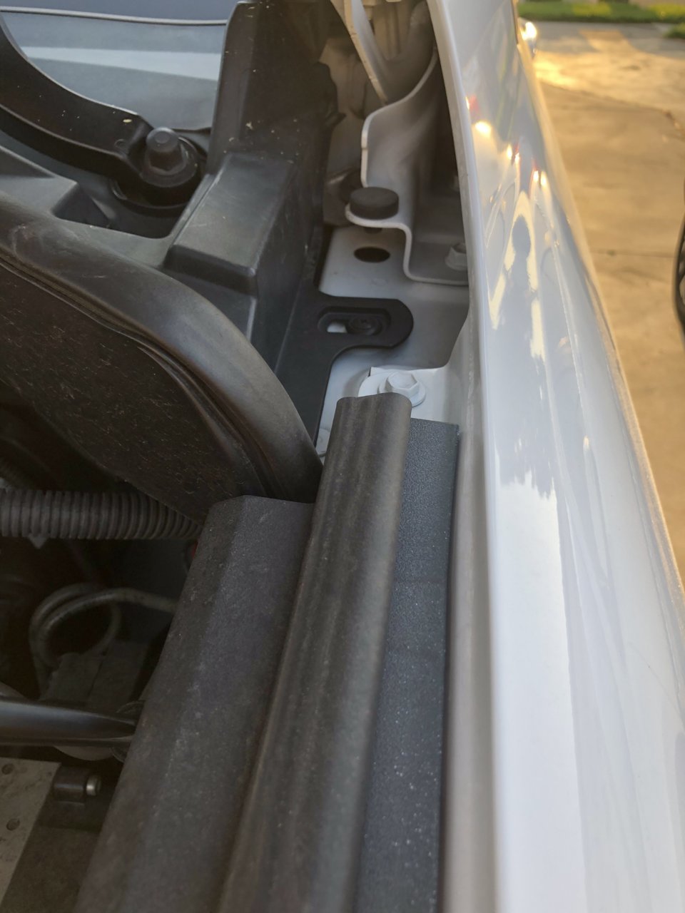

    Hood pins are usually look like this an get pushed down by the hood itself. Look around the edges in the engine bay, usually at the front. 85C5D8D2-14CB-4147-978D-B8B015DB4441.jpg

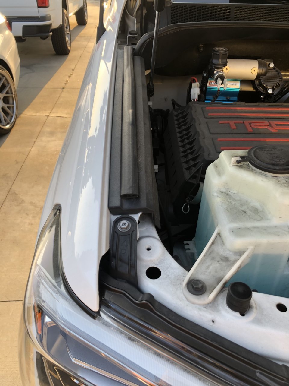

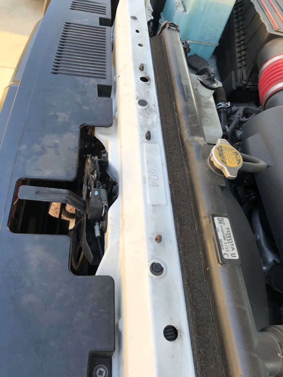

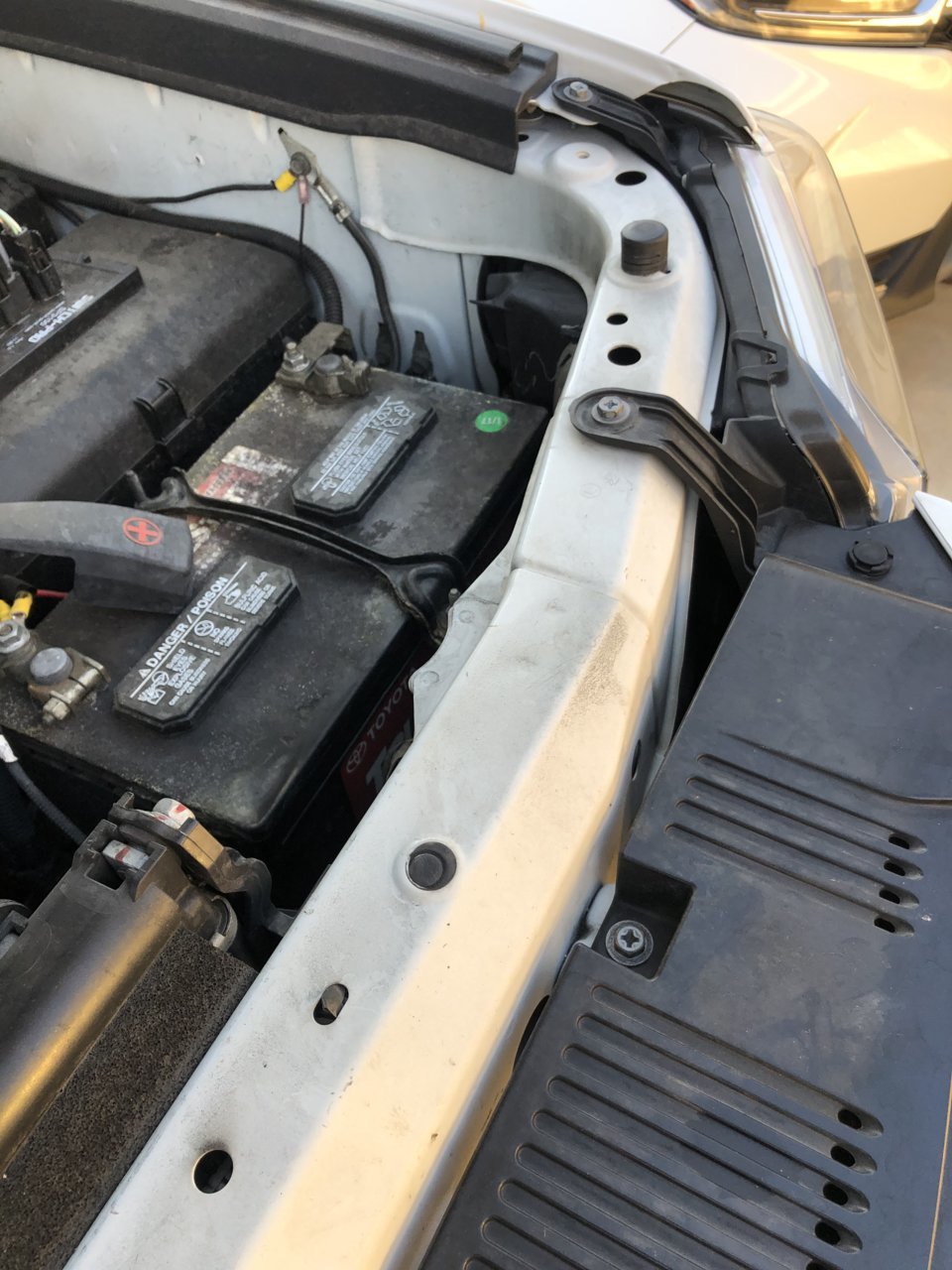

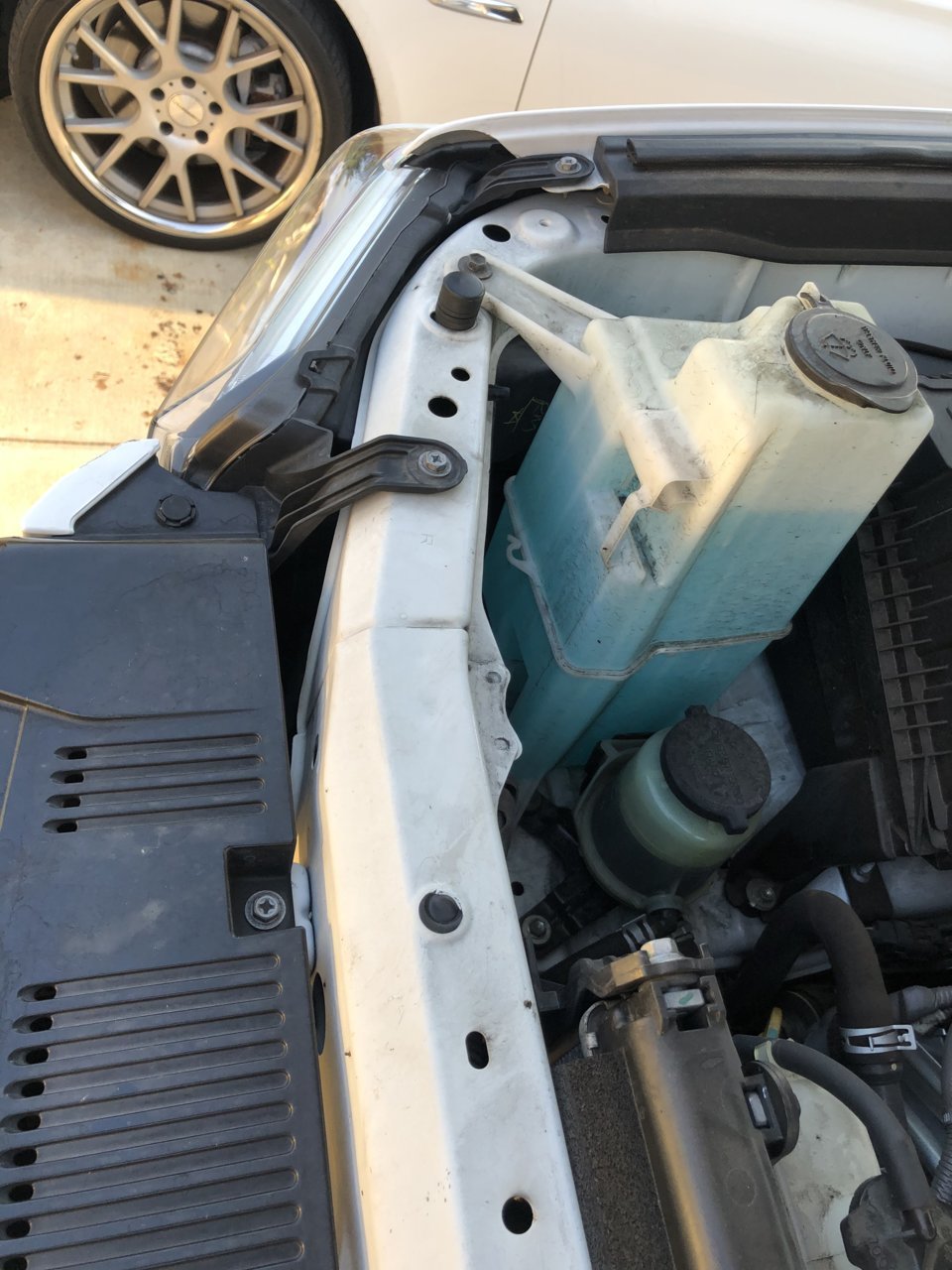

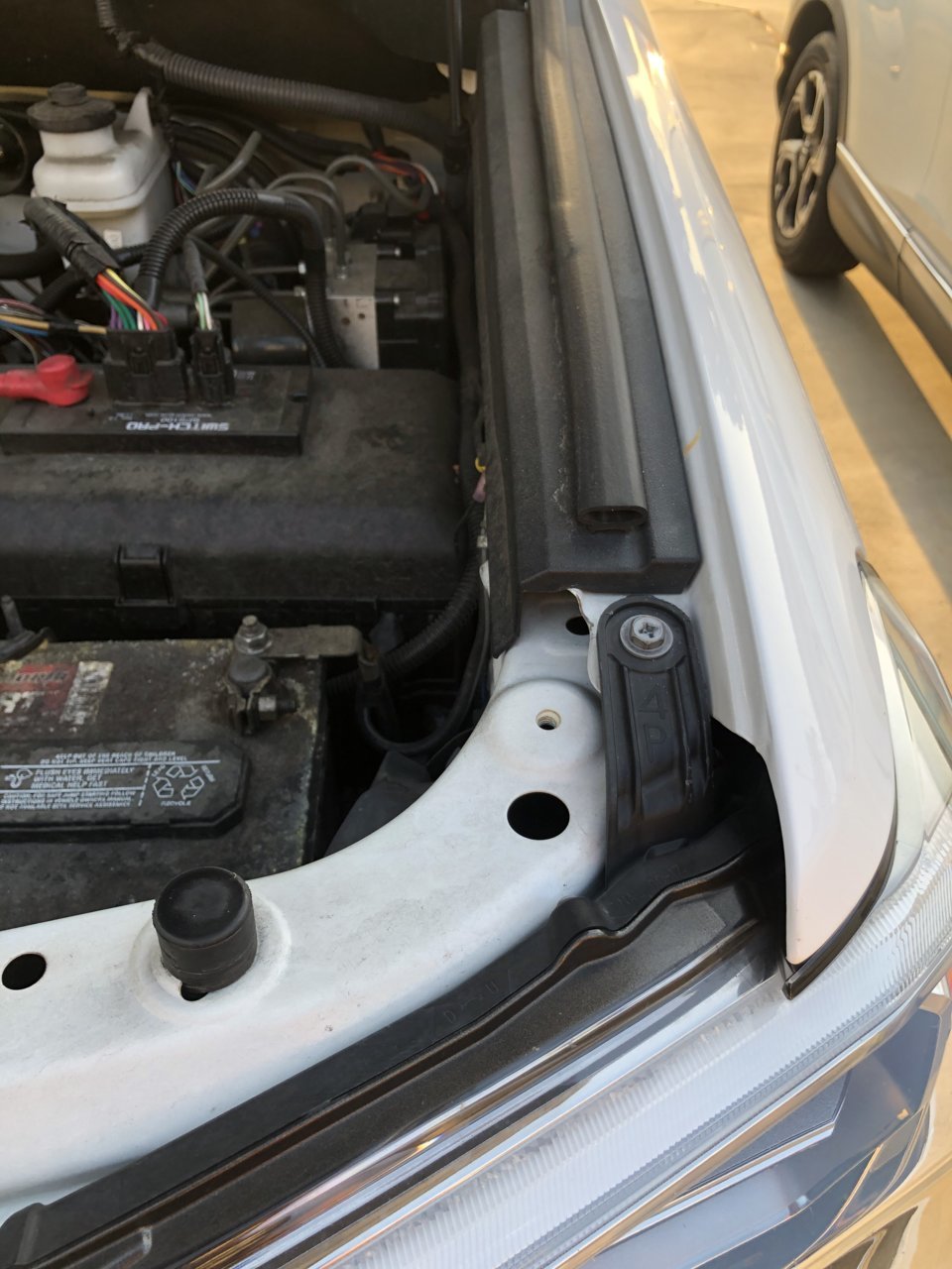

    Take a bunch of pics of the sides and front of your engine bay and post them. Let the self isolated help spot the switch.
  7. Apr 3, 2020 at 6:37 PM
    Young80i
    Young80i [OP] New Member
    Sep 11, 2017
    #9593
    362
    Kyle
    Garden Grove CA
    2015 Platinum
    Here you go
  8. Apr 3, 2020 at 6:39 PM
    Young80i
    Sep 11, 2017
    #9593
    362
    Kyle
    Garden Grove CA
    2015 Platinum

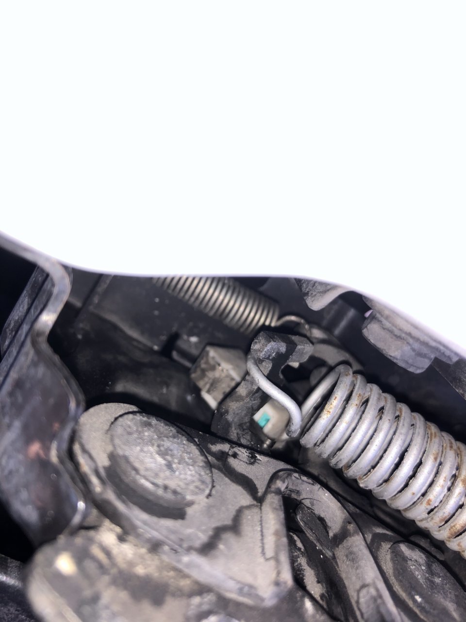

    I can see the latch have a switch
  9. Apr 3, 2020 at 6:46 PM
    mountainpete
    mountainpete Explore more
    Oct 24, 2018
    #20928
    2,650
    2018 Cement Crewmax TRD
    Function before sparkle.
    They must have used the latch switch. This video shows the connector.
