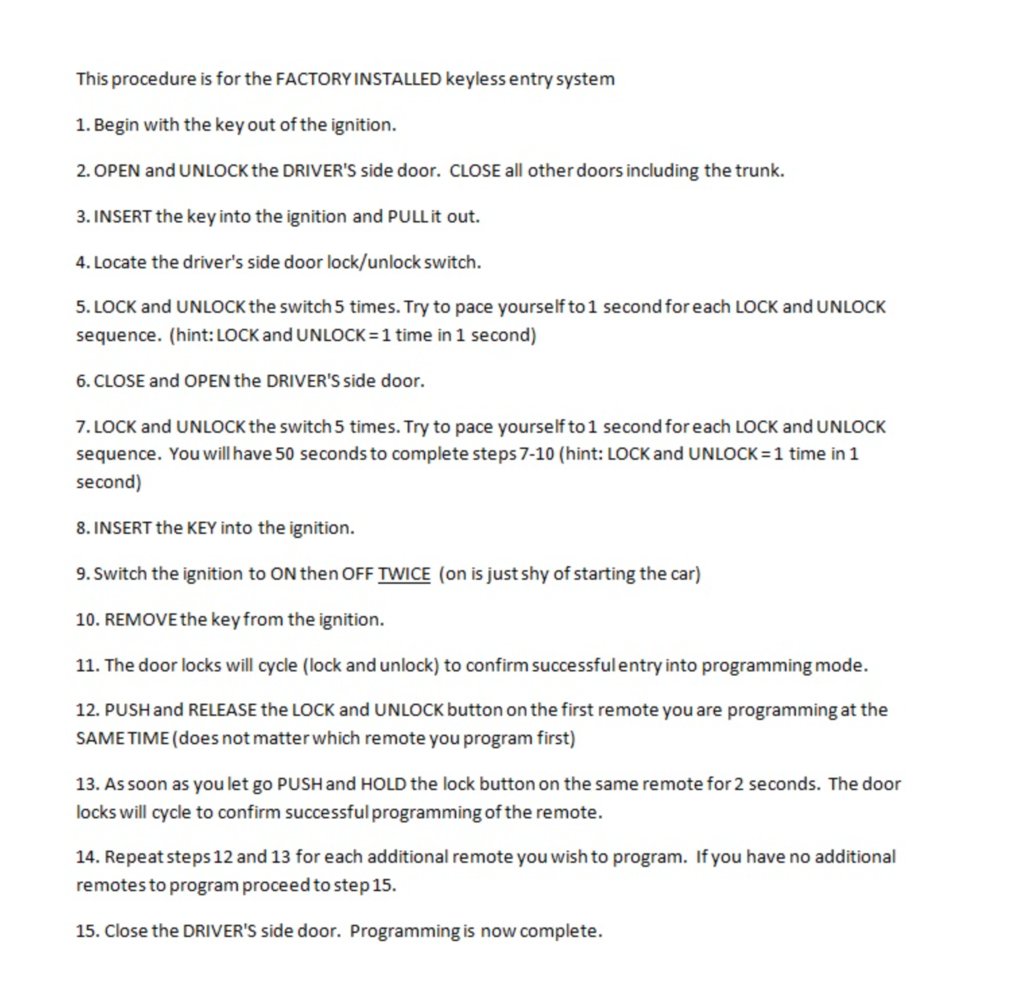

  19. May 5, 2019 at 4:03 PM
    Professional Hand Model
    #14878
    15,007
    Fred
    Hand Protectors
    Acatlin96 likes this.
