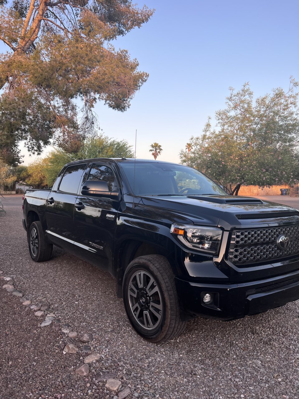

    Here’s a pic of her now, currently all factory.
