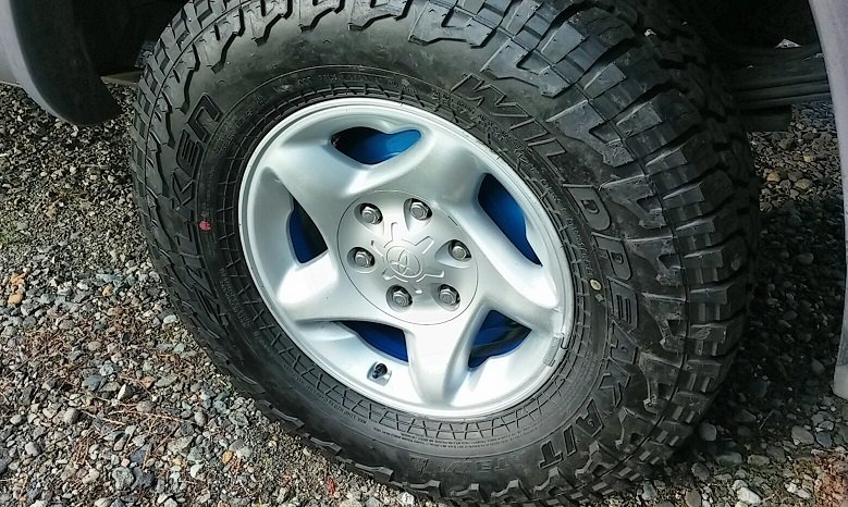

  24. Oct 29, 2019 at 3:50 PM
    #24
    marbleville
    marbleville Agent Provocateur
    May 2, 2019
    #30007
    406
    Yep, last name too.
    State of Confusion
    2002 Thunder Gray Metallic TRD.
    Air freshener died, washer fluid empty, wipers streak.
    Oh, and the Wildpeak looks good, too.

  25. Oct 30, 2019 at 8:19 AM
    #25
    SC T100
    SC T100 [OP] New Member
    Jun 7, 2019
    #31593
    135
    2005 Toyota Tundra Double Cab 4WD
    Rancho Quicklift/RS9000XLs, Rancho rear 1.5" blocks with RS9000XL shocks in rear, SuspensionMAXX extended sway bar links.
    They do! I've seen some recently. I just wish they had them with outlined white letters (not that letter color is a make-or-break for me).
    Rica25 likes this.

  29. Oct 30, 2019 at 10:34 AM
    #29
    SC T100
    Jun 7, 2019
    #31593
    135
    The do look nice (and the chunky sidewall sort of makes up for lack of white letters...gives it some texture), and more aggressive in person than pics show IMO.
    Cacoleman2014, marbleville and Rica25 like this.
