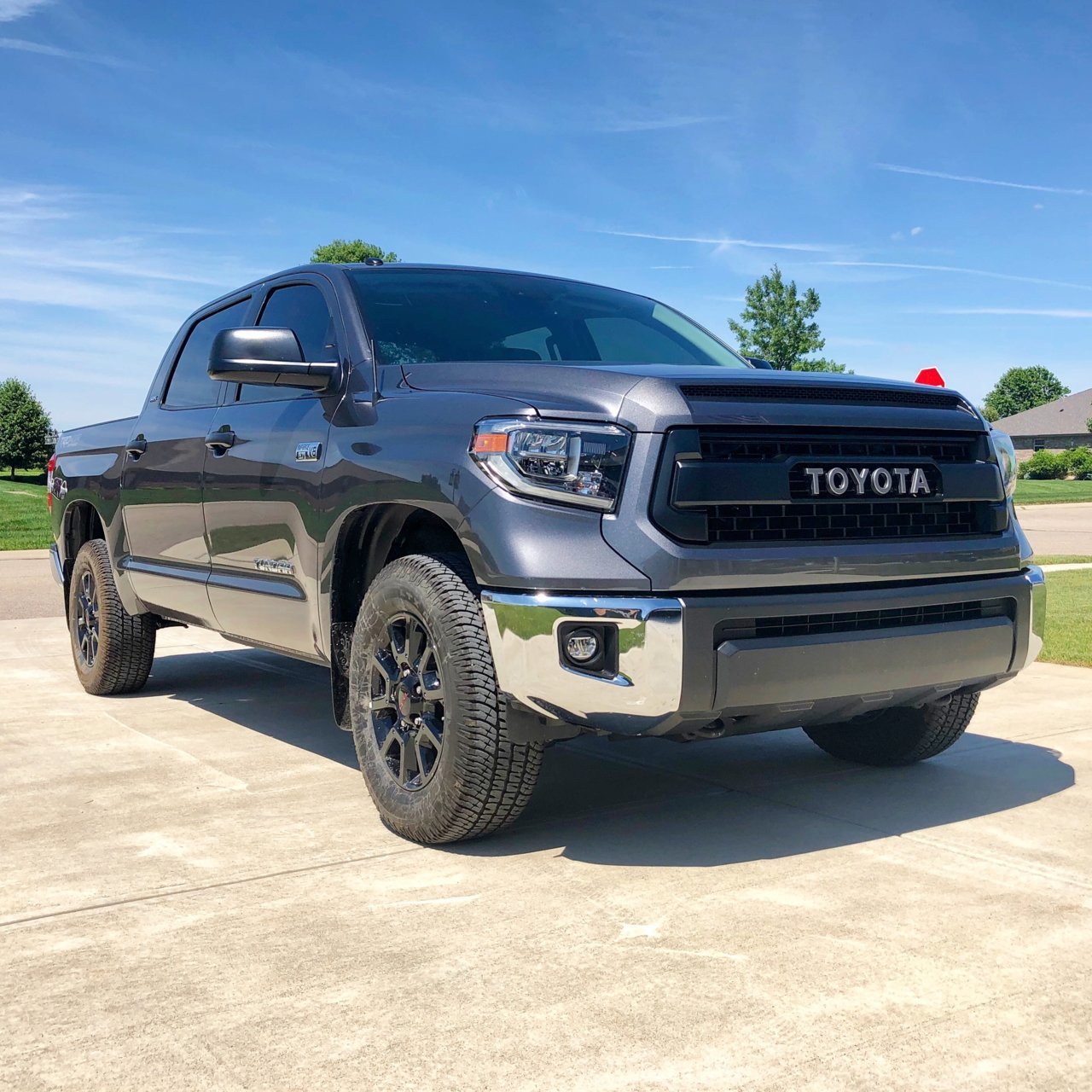

    Just wanted to give a shout out to the Jomax website. I recently installed their TSS sensor relocation bracket on my 18 to allow me to install my raptor grille. Piece of cake to install, no error codes thrown, and the sensor still works as expected! Hit them up here to get one!

    Looks good and nice to see there I'd a functioning option for people finally, so many brackets seems to have come and gone and failed. I like the grill too but it needs some TOYOTA love up front.

    Yeah I bought letters also, but due to where the sensor is I cant put them on or they will block sensor..

    I'll second the quality of Jomax's product and customer service! I did a 2017 Pro grille swap on my 2018. They were awesome with getting me a relocation kit within just a few days, and the quality of the product is top notch. I've been really pleased and have had no sensor issues like I did with the stock grille.

    Yeah the grill is a direct swap, took about 25-30 mins start to finish. You’ll need two pieces to do it, I’ll include part numbers.
    The only thing to remember with the 2017 grille is there is no location for the wave sensor, so that’s the reason for the Jomax relocation kit. I’ve been really happy with it all. Let me know if you have any more questions!
    Hood bulge (MGM) - 76180-0C030-B1
    Grill assembly (MGM) - 53100-0C260-B1

    That grille looks great and I’m not really a fan of the Raptor lights on a non Raptor.
    Side note, I have an 18 Tundra with a 17 Pro Grille. I mounted the tss to the lower part of the grille shell. No problems 1000 miles and counting.
