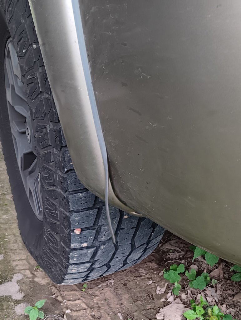

    I noticed some trim around one of my fenders coming loose. Should I go with a basic silicon adhesive, or is there a better substance to use for this?

    You can buy replacement fender flare trim on Amazon, but don't pull that flare off without purchasing new clips because I promise you'll break every single one of them.

    OEM part numbers for that rubber trim: https://www.tundras.com/threads/whe...-cab-1g-part-numbers-help.85577/#post-3920940
    Aftermarket alternative, but only in black, you've got the grey: https://www.tundras.com/threads/wha...-gen-tundra-today.2558/page-2350#post-3921265
    Info on the red/blue clips that hold the flares on **IF** yours are the clip-on: https://www.tundras.com/threads/fender-flare-fix.122536/
    This thread may help on that also: https://www.tundras.com/threads/now-what-took-my-fender-flares-off.74439/#post-2239831
    (some DC trucks used adhesive to hold the flare on, but I don't think those had the rubber seal?)

    So it's better to replace it instead of trying to stick it back on?
