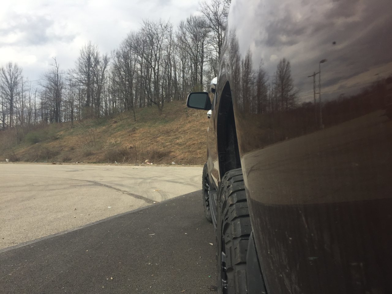

    Just recently noticed that my rear tires stick out different amounts on my truckIMG_2369.jpg
    Rear drivers side

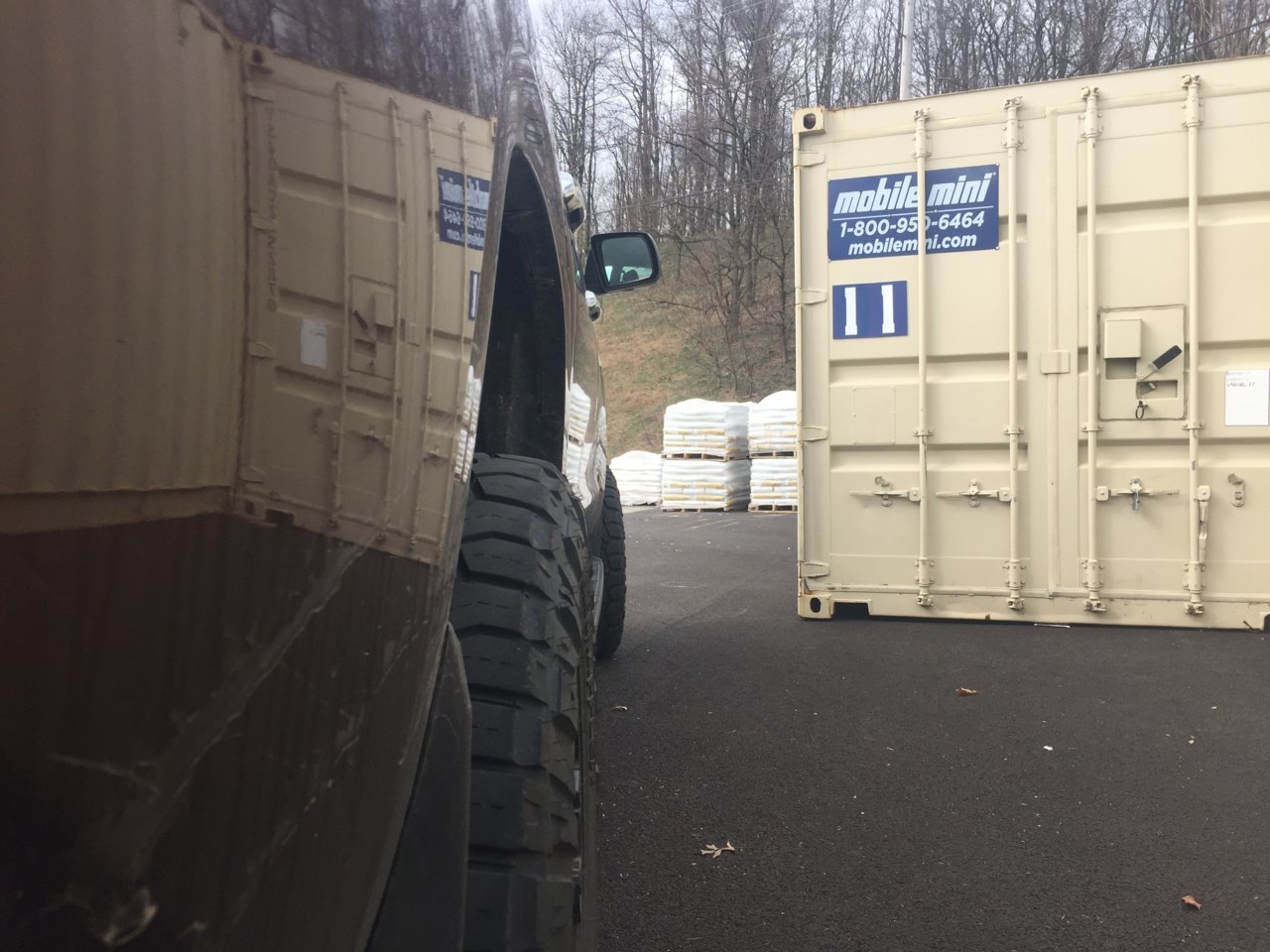

    IMG_2368.jpgRear passenger side
    I haven't had the chance to measure the difference yet but it is significant
    Any ideas?

    completely normal, all tundras have this

    This is normal. All the tundras I looked at my local dealerships lot were like this when I bought mine

    I had some free time tonight so I measured from truck frame to the wheels and both are equal, then got to looking at the bed. After wondering why the axle would be shifted to the right it has been the bed is misaligned the whole time. I’m going to try and adjust it tomorrow
  16. Aug 29, 2020 at 4:12 PM
    JPritch22
    JPritch22 New Member
    Jan 12, 2018
    #12158
    25
    2018 TUNDRA SR5 Crewmax
    Well, I gave it a shot. Took the bed bolts out, lifted bed and shifted it over. Only problem is, they’re not adjustable. To really do it right you’ll have to drill another hole into the frame. I didn’t take the time to do that so for now I’m going to try and forget about it
