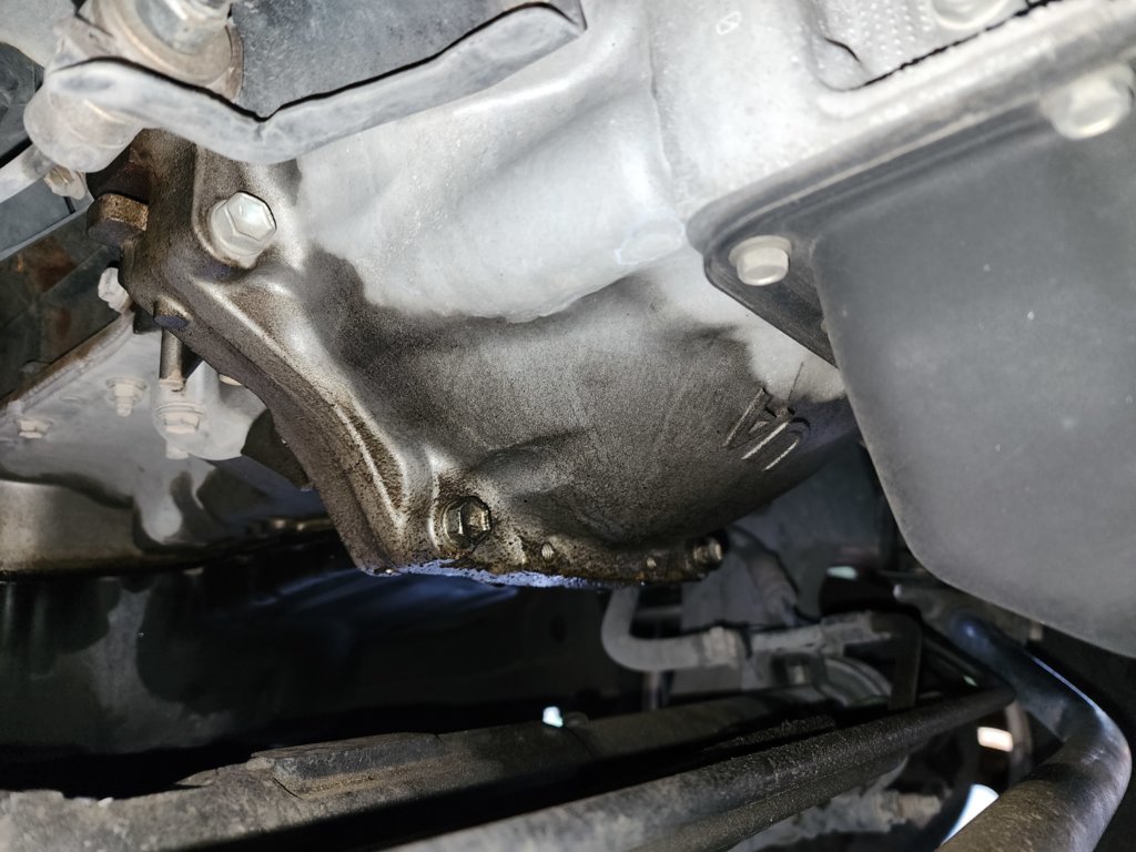

    Here is a picture of what I discovered

    That's a pretty decent size leak to conveniently "miss".
