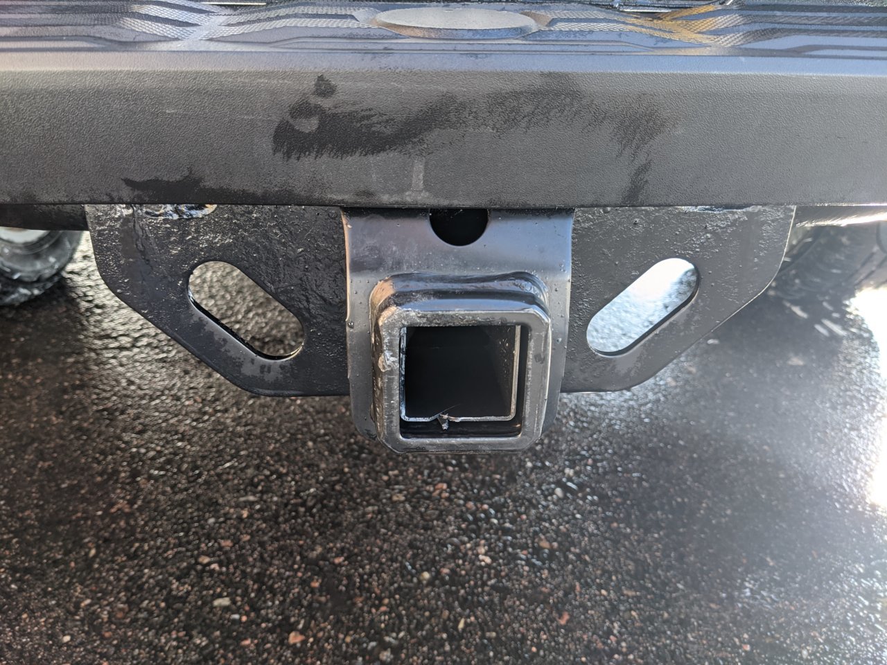

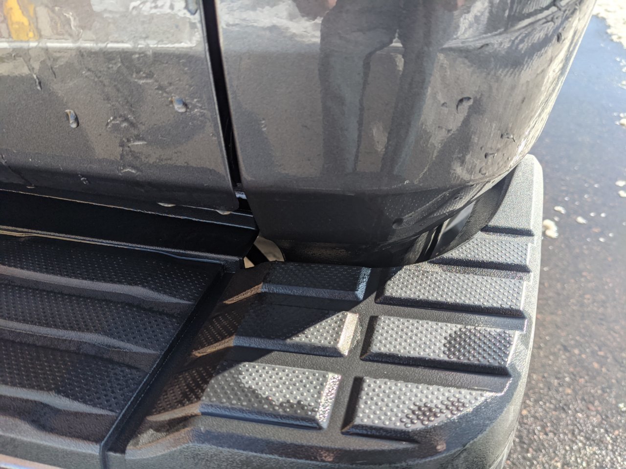

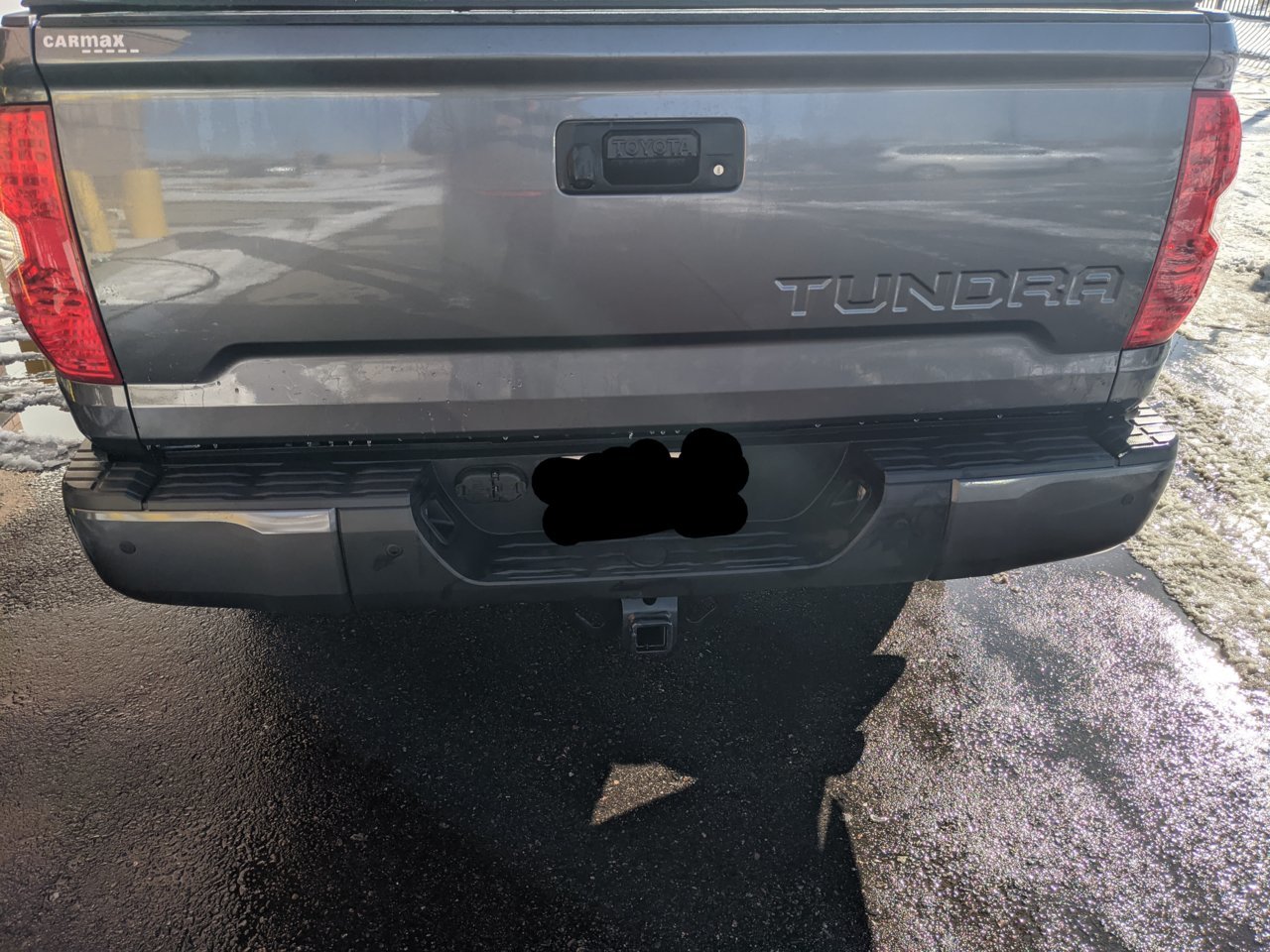

    In fairness the visible damage is minor that's why I didn't post pics previously. But here are a few if curious. The main thing noticable is you can tell there is a difference in gap between bumper and rear quarter panel when you stick your hand in the gaps on both sides. Plus some minor hitch damage.
