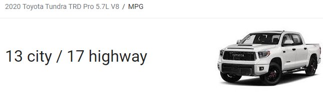

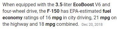

    Just so you can crunch the actual numbers if you would like, here are the different MPGs. Keep in mind that a turbo demands premium fuel, so that is going to close the cost gap some as well. https://www.eia.gov/dnav/pet/pet_pri_gnd_dcus_nus_w.htm Link is for fuel prices by type. You can play with the theoretical MPGs of various trucks and the cost for your predicted annual mileage to get an idea of what your savings per MPG would be for the varying fuel grades.

    I’d also recommend comparing numbers off Fuelly and not just EPA numbers. People claim f150 and Silverado get way better mpg but real world not so much.
