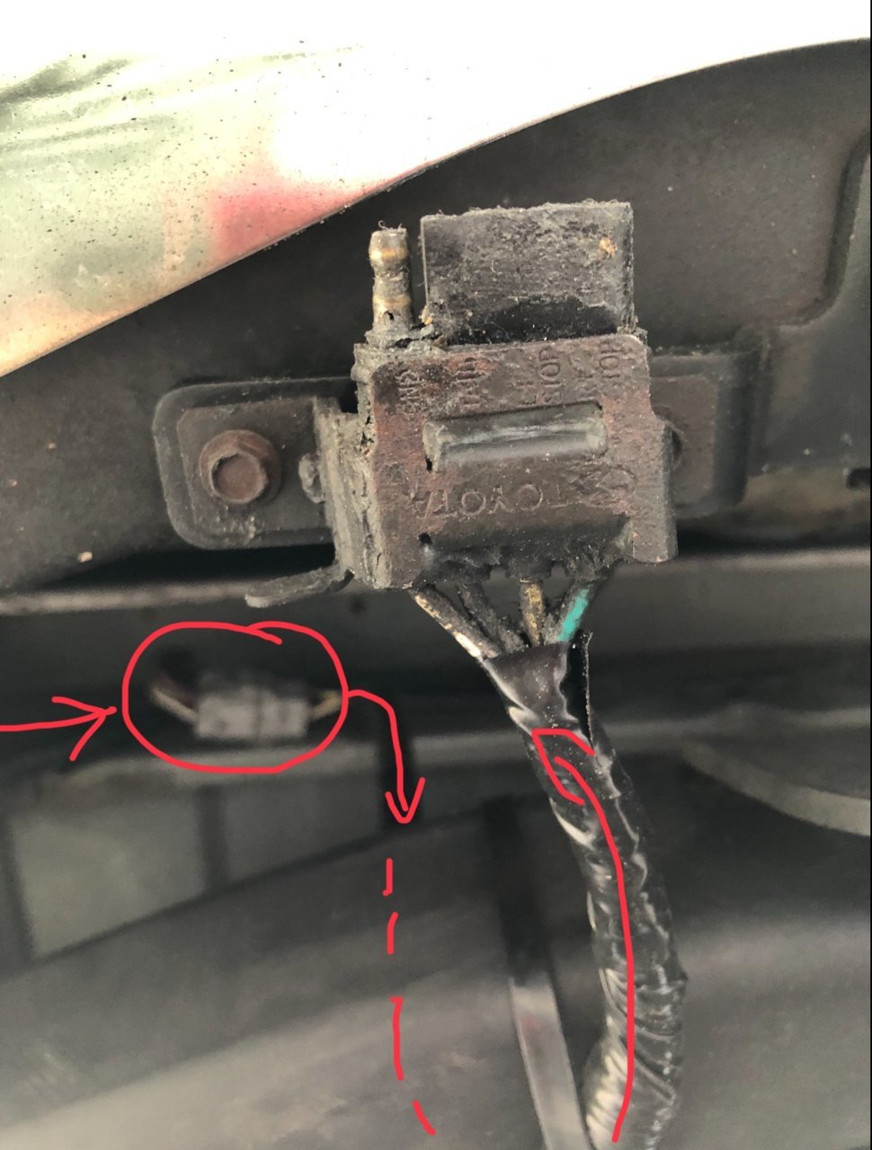

    While checking out the rear undercarriage, I discovered an electrical plug that dead ends into a cap that is mounted to the frame. It is located behind the rear bumper and just to the driver side of the license plate light wiring. (See white arrow in first photo.) This is not the factory plug for the trailer wiring harness because that is much larger and all the way over on the driver side. (Plus we already have a 4-flat harness plugged in there!) I pulled the whole assembly off the frame, opened the cap, and took a photo of the connector and the wires on both sides. I took these photos to the dealership parts department, but they couldn't find it on their diagrams. Any ideas?

    Is there one on passenger side ?
    The one you are showing, is it grey in color or black ?

    This plug is grey and I did not see another one on the passenger side.

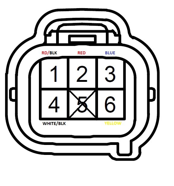

    True....if this was a 4 pin.
    From my seat it appears to be a 6 pin part # 90980-10988
    Toyota colors are usually....
    light blue=right
    yellow=left
    wh/blk=gnd
    red=backup lights
    can't remember red/blk ?

    Yes! That's the correct plug and the wire colors!

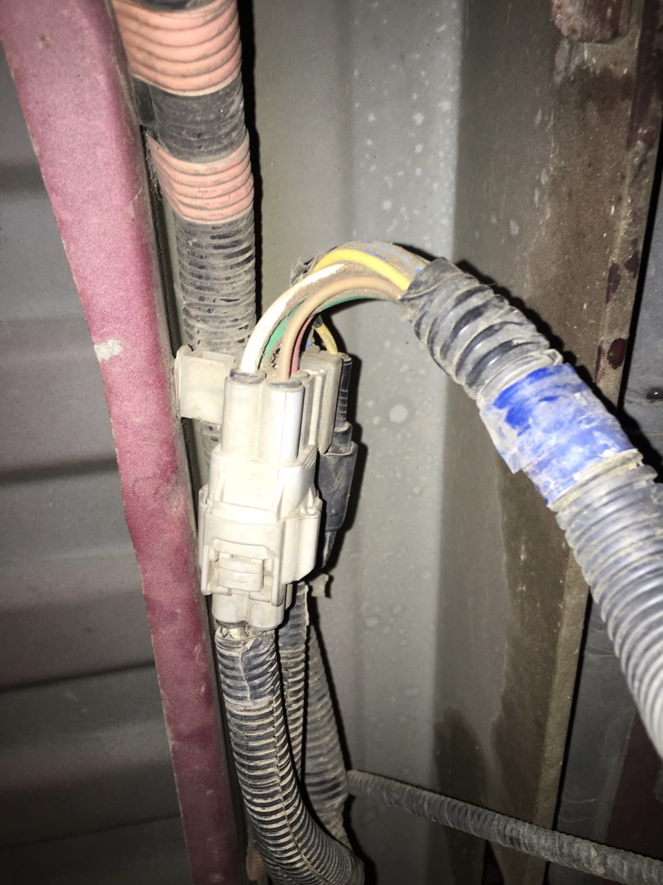

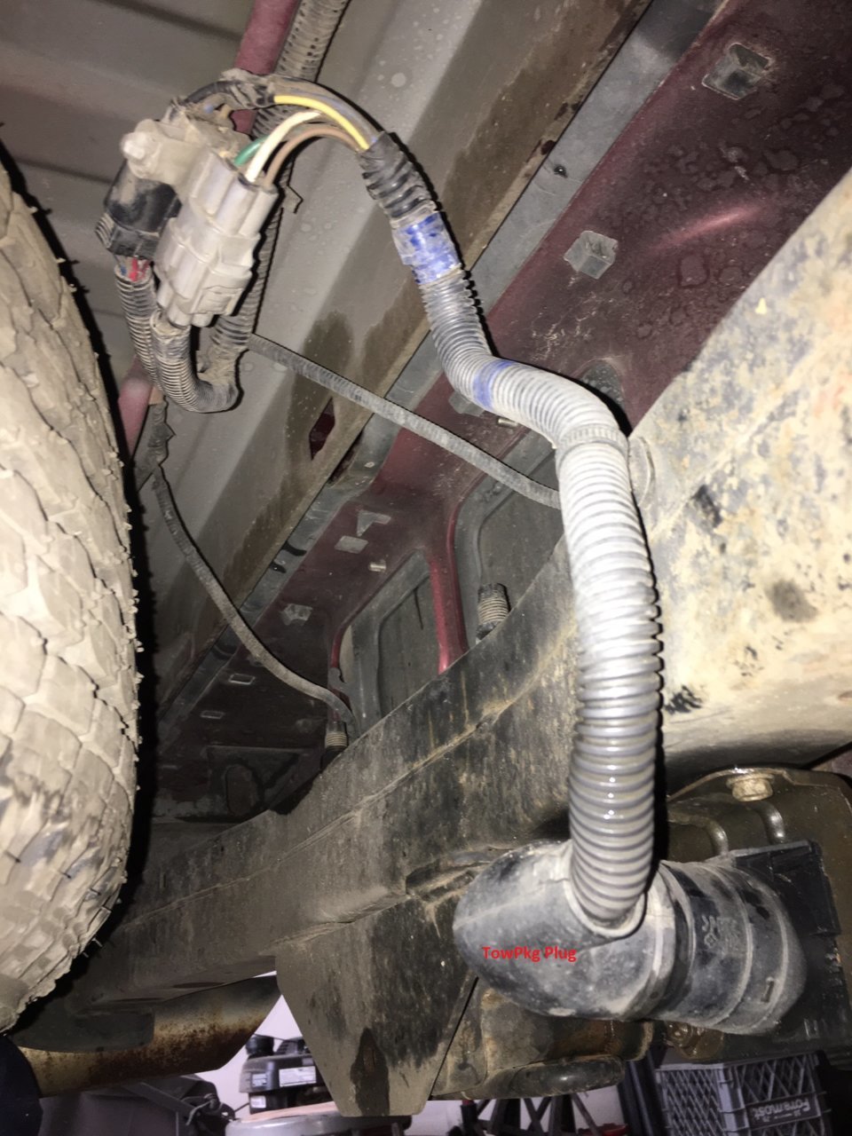

    Similar to PHM, I have Tow Package on 2004 and believe that's what yours could be used for. Wanted to check this earlier but weather sucked but the below pic one is the same location of yours and the second pic is the connectors away from frame showing it going to tow package harness plug.

    Thanks @BubbaW ! Since yours is a later model, looks like you have an additional factory connector beside it to supply the remaining wires required to run a full 7-way plug.
