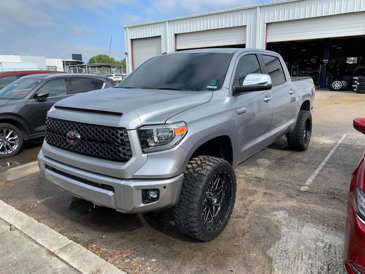

    Good evening, I have been lurking for a while now, I have a 2018 Tundra Platinum with a 4 inch lift on 33X12.5/22 and I LOVE the truck, but there is a rattle when turning in either direction, almost like a heat shield rattle but I don’t think that’s it.
    Any ideas or help? Maybe check something I haven’t thought of yet?
    Thank you for any and all suggestion!

    I have checked that, I seem to have plenty of clearance when wheels are turned sharp in either direction in park, it ONLY happens when turning, otherwise the truck is perfect.

    I thought that too, but I don’t see anything coming in contact with it. I’m going to have to just have someone drive it slowly while I walk next to it and see if I can see anything.

    Went out this morning and the skid plate couldn’t get any more tighter, it was solid when I put my impact on it. I turned both wheels sharp in both directions sitting still and they don’t touch anything......if the rattle happened while driving straight I might suspect heat shield but that seems tight, but it only does it on turns, if I take the turn slow enough no rattle...

    Dust shield behind front rotors. Bent them out of the way. Problem solved.
    Thank you for the help!
