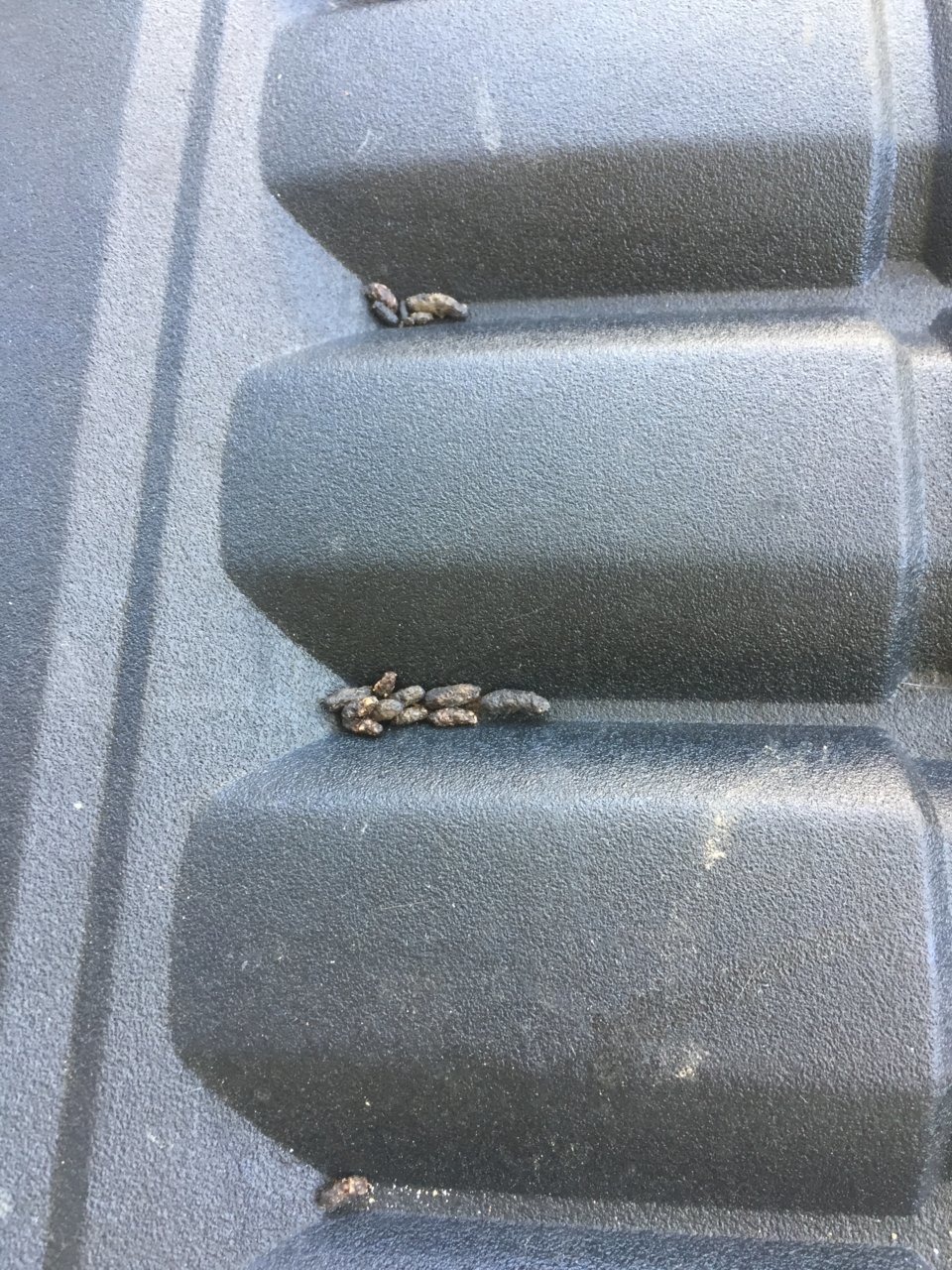

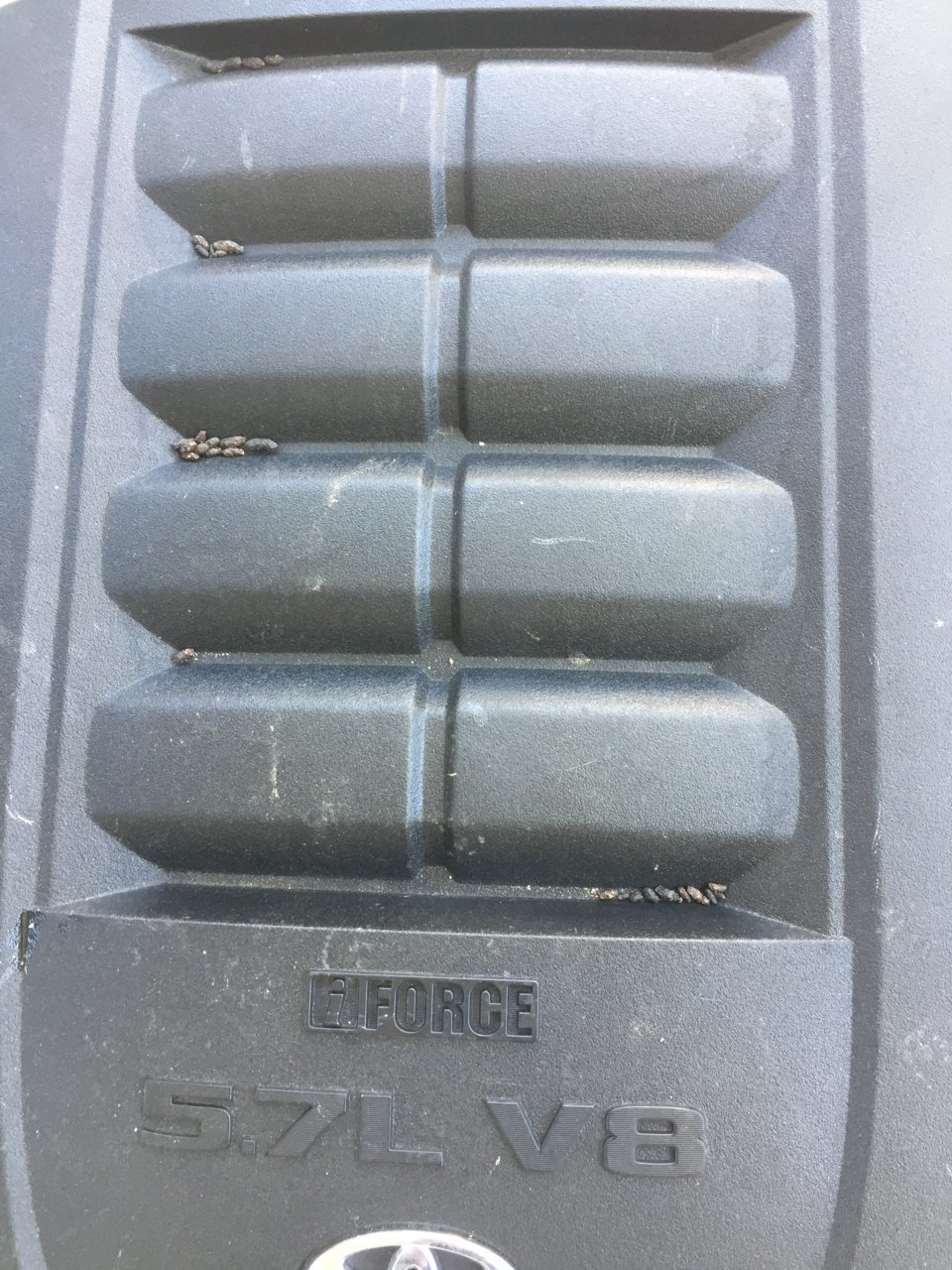

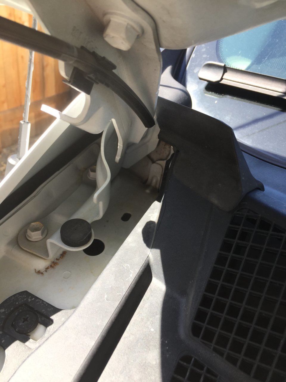

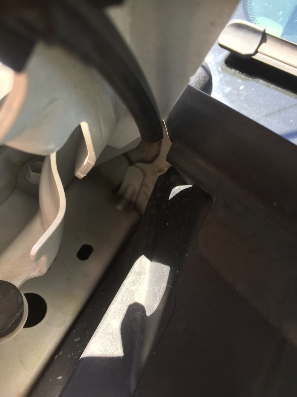

    So I went to spray my windshield wiper fluid the other day and it seemed to not be spraying. I figured it was just empty and needed to be refilled. When I got home I went to refill the fluid and it was full. I noticed the hose to the wiper fluid was cut in half and I also noticed rat dropping on top of the engine cover.
    Option 1: The hose runs right by the hood hinge where it got cut. Do you guys think it just got caught in the hinge?
    Option 2: is that it is a rat or mouse in the engine bay. If so how do I prevent this from keep on happening? I set a few traps around where I parked a while ago and never have they caught a rat. They are tomcat rat traps.
    Any advice will help thanks

    Ok, so I am almost a pro at this, living here in New Mexico. First, they are mice, not rats. Pack rats live away out in woodpiles, debris, ect...Usually it is best to just leave them there..if you uproot them they may move closer...
    2nd,I use mint, boil up a bunch of it in water then put that water in your spray bottle. Spray liberally.
    3rd, mice and their ilk are direct descendants of the mob. They like to have their back against the wall. If you were to open the hood every night (assuming you are out of the elements and feel comfortable) they will never go in there.
    your windshield wiper fluid line does not look like an animal got it. Too clean of a cut.. I have not looked but I would bet there was a plastic coupler or L that connected it to the next line.
