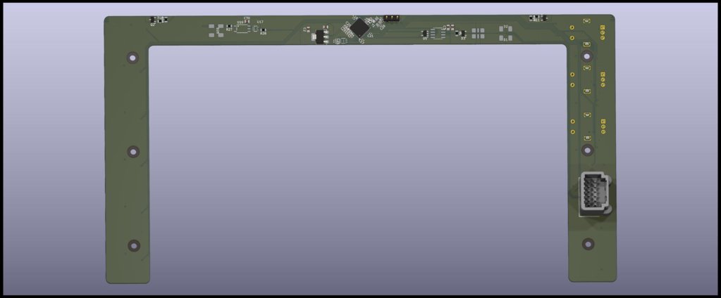

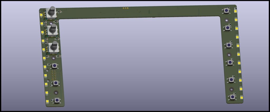

    Had to redo the insert CAD and finally got the nested board completed. It's just a fancy controller for the RPi and an upcoming power distribution relay setup.01.jpg
