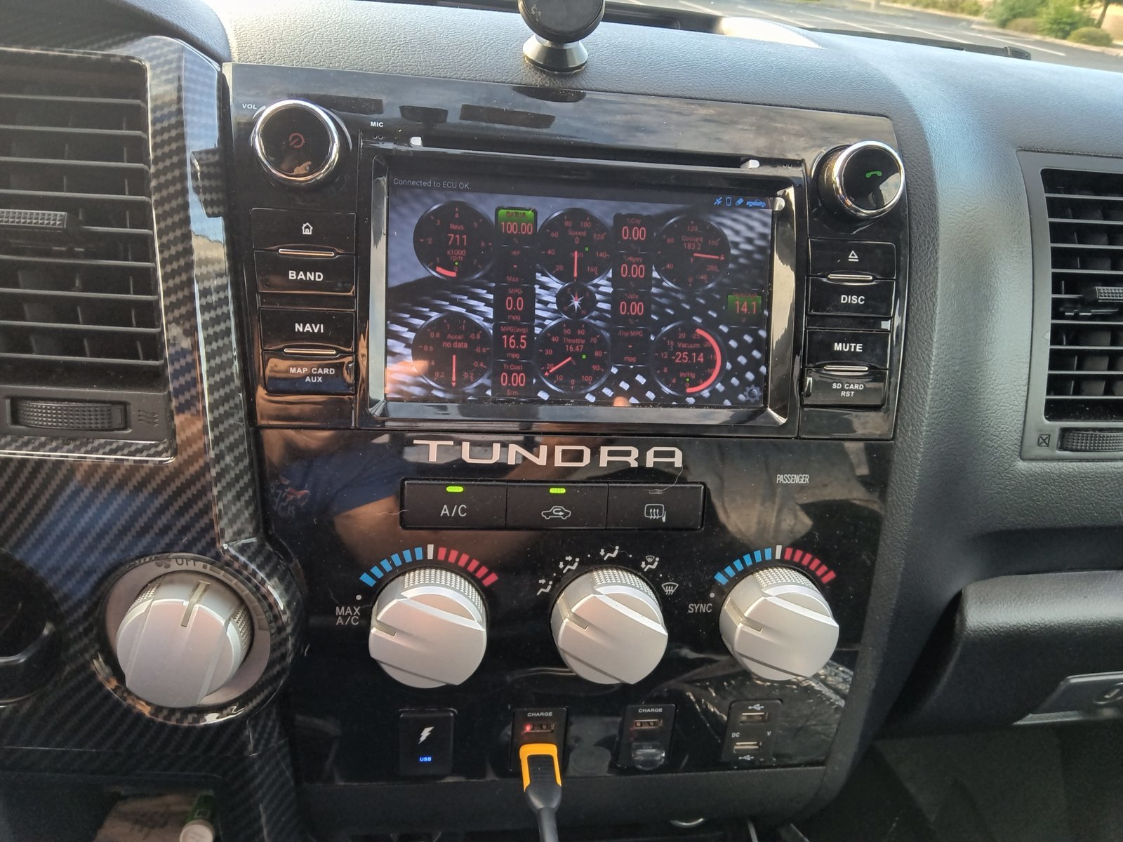

  4. Jul 19, 2024 at 6:21 AM
    wrectundra
    wrectundra New Member
    Jul 17, 2024
    #120013
    2
    willy
    2008 4.7l tundra
    I went w a seicane unit not so great reviews but am really pleased so far have Bluetooth or USB car play including nav even steering wheel module... Wanted a full screen dasaita actually but expensive ... So far really pleased was plug and play except for steering wheel module
