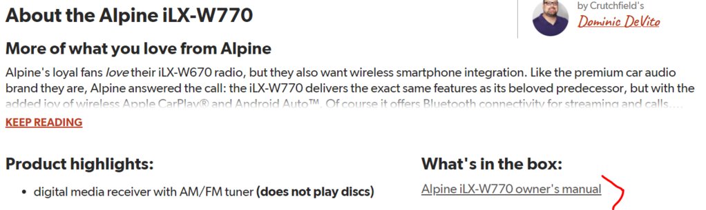

    As far as a switch to trigger the dimmer I'm sure someone smarter than I could figure out how to rig one up, in theory it'd just be putting a switch on whatever wire goes between the headlight switch and the radio dimmer trigger, but idk that might be done via canbus or something not as simple as just a wire. As far as head units go, I think most have the ability to turn on/off the dimmer in the settings. I was just looking at the new Alpine iLX-W770 and it has that ability. Briefly looked at the manuals of a couple others, the Kenwood DMX709S and the Sony XAV-AX3700 and both have the ability as well. Best bet is to go on Crutchfield, pull up the head units page, open the manual, and do a Ctrl + F for "dim" and see what settings the head unit has.
