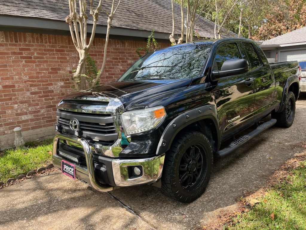

    So my Tundra has what appears to be these rims on my truck. I am guessing these are original equipment. https://www.tundras.com/threads/tundra234s-2020-barcelona-sr5-dc.107938/#post-2781079
    I am not use to such specifications as to what tires may be needed. I’m an old school boomer, so I’m a little confused. Specifically by the off set, 20x9, 50mm. 20=rim height, 9=width of rim and 50mm reference I think means how far past the wheel well the tire protrudes. Please correct me if not accurate.
    Currently the truck has a set of Nitro Ridge Grabber LT 285/55 R20. The tires seem ok but at some point I will need to think about replacing them.
    My question is when purchasing tires does the 50mm reference matter?
    Appreciate your time. Pictures attached too, just in case.

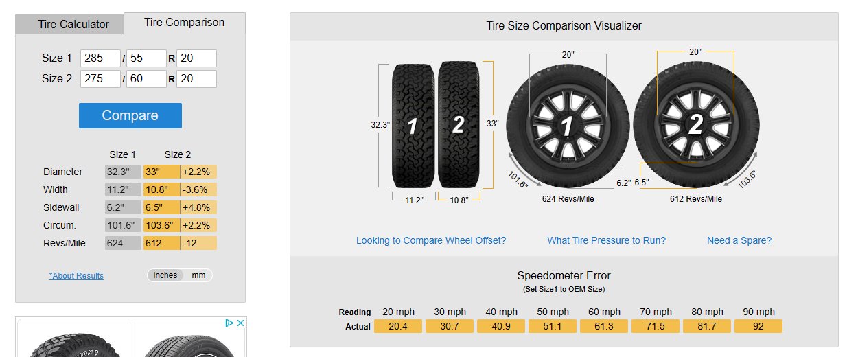

    On my 3rd Tundra 2005 DC 2014 DC 2026 CM Limited
    I like like this one.
    I think your TSS wheels are +55 offset.
    It should be stamped inside the wheel along with the 20X9 wheel size.
    It isn't that much of a factor in simply purchasing tires, more of an issue when purchasing wheels.
    My 2014 came stock with these wheels (still have them) and 285/55/20 BFG KOs.
    I now run a 275/60/20 tire that is a little taller and narrower.
    I like the size a lot more than the stock size, I feel it turns better with the narrower tire.
    I'm running Discount Tires Goodyear Wrangler UltraTerrain AT 275 /60 R20 115S SL SBL | Discount Tire
    In this size, it is an SL rated tire.
    Runs much smoother than the D rated KO2s I had, they also run quieter.
