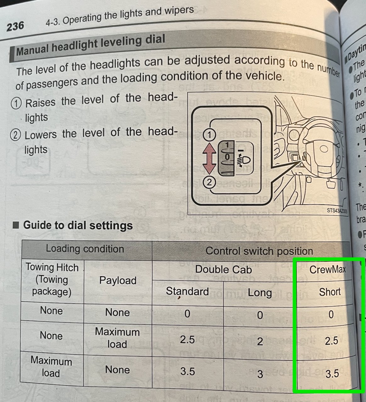

    I had this question yesterday, and the manual on this topic is a wee bit confusing.
    For the CrewMax, I think this table below means:
    • Set it to 0 if you have no passengers and no load
    • Set it between 2 and 5 if you have a load in the bed -- where 2.5 is not meant to mean "two and a half" but rather "two to five"
    • Set it between 3 and 5 if you are towing
    Am I misreading that?

    It is 2 and a half. The dial "clicks" so you can set it halfway between 2 and 3. The best way to set it is go to where it is really dark and you will see where your beam is as you turn it. If you are stock with no lift, no heavy loads or leveleling kit, 0 is a normal setting.

    Oh, I didn't realize there were half increments. Thanks. I guess 4/4.5/5 are reserved for those with monster lifts who are also towing.

    I got a blink yesterday with it on 3 (no lift, no-load, not towing, and one passenger) and why I looked it up... I guess I was wrong to assume that 3 was the baseline and 0 mean lower than baseline and 5 was higher than baseline.
