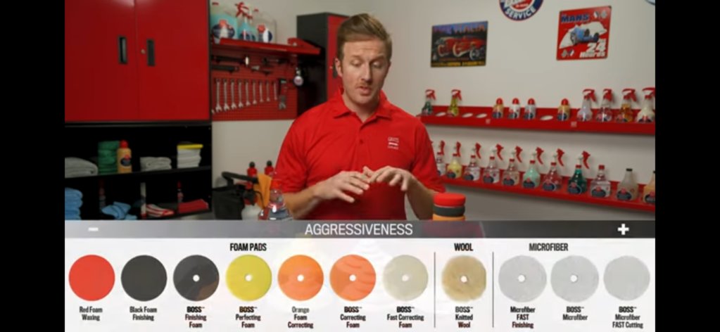

    Griots has some nice tutorials on YouTube and their website about pads. Simply put, the difference in the pads is the aggressiveness of correction.
    Orange or yellow are common for lighter correction and red and black for finishing. As mentioned, the BOSS pads are different than the non BOSS pads in that they are thinner.
    This screenshot has a nice graphic showing the scale of aggressiveness. And a thinner pad will be more aggressive than a thicker pad
