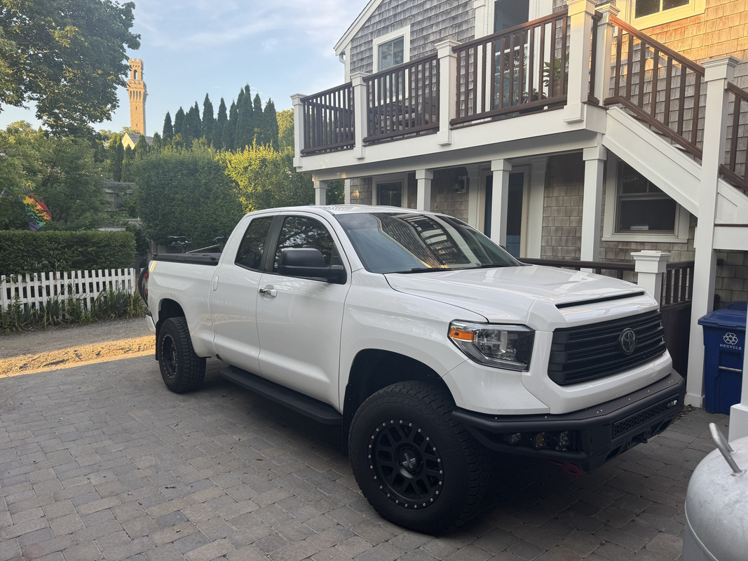

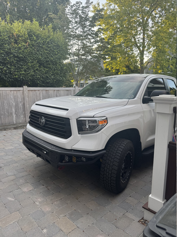

    This is a bumpershellz 040 grill surround and bulge on a painted limited grill.[​IMG] Color match is decent [​IMG]

    Nice! What bumper is that?

    Ironman 4x4
