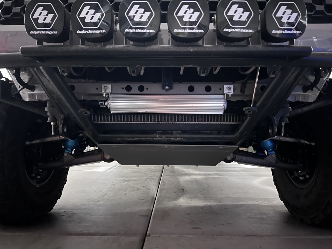

    I need to relocate my power steering cooler due to my winch and bumper. Anyone done this on a 2.5 gen?

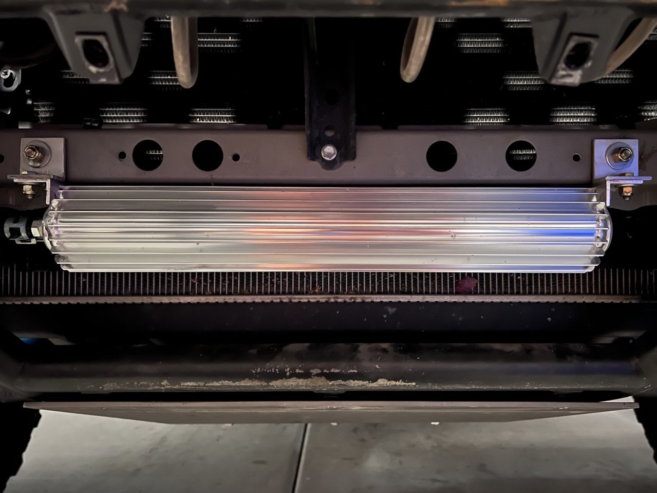

    Yes, relocated but also changed to a different cooler for more capacity and cooling. Very easy to relocate.D6DDF6AE-C1FA-482B-88A4-F0D373EEDEE9.jpg

    Which cooler is that?

    Was the oem just a stupid piece of tubing in a UBend like the 1st gens? 65F20F96-9F71-4302-8AE4-CA882D674C24.jpg
    I ended up reusing it and it’s mounts, welding them into the backside of the welded in cross member.
