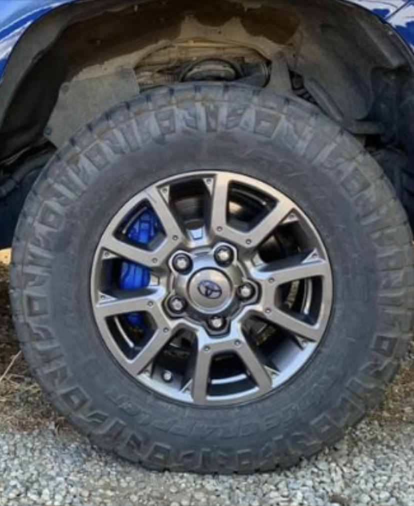

    Saw these that someone painted themselves.
    panicman likes this.
  5. Mar 1, 2021 at 6:22 PM
    BlueRibbon4x4
    BlueRibbon4x4 Let’s color match it
    Aug 16, 2018
    #18204
    3,016
    Geno
    2015 Blue Ribbon 4x4
    Those are mine!!:rofl:

    Duplicolor Graphite metallic with 2K clear. E9D20C63-6F37-4C52-B4CB-E103F0AA022A.jpg

    Hahaha, awesome. Saved that pic months ago cuz I wanted to do the same.

    How’d you sand them btw?

    Just used 220 to scuff them up really well. Then used self etching primer for good adhesion.

    How long ago did you paint them and how are they holding up?

    They’re holding up great. I off-road often with them. It’s the 2K clear. It’s tough stuff. I painted them last year in July.
