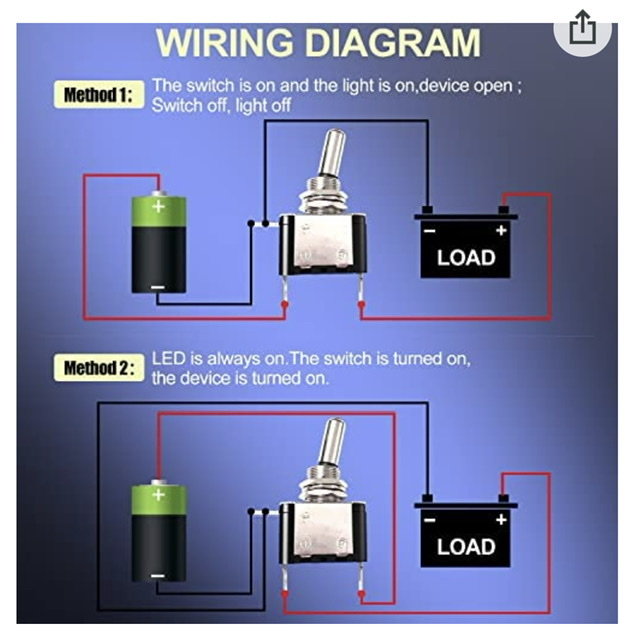

    Building a box for my cap- going to run wire from battery +/- to rear of bed.
    That wire will go into a box where I have mounted
    But I don’t want it to be a constant hot so I bought some rocker switches E07AAD11-1333-4943-9DAB-92B240E6CBDD.jpg
    I’d like to use this switch to kill all power to the switch panel.
    The panel has bare positive posts to wire lights to the switches and I have a negative bus bar as well.628DC320-8B4E-49B5-A1EB-721FAF91104A.jpg
    Couple of other pics C5A64CFA-8D82-4A2D-8E61-BCA550C9BF8C.jpg8966AA3F-36A2-414F-ADDB-41A2B218C401.jpg
    It seems straight forward but do I tie the neg from battery to bus bar and the neg from toggle and lights all into same bus bar as a common ground?
    thanks!

    I have not - I currently have a few led lights back there now. Just looking to clean it up. If the volt meter was always drawing power/ hot I wouldn’t be messing with a master switch.
    so my game plan is from battery have a 15a fuse - then wire run to box. In box have pos to master switch - from there I’m kinda lost.
    Each led light has its own fuse. My cap is set up as a camper. Wanted cig power for awning light plug in erc. Everything is pretty low power
