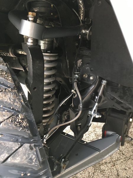

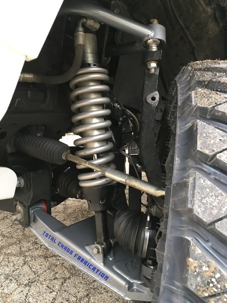

    I only wish the front could keep up. On that note, I guess I'll let everyone know what my near-future plans are as far as suspension goes..
    I plan on combining the 7" BDS drop-bracket lift with a Camburg long-travel kit. There are several gains to be had from that, other than the obvious travel numbers, such as moving the wheel hub forward an inch, increasing the track width ~4.5" for a lower CoG, and removing the need for wheel spacers up front, which would help minimuze wheel arc radius when turning. It's going to a step-by-step upgrade..
    Step 1 is Camburg UCA, LCA, axles, plus other hardware. I'll use my existing mid-travel coilovers with a top spacer; the only downside is not maximizing the LT kit's travel numbers it could provide.
    Step 2 could go either way between getting custom dual-rate long-travel coilovers (I'm thinking 500lb top spring and 700lb bottom) to match the bracket lift ..or, if the MT coilovers are performing decent (travel can't get any worse than what I have now -- only better), the coilover upgrade can wait a bit and the cash could be spent on Camburg's rear components (shock relocation, bolt-on air bumps ..or a secondary shock up front.
